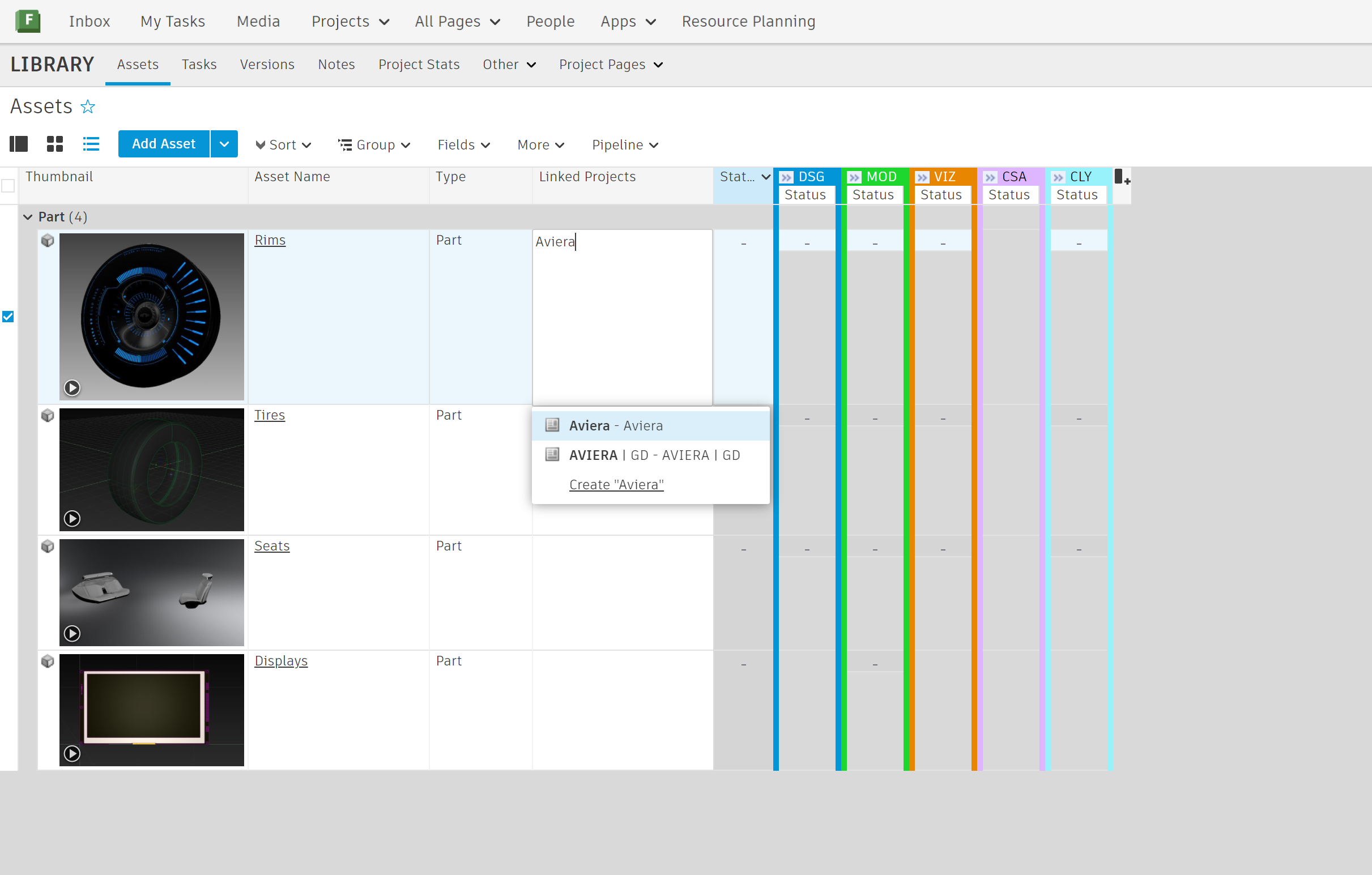

From the source Project that has the original Asset you're re-using, navigate to the Assets page. Add the Linked Projects field to the Assets Page (if it's not already visible). Then, specify Project you want to re-use the Asset in.
Tip:
See the detailed documentation here.
Library Project Linked Projects Field

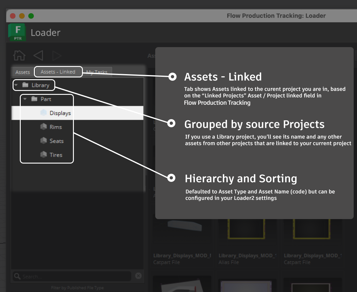

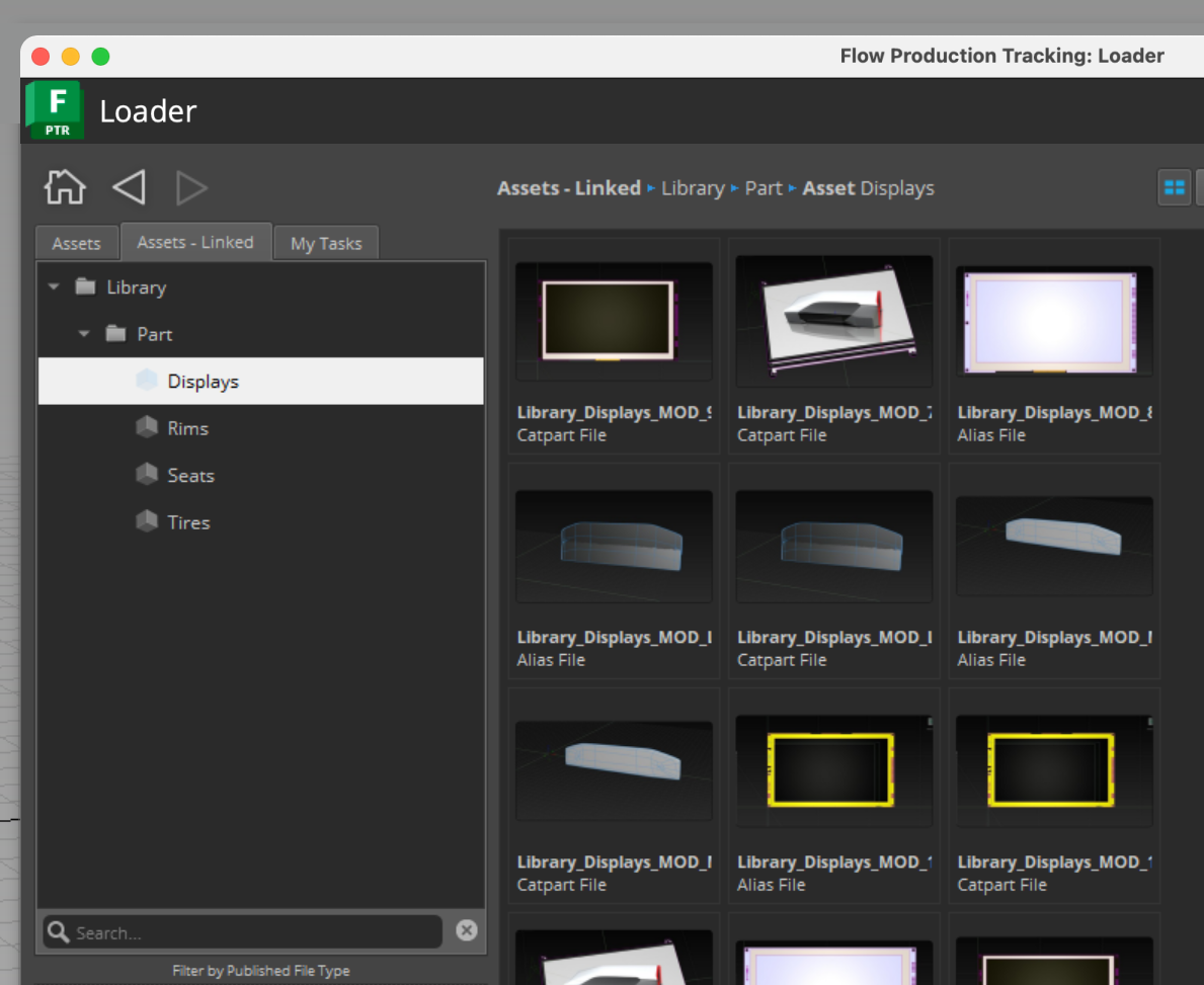

  • Now, you will see the tab Assets - Linked which allows you to access Published Files for Assets across Projects.
Tip:
See the detailed instructions to add to this Tab to the Loader in your config here.
Loader Tab for Assets - Linked
Loader Tab for Assets - Linked Description

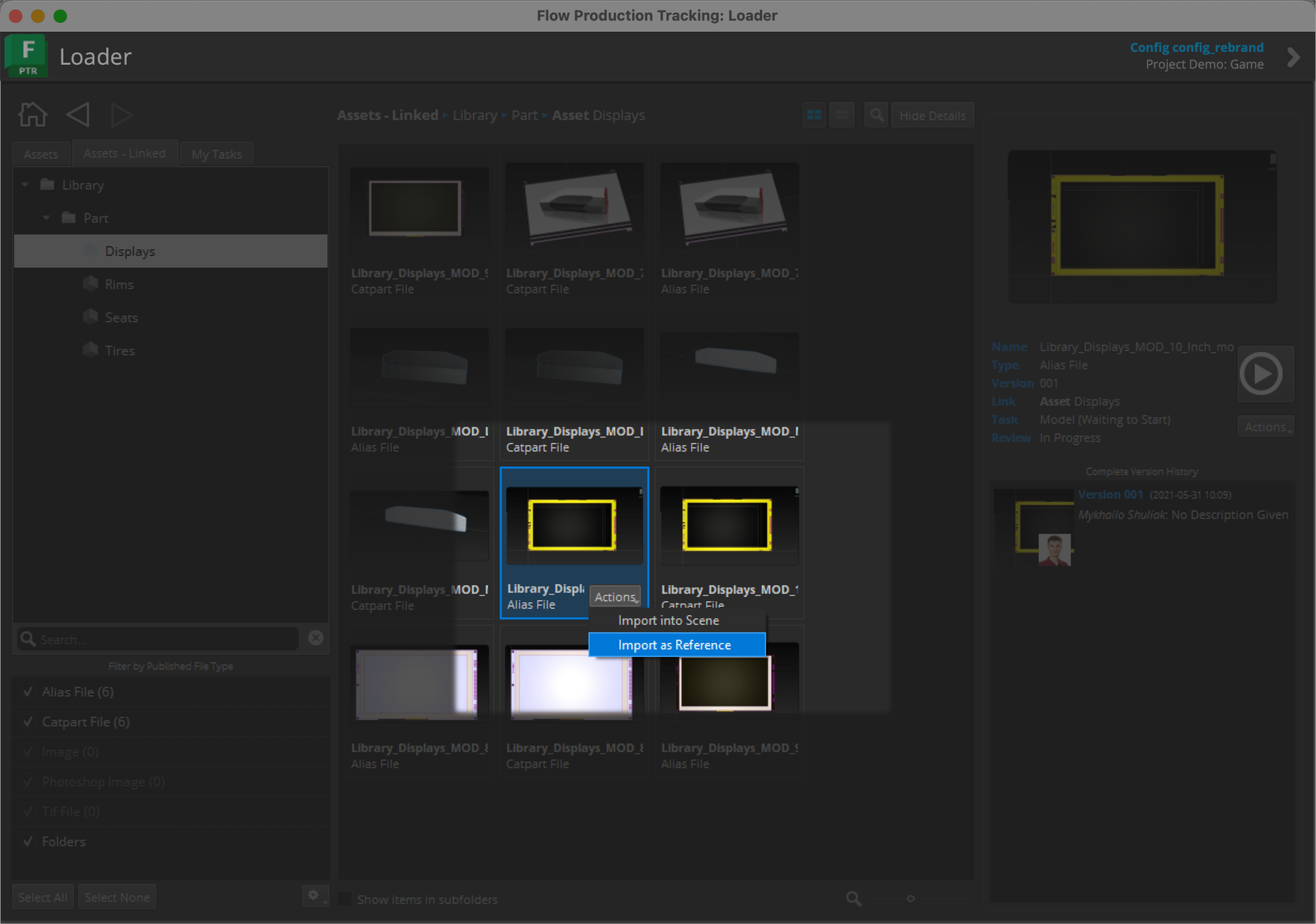

From here, you can take advantage of your content creation software Loader actions to do things like Import—if you plan to duplicate or fork your asset breaking any connections to its source—or Reference the Asset for an ongoing connection to the current Version and all subsequent Versions of this Asset.
Loader Actions

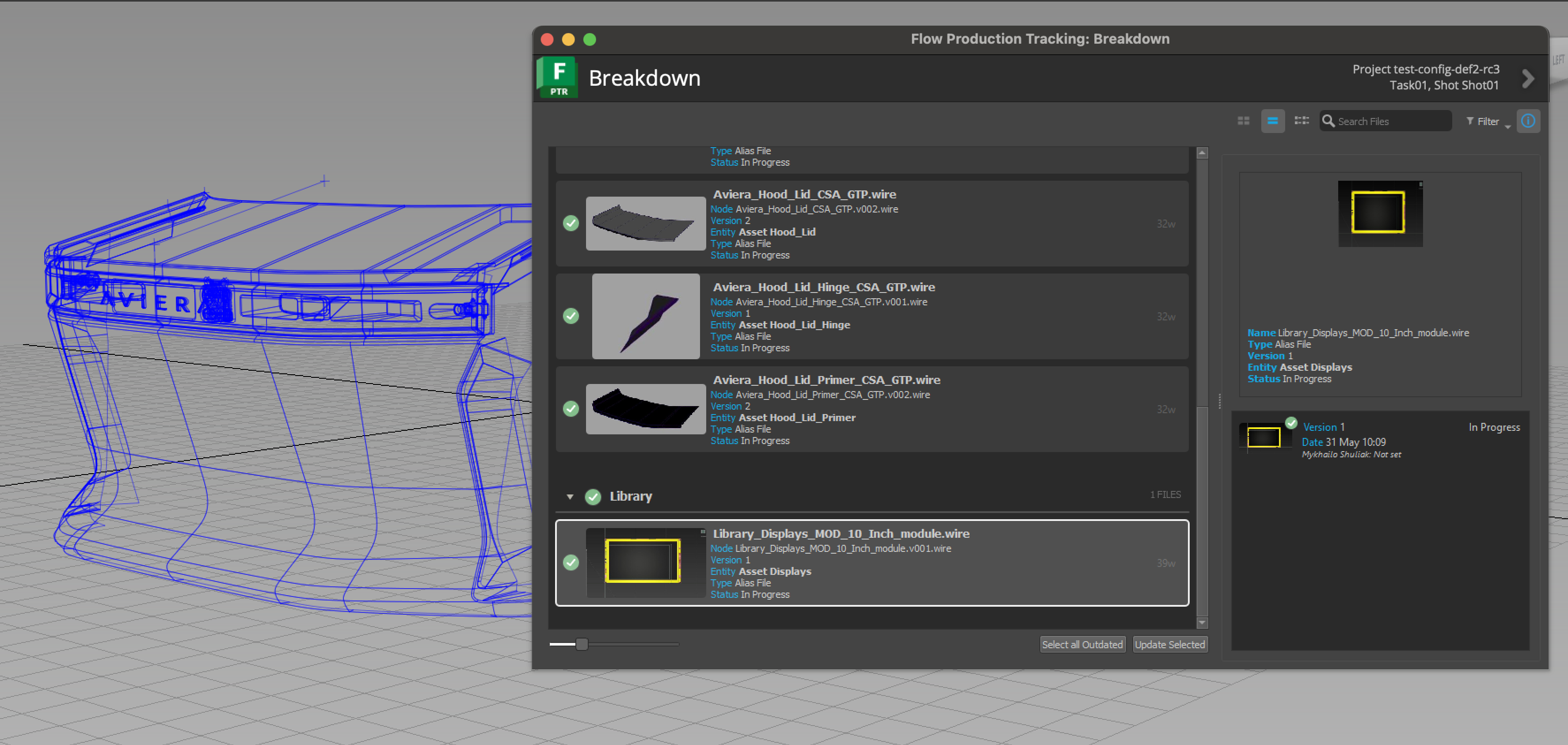

Using the Scene Breakdown 2 App in your config will enable you to see all the referenced items currently in your Scene. When any of these references get updated, the Scene Breakdown will show you the conflicts, share the Published File notes about what changed, and allow you to update to the latest Version or any other Version of the Published File.
Scene Breakdown 2
