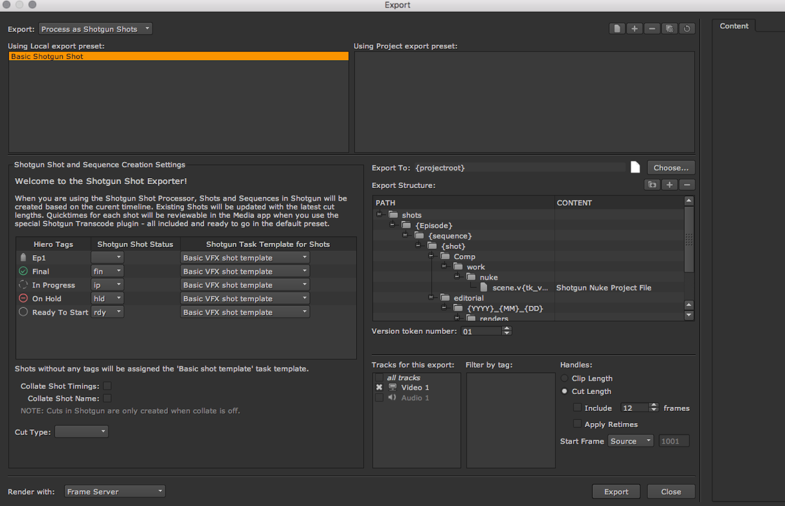

In order to get the Flow Production Tracking Export process to handle our Episode correctly, you will need to modify some of the export hooks. In this article we’ll assume you know what hooks are, and are comfortable with overriding the base implementations.
There are two export hooks that will help you enable episodes.

1 - Add Episode Field
You now have a new key in your templates called Episode , and you need to tell the tk-hiero-export app how to resolve this. Modify the custom_template_fields in the <pipeline_configuration>/config/env/includes/settings/tk-hiero-export.yml file, so that it looks like this:
 settings.tk-hiero-export:
    custom_template_fields: [{keyword: Episode, description: The episode name}]
This adds a valid export token named {Episode} to the Hiero exporter.

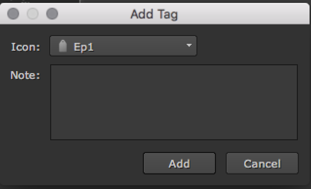

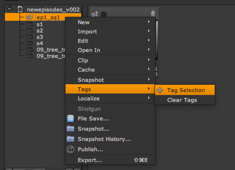

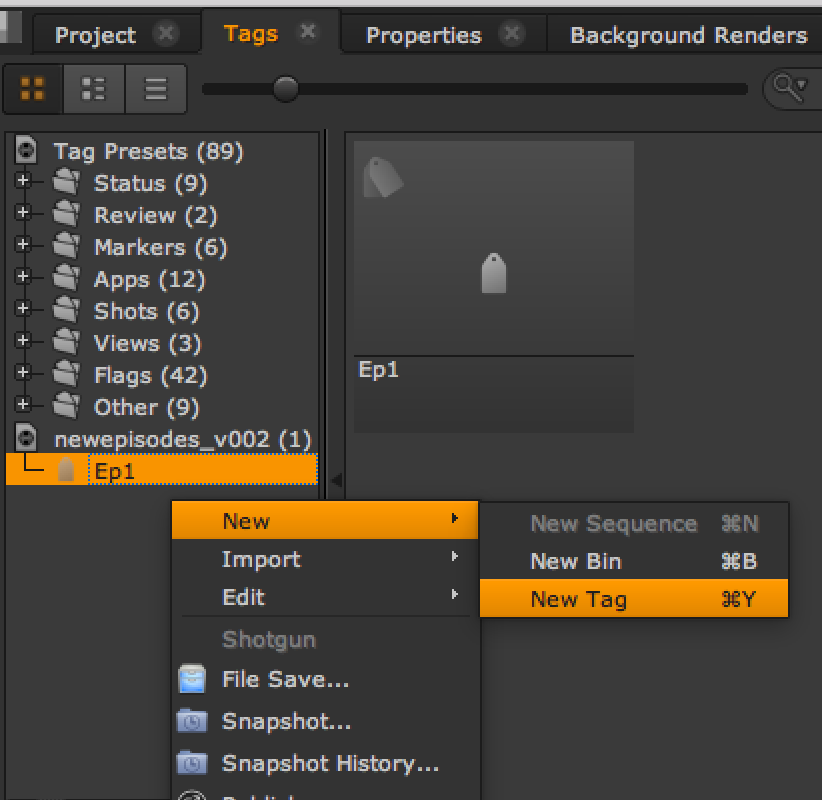

In this guide you are assigning the episode in Nuke Studio by using Tags. For example, you could create a Tag in Nuke Studio named "Ep01". Then you would apply that Tag to the sequence in Nuke Studio.
At a high level the get_episode() method looks at all of the Tags applied to the sequence item in Nuke Studio, and if it encounters one that starts with the string "Ep", it assumes that is the tag defining the Episode name. The method then finds and returns the matching Episode from Flow Production Tracking and creates it if it doesn't yet exist. It also caches this information so it doesn’t have to perform the costly find call again.

Create the Episode tag
Now add the Tag to the Sequence.
Add the Tag to the Sequence

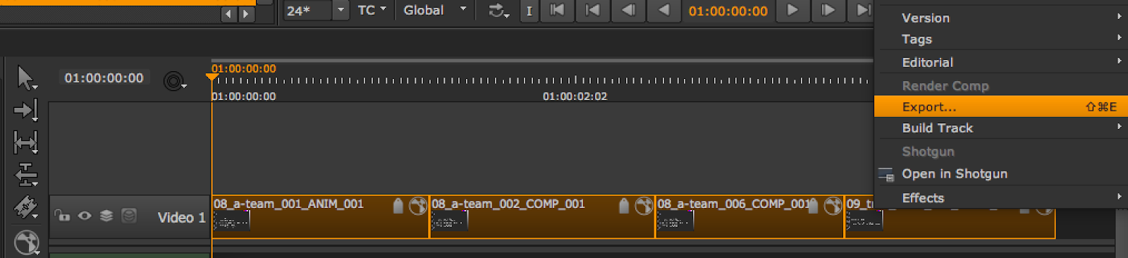

Once that is done, export the Shots from your tagged Sequence.
Export Shots
Check that the Export Structure hierarchy matches that of our schema.
Note:
If it does not match, you may need to refresh the structure. If you’ve opened your Hiero/Nuke Studio project before making these changes, or you’re testing while making the changes, then it’s possible you will need to reset the export path. Nuke Studio caches the export tree when you open the export dialog, so you will need to rebuild it by pressing the refresh button when you want your changes to the schema to be reloaded.
Once you click export, it should then create your Episodes, Sequences, and Shots in your Flow Production Tracking site, as well as the folder structure on disk. If you run into issues along the way, remember to check the Nuke Studio script editor or Flow Production Tracking logs (tk-nukestudio.log) for any errors that you might encounter.
