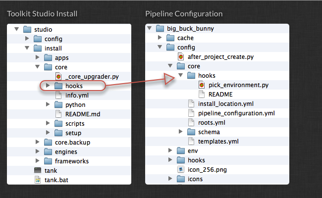

When customizing an app hook, you typically copy the default hook from inside the hooks folder in the app into your project's hooks folder. Next, you need to update the app settings inside the environment file so that it will read your new hook and not the default one. Your custom hook will automatically inherit from the default hook provided by the app, making it easy to add tweaks and small adjustments yet keep most of the business logic in the default hook. For more information about hook inheritance, please see the environment configuration reference.
Core level hooks
Core hooks makes it possible to override system wide behaviour in toolkit. Core level hooks are all overridden per project, so each project needs to set up individually with overrides. (If you keep re-using the same configuration when you set up new projects, this is generally straight forward).
The Core configuration area contains a special hooks folder. This folder is where you can put your own implementations of certain core hooks. Core hooks are similar to the hooks that you find in apps - it is a way to extract a code snippet from the Toolkit and be able to customize it. The core API allows you to override a number of different core behaviours, including file system I/O, folder creation and validation of file system structure.
By default, the Toolkit will pick up the core hooks it needs from with the API folder itself. If you want to customize the behaviour, take the hook file and copy it into the config/core/hooks area in your configuration. Then modify the code.
For a list of what core hooks are available, have a look at the hooks folder inside the Core API. Each hook contains extensive documentation about what it does and how it can be modified.

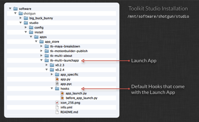

We can see that there are two hooks here, hook_app_launch and hook_before_app_launch, both using the default app implementation. These hooks have been created to allow studios to customize the launch process, set environment variables etc.
In order to customize these hooks, first you need to find their original implementation. Each App has a hooks folder in which any hooks will be registered. Now grab the hook you wish to customize and copy the hook into the hooks folder in your configuration. Make the necessary code changes.
Now the environment configuration still has the hook set to default and as long as it has that, it will pick up the default hook that comes with the app and nothing else. In order to pick up your new settings, change default to the name of the python hook file you have inside the configuration hooks folder.
Example: How to customize a hook
Here's a quick rundown of how to customize the hook_before_app_launch hook for an app launcher.
Copy the default hook implementation. See the image above for the location of the default hook that comes with the app. Now copy this file into your configuration area, in the hooks folder. For example, if your Pipeline Configuration is located in
/mnt/software/sgtk/big_buck_bunny, you want to copy the file to/mnt/software/sgtk/big_buck_bunny/config/hooks/before_app_launch.pyMake the necessary changes to the python code.
Finally, update the environment configuration to use your new code:
yaml launch_maya: engine: tk-maya extra: {} hook_app_launch: default hook_before_app_launch: before_app_launch # <-- uses custom hook! linux_args: '' linux_path: '@maya_linux' location: {name: tk-multi-launchapp, type: app_store, version: v0.2.4} mac_args: '' mac_path: '@maya_mac' menu_name: Launch Maya windows_args: '' windows_path: '@maya_windows'
The next time you run the launch app, your code will be executed instead of the default hook code.
