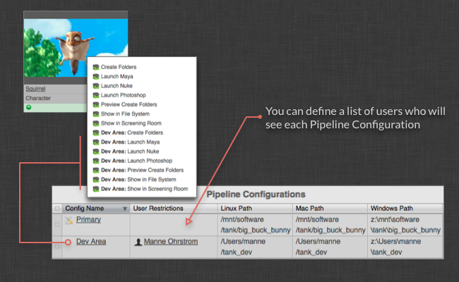

In Flow Production Tracking, each project has a number of Pipeline Configurations. When a project is first set up with Toolkit, a Pipeline Configuration called primary is created. The pipeline configuration entity in Flow Production Tracking points at a location on disk where the Toolkit configuration can be found.
During the course of a project, you often need to make changes to the configuration. This can be tweaks to the configuration, or perhaps you need to add additional apps or engines. We also release new app versions frequently and we recommend that you use the latest versions if possible.
While it is possible to upgrade your primary project configuration straight away, this can be risky; since this configuration is used by everybody on the project, introducing a problem will affect everyone. A better approach is to create an isolated version of the configuration that a select group of people have access to. In this safe environment, upgrades, configuration changes and development can happen without impacting the rest of the production. Once the changes have been tested, they can be safely and confidently pushed to the primary configuration.
This process is called cloning and means that you make a personal copy of the primary configuration that only you (and other people you invite) have access to the clone. In here you can make changes safely and once you are happy you can push these changes back to the primary configuration.

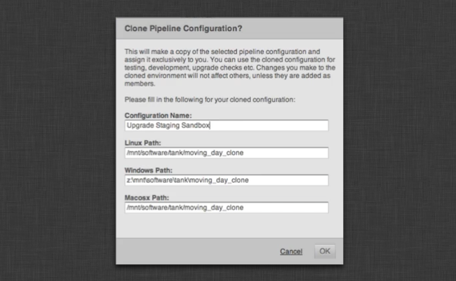

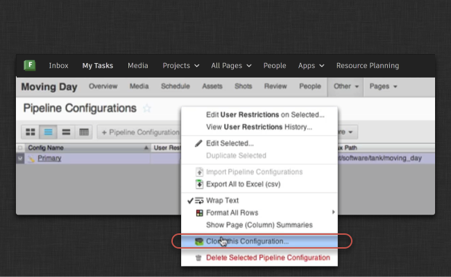

In order to create a staging sandbox where you can safely test your upgrades, navigate to the pipeline configurations for your project in Flow Production Tracking and right click on the Primary configuration. An option to clone your configuration will appear:
Once you click it, you'll be presented with a dialog where you specify the path on disk where you want this new configuration to be located. If you are running a multi OS setup, make sure to put in paths for all relevant platforms.
When you press ok, Toolkit will copy the configuration across and set up the clone. It will also associate your Flow Production Tracking user with this configuration, so as soon as you have created your clone, you will see new menu items appearing inside Flow Production Tracking.

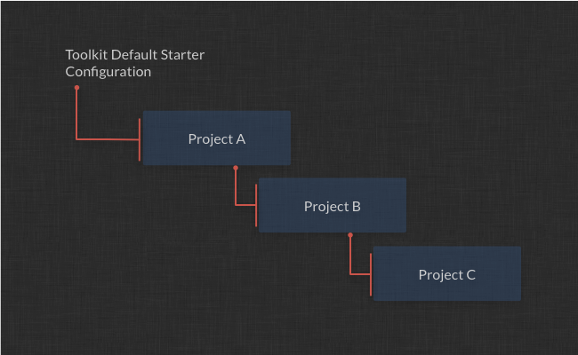

Inheriting the config from your previous project
This is the simplest approach to configuration management. For the very first time you set up a project with Toolkit, you download our default configuration. You then set up that first project to match your pipeline settings, filesystem locations, etc. When the project is running, you run commands such as tank updates to update the app versions you are running.
When your second project comes around, you don't want to start with the default config again - instead, during the project setup phase, pick the config from your first project as the starter for your new project. This means that all the changes, tweaks and improvements you did for the first project will be taken advantage of in the second project as well. For the third project, use the second project's config etc.
This is a very simple way to gradually evolve the configuration over time. Changes and improvements will flow from project to project in an ad hoc fashion. The first time you run the setup_project command, just hit enter when the setup process prompts for the configuration to use. This will download and install the default configuration.
For your second project, you will be presented with a list of paths to configurations for previous projects. Choose one of these paths and enter that when the setup process prompts for a config. This will copy that configuration to the new project:

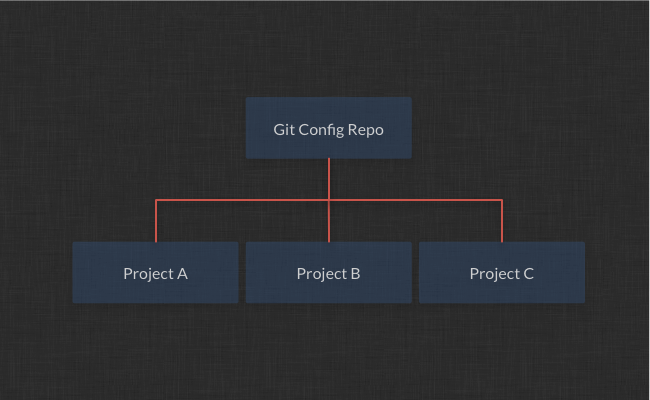

A studio configuration in git source control
Limitations with the first approach include the fact that the projects are not connected to each other. If you have 10 projects and you all need to update them because a critical bug fix has been released, you would have to manually go through each project and run the tank updates command.
One way to resolve this is to create a master configuration and store it in git source control. Whenever you create a new project, simply type in the path to this git repository in the setup project dialog and Toolkit will clone it for you. Now all the projects are connected to the same "studio master" config. If you have made some good changes to a project configuration, you can commit them and push them to the studio master. Other projects can then easily pull these down. You also retain a history of all your changes via git.
What is Git?
The basic idea is that you set up a git repository which holds the git configuration. Whenever you run tank setup_project, you specify the git url to this repository (for example username@someserver.com:/studio_config.git) and the setup process will clone the repository so that the new project becomes a repository connected to the main studio repository. Once they are connected you can push and pull changes, and work in branches for finer granularity.

Advanced git usage: Batch deployment
Since Toolkit keeps a list of all the different configurations for a Flow Production Tracking site via its pipeline configuration entity, it is possible to iterate over this list and execute a git pull command for each of the items, effectively running a batch update on all projects. This functionality is not currently part of Toolkit out of the box, but can be scripted using Python and the Flow Production Tracking Python API.
A global configuration using includes
The git based approach above handles independent project configurations which are connected via git: Updates are not automatically reflected across projects but will have to be pulled and pushed.
For a fully centralized configuration, where the configuration truly resides in one place and where a single change immediately reflects a group of projects, you will need to make use of the @include functionality in the Toolkit configuration. This makes it possible to create references so that each project configuration points at a central location where the actual configuration is being kept.

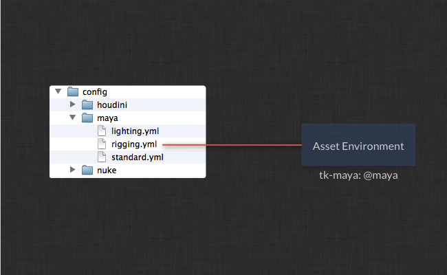

In your studio, you most likely don't have a single maya setup, but may have a number of different ones for different departments and types of things. We recommend that you set up a maya include file for each of these ones, organized in a file hierarchy. Each of these files has a top level maya entry just like the file above.
Now each project will contain a number of environments. Each of these environment files will be a list of engine includes, linking that specific environment to a collection of engine and app setups. You can set up one (or several) default project configurations for your studio, all containing includes like this, thereby ensuring that the actual app and engine payload is completely contained within the include files and therefore global. If you make a change to your global include files, all projects will be affected. With this setup, your environment files will then be on the following form:
includes:
    - '/studio/configurations/maya/asset.yml'
    - '/studio/configurations/nuke/asset.yml'
    - '/studio/configurations/houdini/generic.yml'
engines:
  tk-maya: '@maya'
  tk-nuke: '@nuke'
  tk-houdini: '@houdini'
# we don't need any frameworks here because there are no apps or engines defined
frameworks: null
