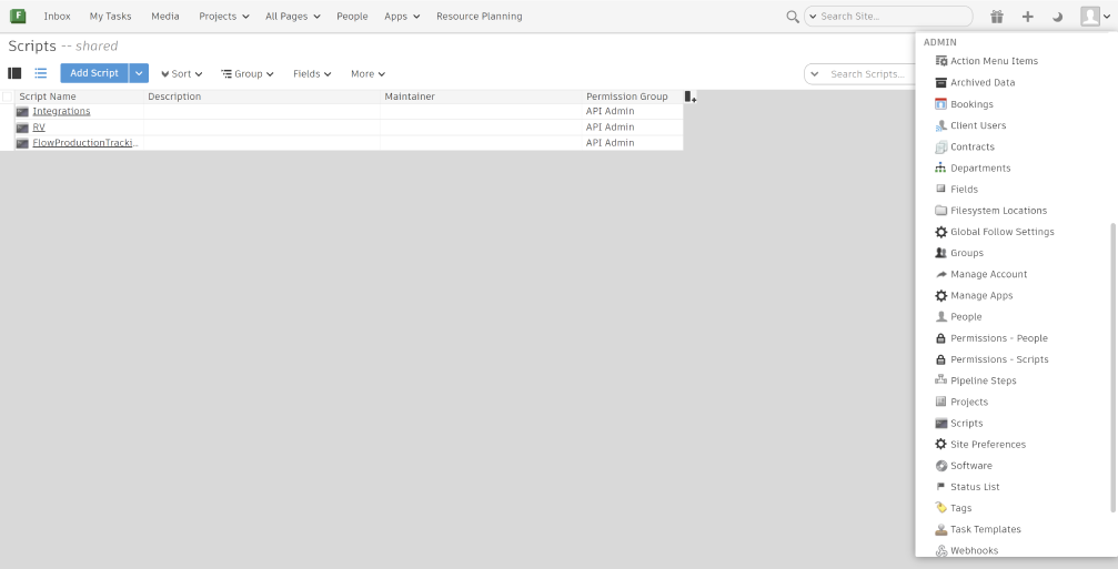

  1. Go to the Admin Menu and select “Scripts”.
    Script

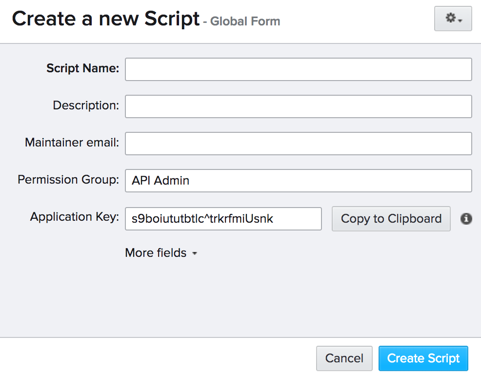

  2. Create a new Script using the “+ Script” button.
  3. Grab the value from the Application Key. You’ll need this to initiate a connection to Flow Production Tracking.
    Application key
    Note:
    API keys are treated like passwords, and once created cannot be viewed again via the Flow Production Tracking web app or API. Make sure you copy the key before proceeding.
