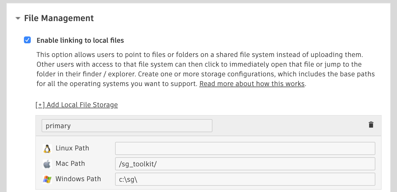

  • In Flow Production Tracking, navigate to the Admin > Site Preferences page and open the File Management section. Flow Production Tracking storage roots section in the site preferences.
  • Update the Local File Storage named "primary" with the paths for each platform to the new storage for your project files. If you're not using a specific platform, leave it blank.
  • Click on the "Save Changes" button on the top or bottom of the page.
  • Update your config/core/roots.yml file in your project configuration to match the new path values you just saved in Flow Production Tracking.
