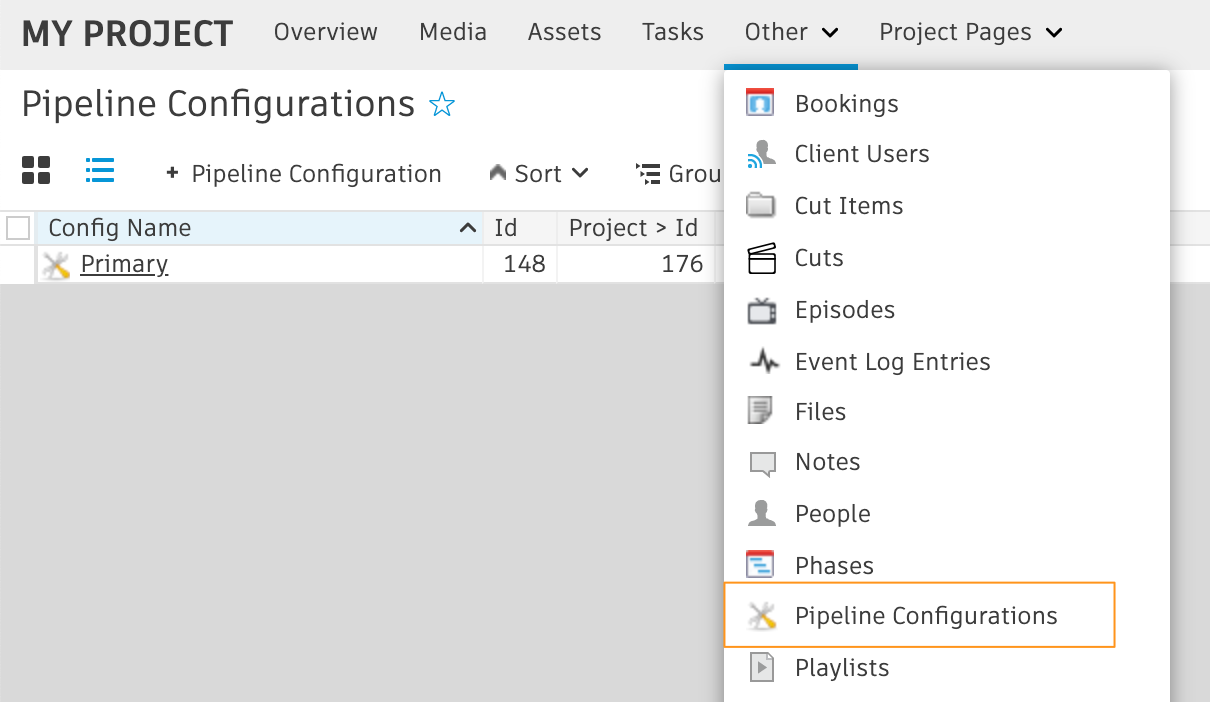

- Delete any
PipelineConfigurationentities linked to your Project in Flow Production Tracking.

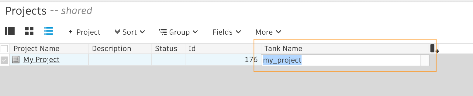

- Set the
Tank Namefield on yourProjectentity in Flow Production Tracking to a blank value.
