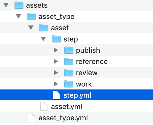

Example
Take the default schema structure below; Asset and Step folders will be registered during the folder creation process:
Default Asset schema
If you generated a file path using a template like this:
assets/{sg_asset_type}/{Asset}/{Step}/work/maya/{task_name}_{name}.v{version}.{maya_extension}`
And then attempted to figure out the context from that generated path, it would only be able to establish the Asset and the Step and not the Task despite the task's name being in the file path.
