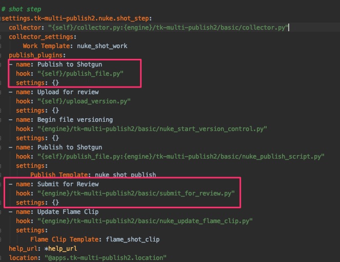

In the above screenshot, under the ShorgunWrite1 item you see two plugins. These correspond to plugins that were defined in the config.
config
These plugins are run in order and act on the same item in memory. To get to the bottom of your problem you want to look at the code for these two plugins. You can figure out where those live by looking at the hook settings.

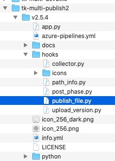

For the first plugin since we are looking at the settings for tk-multi-publish2, {self} refers to tk-multi-publish2. Therefore
{self}/publish_file.py
can be found under the tk-multi-publish2 app folder:
publish_file_hook
Where the app exists on your file system depends on how app_locations.yml is configured, but if you haven't changed anything there, you can find the app in your bundle cache folder. Here's how to find your cache location if you need it.

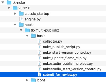

For the second plugin, the hook path is
{engine}/tk-multi-publish2/basic/submit_for_review.py
We are running the tk-nuke engine when in Nuke, so to find this publish hook we need to look under tk-nuke which again should be in your bundle cache.

In the python files you'll see that all the hooks inherit from HookBaseClass. But the hook mechanism in the config allows you to essentially treat these base hooks as mixins and combine them to get all the functionality you need while reusing code. You can see an example of this in the tk-multi-publish2 config:
settings.tk-multi-publish2.nuke.shot_step:
  collector: "{self}/collector.py:{engine}/tk-multi-publish2/basic/collector.py"
The collector defined here does not exist in any python file. It is actually a combination of the tk-multi-publish2's collector.py and tk-nuke's collector.py.
