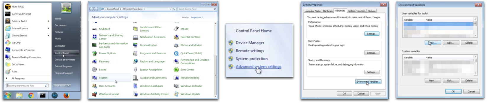

Example using Windows 7
- You can permanently turn on debug logging by navigating to the Windows icon > Control Panel > System > Advanced system settings > Environment Variables… > New…
- Variable name:
TK_DEBUG
- Variable value:
1
- Select OK
Now, your environment variable is set up properly and debug logging is turned on.
