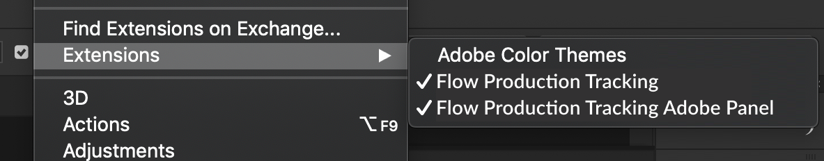

With the release of our After Effects integration, there is a common plugin that can be used by all Adobe apps that integrate with Flow Production Tracking. As part of this change, we needed to rename the extension so that we could preserve backward compatibility with our older Photoshop integration and make it possible for studios to cleanly transition to the update.
Unfortunately, this also means that it is possible to have two Flow Production Tracking extensions installed as you upgrade:
Multiple extensions showing in the Photoshop menu
The Flow Production Tracking Adobe Panel is the new one, and should be used when you are using v1.7.0 of the Photoshop integration or newer.

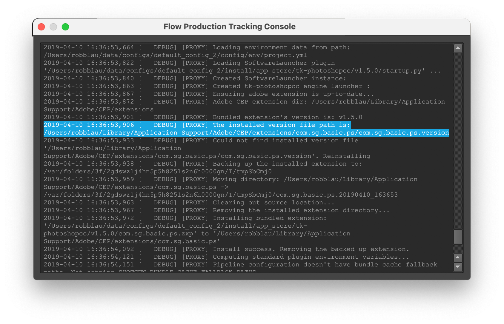

To get rid of the older extension, you can remove it from the Adobe install location in your home directory. The folder for this can be seen in the debug output upon Photoshop launch, and is
  • OSX: ~/Library/Application Support/Adobe/CEP/extensions/com.sg.basic.ps
  • Windows: %AppData%\Adobe\CEP\extensions\com.sg.basic.ps
If you quit Photoshop and remove that directory, then you should have just the one extension on relaunch.
