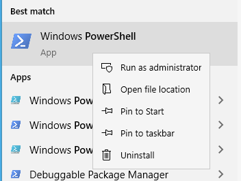

For users of Powershell on Windows 10 or Powershell 3 on Windows 7, you can run the following script as an administrator on the computer to get the new certificate.
Powershell
$cert_url = "https://www.amazontrust.com/repository/AmazonRootCA1.cer"
$cert_file = New-TemporaryFile
Invoke-WebRequest -Uri $cert_url -UseBasicParsing -OutFile $cert_file.FullName
Import-Certificate -FilePath $cert_file.FullName -CertStoreLocation Cert:\LocalMachine\Root
If the command worked, you should see this:
   PSParentPath: Microsoft.PowerShell.Security\Certificate::LocalMachine\Root
Thumbprint                                Subject
8DA7F965EC5EFC37910F1C6E59FDC1CC6A6EDE16  CN=Amazon Root CA 1, O=Amazon, C=US
This will make the certificate available for all user accounts on the computer it is run on. If you don't have admin access, you can change the last line with:
Import-Certificate -FilePath $cert_file.FullName -CertStoreLocation Cert:\CurrentUser\Root
and the certificate will be added for the current user only.

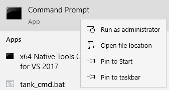

Then launch the command prompt in administrative mode:
Administrative Mode
and execute the following line:
certutil -addstore root <path-to-the-cert>
This will make the certificate available for all user accounts. If you don't have admin access, you can add -user to install the certificate for the current user only like this
certutil -user -addstore root <path-to-the-cert>
