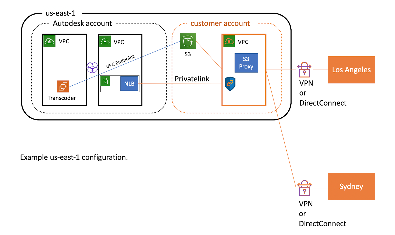

Review of Shogun Configuration in AWS
high-level-architecture
