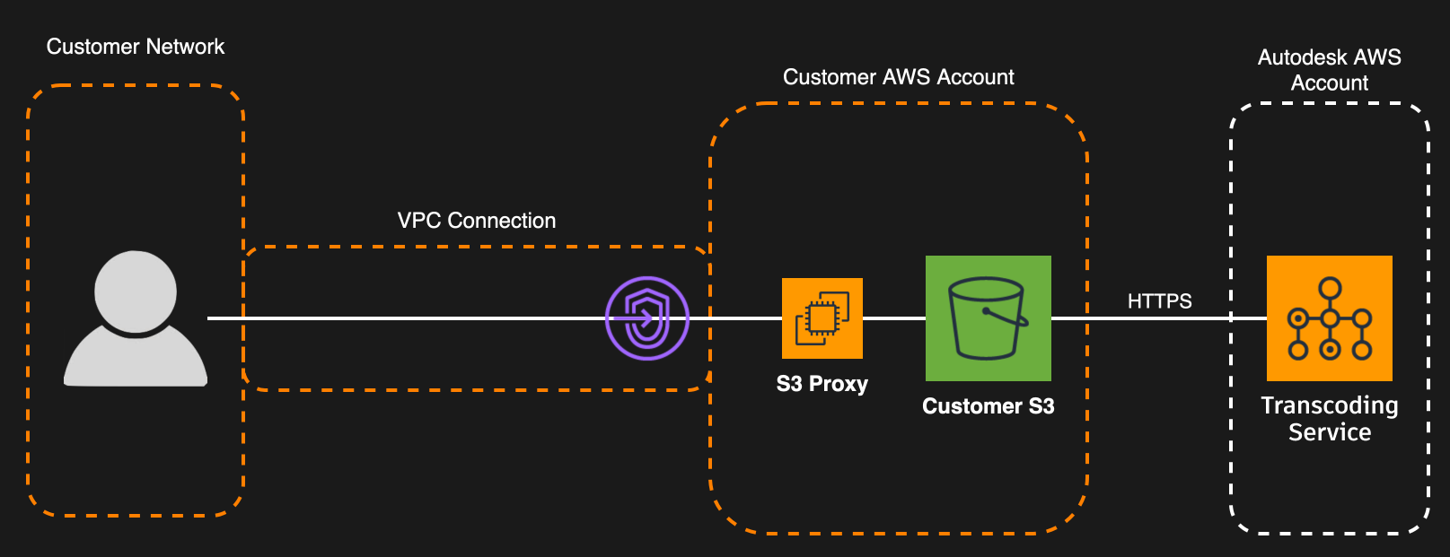

Media traffic isolation feature can be enabled to prevent your media traffic from being routed on the public internet, limiting it to the AWS backbone and your studio network. The traffic between Flow Production Tracking Services and your studio stays in closed network, never going outside AWS or your Studio network.
With the Media Traffic Isolation feature activated, the media will only leave your studio infrastructure once to get transcoded.

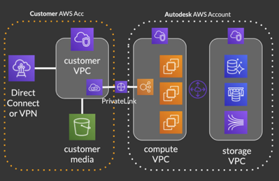

The Flow Production Tracking cloud service can be decoupled at a high level in 3 parts:
Compute Stack: The part of the Flow Production Tracking Service that handles client requests and serves data to the client.
Data Stack: Metadata storage (databases).
Media Storage: Where the client's attachments, media, and assets are stored. Flow Production Tracking uses AWS S3 to store client content.
Please read Securing Studio IP in AWS: Cloud-based VFX Project Management with Autodesk Flow Production Tracking for more details about the architecture.

Everytime media is uploaded to Flow Production Tracking, the transcoding service is invoked to create a web friendly versions of your assets. That process happens only once, after the initial upload. The media is directly uploaded from the client to S3, from where it is fetched by the Flow Production Tracking Transcoding Service. Each transcoding job is handled by a single container, which is killed after that unique job. The only place the media temporarily lives is in the container memory. The Flow Production Tracking Transcoding service doesn't store permanently a copy of your media.
