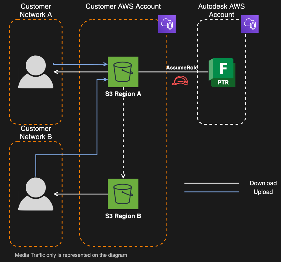

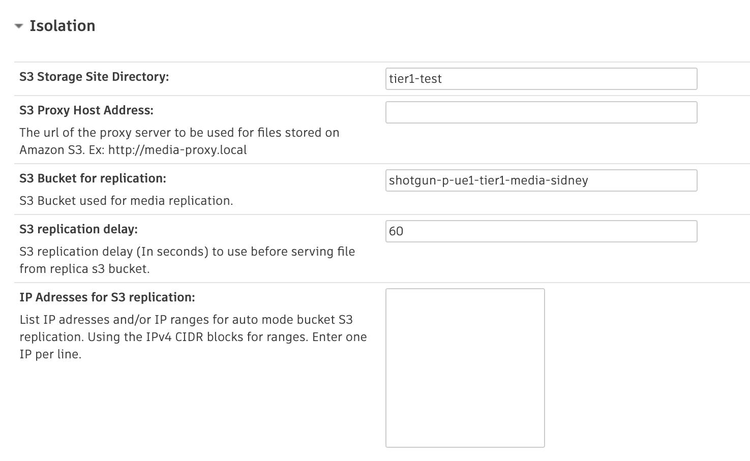

When using Media Replication, each user can customize which region data is read from. A user can either specify the region to use, or use automatic mode. In automatic mode Flow Production Tracking selects the replica determined by the user's IP address using IP ranges specified in the Isolation Preferences.
How it works

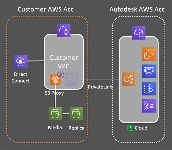

Flow Production Tracking can be configured to read from up to two different buckets. Using the AWS S3 Replication feature, you can configure replication between buckets in different regions, and then consume media from the region closest to your users. It is important to underline that media is always uploaded to the main bucket.
Following AWS service level agreement, S3 guarantees the replication of 99.99% of the object within 15 minutes.
Replication Delay
A small amount of time, typically under 15 minutes, is required before replication happens. The replication time depends on the size of the object to replicate. In order to alleviate that replication delay, Flow Production Tracking will, for a small period of time, generate links from to object in the source bucket instead of the replica. The duration of this transitional state is configurable in the Isolation Preferences.
