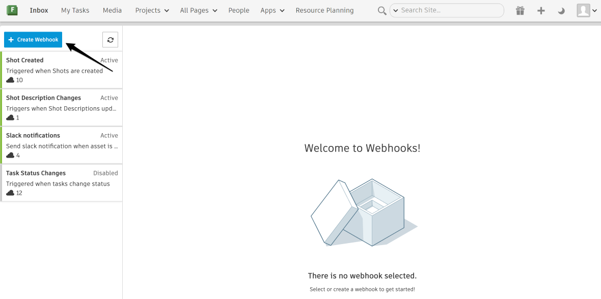

Creating a webhook from the Webhooks Page
To get started creating a webhook, go to the Webhooks page.
Then, select Create Webhook.
Access to webhooks is controlled by Show Webhooks under Advanced Permissions. It is enabled by default for Admin and Manager permission roles.

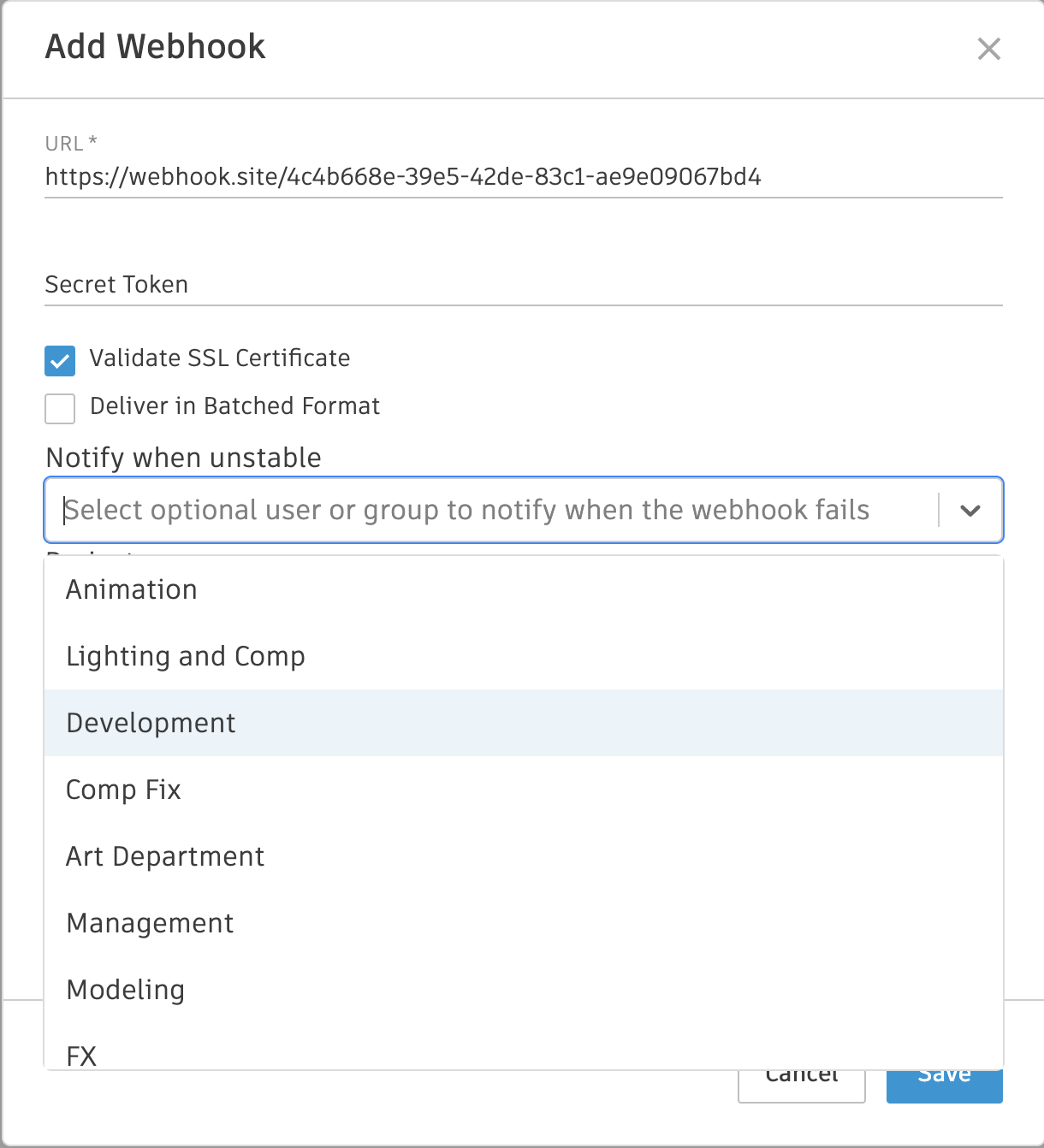

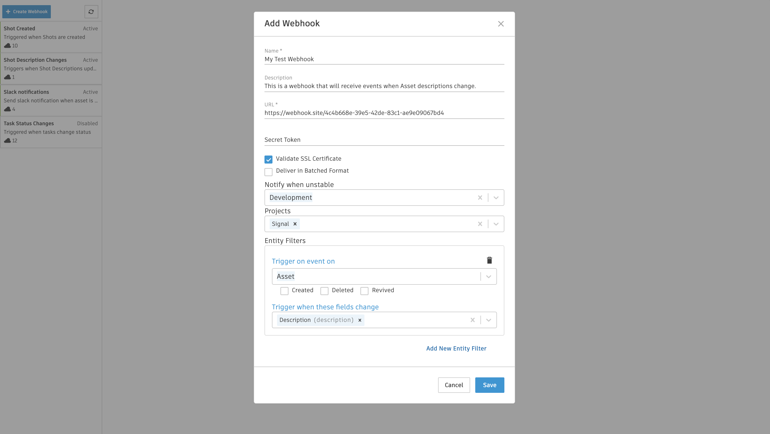

Next, fill out the information required to create your new webhook.

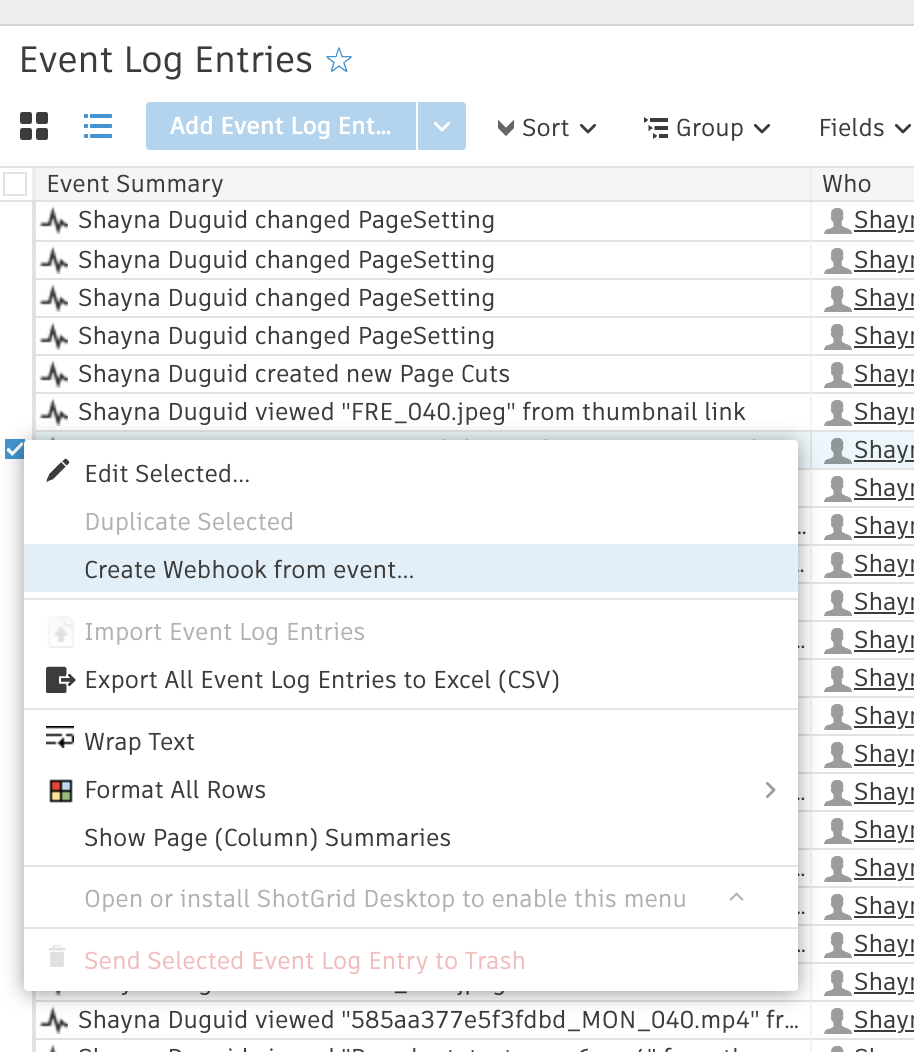

Creating a webhook from an Event Log
While on an Event Log Entries Page, right-click on an Event Log Entry record and select Create Webhook from event.
This will open up and pre-populate the Webhook creation form.

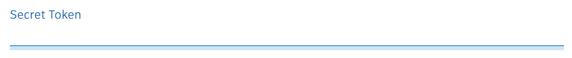

Secret token
Assigning a secret token to a webhook is optional. When provided, any request sent to the webhook URL will be signed using that token. The token value is sent with the request as a header named X-SG-SIGNATURE. The signature is calculated using HMAC with SHA1 and the message signed is the JSON body of the request.
Header format
<algorithm>=<signature>
Why use a secret token?
While not strictly required, providing a secret token causes the payload sent to the webhook URL to be signed. This allows the consumer service to verify that the data originated from the source it expects, and that the payload has not been altered in any way during transit.
Signature verification
An example of how to verify the signature of the payload is provided below using Python.
>>> import hmac
>>> import hashlib
>>> body | `<json body>'
>>> token | `mytoken'
>>> 'sha1=' + hmac.new(token, body, hashlib.sha1).hexdigest() == 'sha1=32824e0ea4b3f1ae37ba8d67ec40042f3ff02f6c'
True
Validate SSL certificate
Validation of SSL certificates is an optional feature that will help ensure the security of any connections made to the webhook’s consumer URL. If turned on, when a delivery is made to the webhook’s URL, Flow Production Tracking will use OpenSSL’s certificate validation routine to verify the certificate.
Deliver in Batched Format
Read more about delivering in batched format here.
Notify when unstable
Notify when unstable allows you to select a person or group to notify when the webhook fails. This setting is optional.
Filtering by Project and Entity
Selecting specific projects, entities, and fields will minimize traffic to your webhook, which in result will:
- Improve performance
- Reduce resource costs
- Prevent unnecessary backlogs
Selecting a project limits you to selecting an entity that always belongs to a single project, such as Versions. If you want to select a non-project (or multi-project) entity like Person, you should not select a project. This ensures webhook event filtering does not add performance overhead to entity updates.
Entity lifecycle Events
These are standard create/revive/update/delete events for entities like Shots, Assets and Tasks.
Custom Events
Custom events are more events that can be subscribed to—like Client Review Site activity, User Logins, and Permission changes.

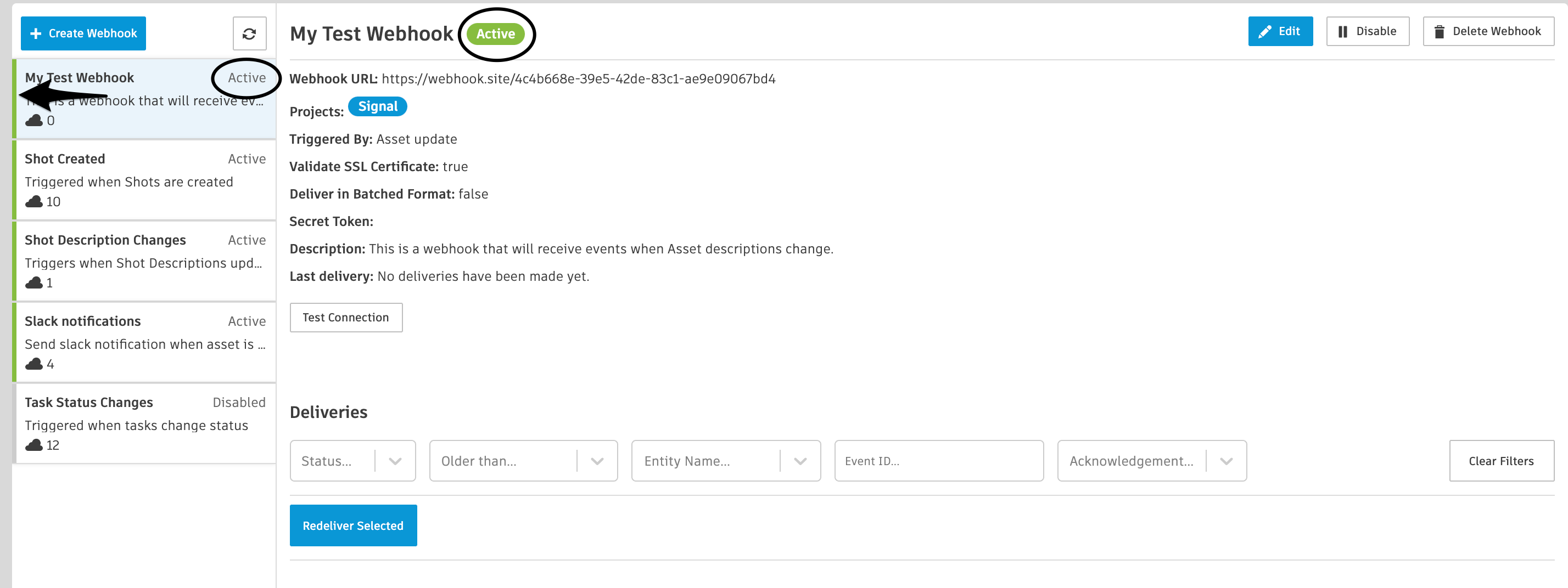

Webhook status
A webhook can have one of several different statuses, indicating its health and ability to continue receiving deliveries.
| Status | Example | Description |
| Active | ![]() |
The webhook is operating in a stable fashion. No deliveries to this webhook's consumer URL have failed to reach their destination in the past 24 hours. |
| Unstable | ![]() |
The webhook is operating in an unstable fashion. Some deliveries have failed to reach their destination in the past 24 hours, but not enough to cause Flow Production Tracking to consider the webhook to be dead. |
| Failed | ![]() |
The webhook is considered to be dead, and no further deliveries will be attempted. This is a result of too many delivery failures in a short period of time, and the system has determined that the webhook should no longer be considered viable. A webhook is considered failed if it has 100 failed deliveries in the past 24 hours. |
| Disabled | ![]() |
The webhook is in a disabled state, and no further deliveries will be attempted until it is re-enabled. |

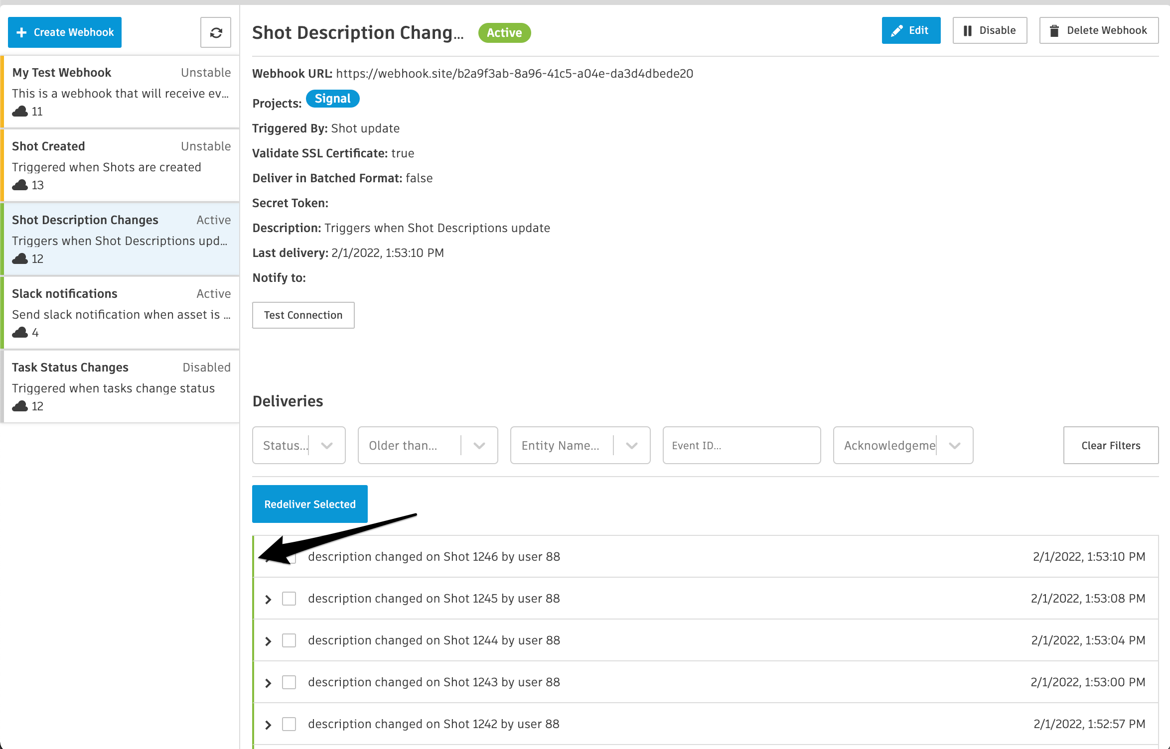

Deliveries

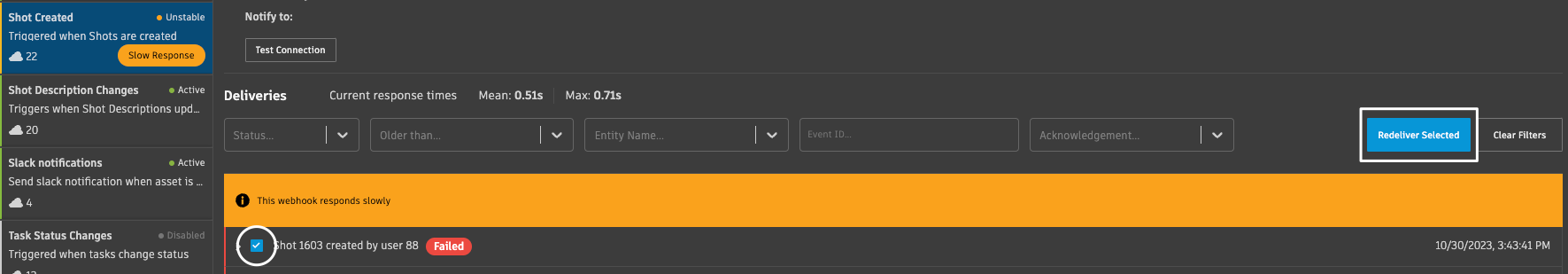

Selecting a webhook from the Webhooks list will show all of the deliveries that have been made for that webhook dating back as far as seven days.
Delivery logs older than seven days are removed and are not recoverable.
Delivery status
A delivery status indicates whether it was successfully delivered to the webhook’s URL.
Delivery details

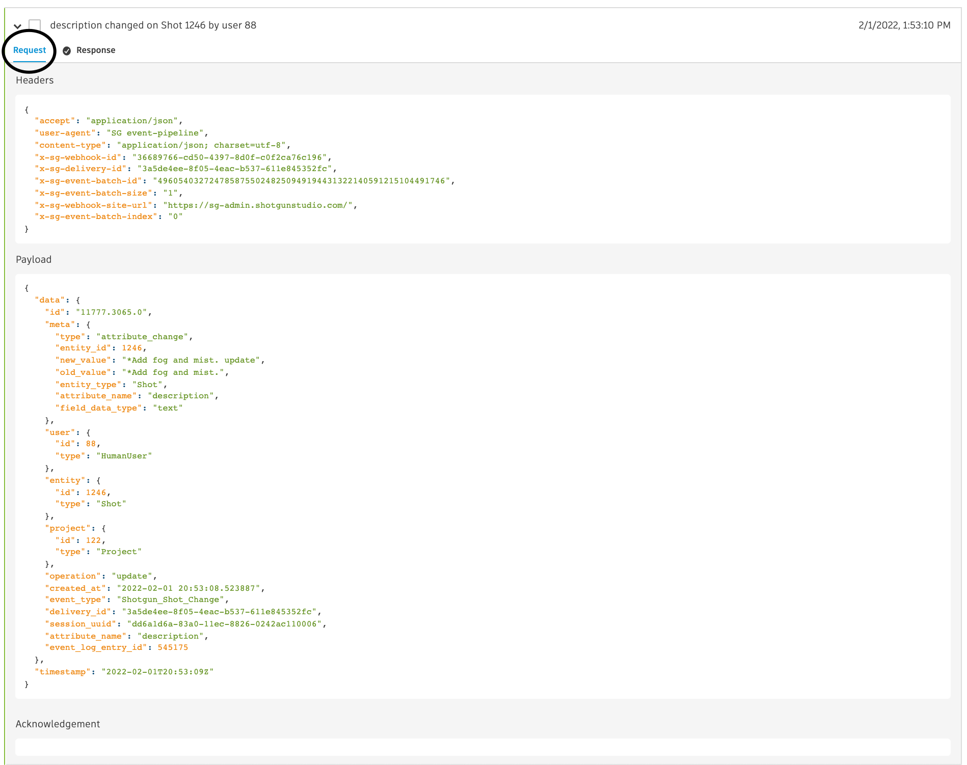

Deliveries can be expanded to show detailed information about the request sent to the webhook URL and the response to that request.
Request Payload
The payload sent to the webhook's URL contains information describing the event that occurred in Flow Production Tracking and who triggered it. It is provided in JSON format.
The maximum size of a delivery's payload is 1 megabyte. Any event triggered in Flow Production Tracking that would result in a payload size larger than 1 megabyte will have its new_value and old_value keys removed, and a warning key added that contains a message explaining what happened, why, and how to retrieve the entire event log entry from Flow Production Tracking.
Example payload

Session UUID
Provided as part of the event payload is the session_uuid that triggered the event in Flow Production Tracking. This value can be provided to Flow Production Tracking's Python API, which will cause any open browser session with that session_uuid to display updates for events generated by the API.

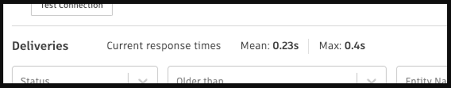

A response must be received within six seconds of delivery to a webhook’s URL, after which the connection will be closed. Failure to respond in time will result in a failed delivery.
Process time is recorded for each delivery and can be viewed in the Response details tab.
Throttling
Flow Production Tracking's delivery infrastructure is optimized to deliver a large number of customer webhooks and has a number of mechanisms in place to ensure optimal performance and reliability for all our customers. When a webhook delivery is made, we examine the time that it took for the endpoint to respond. This metric, along with information about the volume of deliveries being processed, is combined to determine whether your webhook endpoint is performing at a sustainable rate.
Your consumer response times to deliveries will impact webhooks throughput for your site.
Each site is allowed 1 minute of response time per minute. If all configured consumer endpoints for a site take the full 6 seconds to respond, webhooks deliveries for that site will be throttled to 10 per a minute.

Redelivering Failed Deliveries
If some deliveries fail, you can initiate re-delivery of the same events once your webhook endpoint is working again.
- Select the checkbox of the deliveries you want to retry
- Then select Redeliver Selected
Listing and redelivering failed deliveries is also supported by the Flow Production Tracking REST API.

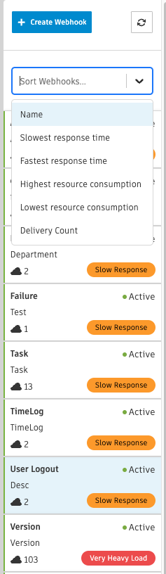

Performance
Response Times
When you select a webhook, you can view the Current response times.
Slow responses and heavy loads
Slow response times and heavy loads are indicated with a colored badge on each webhook. You can also sort webhooks based on response times.
When a webhook impacted by performance is selected, more information about the impact is visible in a banner.
Slow Response
Issue:
- The Slow Response badge appears when the average time to receive a response from the receiving server is > 500ms, causing the webhook to respond slowly.
Solution:
- Optimize your infrastructure since the receiving server is taking longer than the 500ms threshold to acknowledge receiving the events.
Heavy Load
Issue:
- The Heavy Load badge appears when the ratio of timetakentorespondtoaneventaveragetimebetweentwoevents is > 0.1: the webhook consumes over 10% of the allocated bandwidth.
Solution:
- Optimize your infrastructure since the number of webhook events created is slowly overwhelming the capability of the receiving server to acknowledge receiving the events.
Very Heavy Load
Issue:
- The Very Heavy Load badge appears when the ratio of timetakentorespondtoaneventaveragetimebetweentwoevents is > 0.5: the webhook consumes over 50% of the allocated bandwidth.
Solution:
- Optimize your infrastructure since the number of events being generated is very high relative to the number of events being processed and throttling will initiate when you consume over 100% of your allotted processing bandwidth.

A delivery can be updated to include an acknowledgement. When a delivery is made, headers are provided as part of the request. Included in those headers is the ID of the delivery record, stored in the x-sg-delivery-id key. This ID can be used to update the delivery record to include an acknowledgement using the Flow Production Tracking REST API.
The maximum size allowed for an acknowledgement is 4 kilobytes.
Example headers
"accept": "application/json",
"content-type": "application/json; charset=utf-8",
"x-sg-webhook-id": "30f279a0-42a6-4cf2-bb5e-6fc550d187c8",
"x-sg-delivery-id": "dea7a71d-4896-482f-b238-b61820df8b65",
"x-sg-event-batch-id": "1",
"x-sg-event-batch-size": "4",
"x-sg-webhook-site-url": "https://yoursite.shotgunstudio.com/",
"x-sg-event-batch-index": "3"
What are acknowledgements used for?
Acknowledgements allow for out of band, detailed reporting of success or failure to process a delivery that was successfully received by your webhook's URL. This creates a separation between the status of receiving the delivery from Flow Production Tracking and the success or failure to process the event associated with that delivery. As a result, successfully-delivered events can contain additional information useful for debugging purposes.
A good example would be a webhook triggered on the creation of an Asset entity. If that webhook's responsibility is to create a directory structure on disk for each new Asset, the webhook's URL can successfully receive a delivery, but be unable to create the associated directories due to a disk or network outage. Then, it can update the delivery record with a detailed error message stating that the directory structure was not created, and why.
