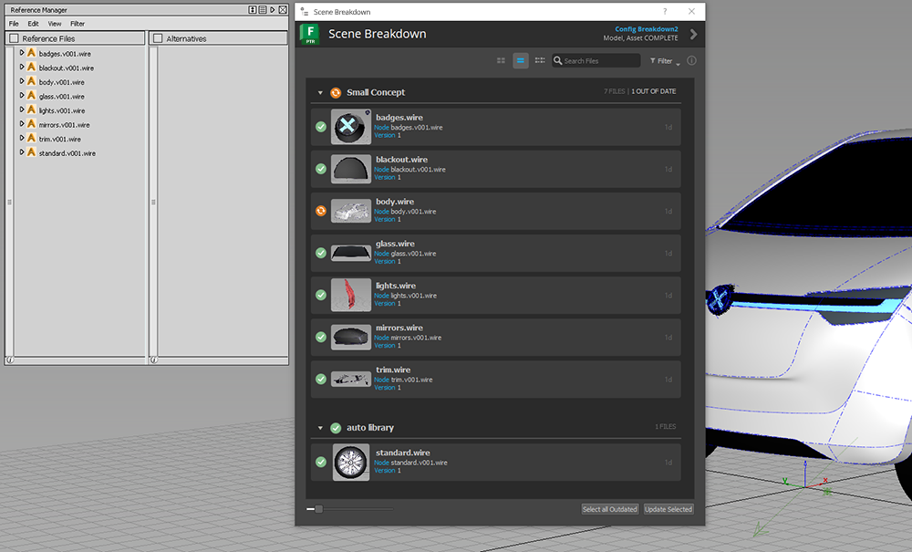

If you are using Flow Production Tracking for managing your Published Files, use the Scene Breakdown app to keep your references up-to-date. The Scene Breakdown app helps you manage references and versioning of Flow Production Tracking Published Files without affecting how you use the Reference Manager in Alias with other reference files.
The Scene Breakdown app also lets you:
- Manage references in multiple Flow Production Tracking Projects.
- Override to a version of a Published File that is not the newest version.
- Get version history file information.
The Scene Breakout app includes multiple configurations and scalable viewing styles.
To use the Scene Breakdown app, you must load files into Alias using the Flow Production Tracking Load app. Just referencing files in Alias using the Alias Reference Manager will not make them appear in the Flow Production Tracking Scene Breakdown dialog.
The difference between the Alias Reference Manager update and the Flow Production Tracking Scene Breakdown are as follows:
- The Scene Breakdown app allows you to up-version to get the latest Published Files when using Flow Production Tracking's versioning system.
- The Alias Reference Manager Update option updates a single file based on a time stamp.
