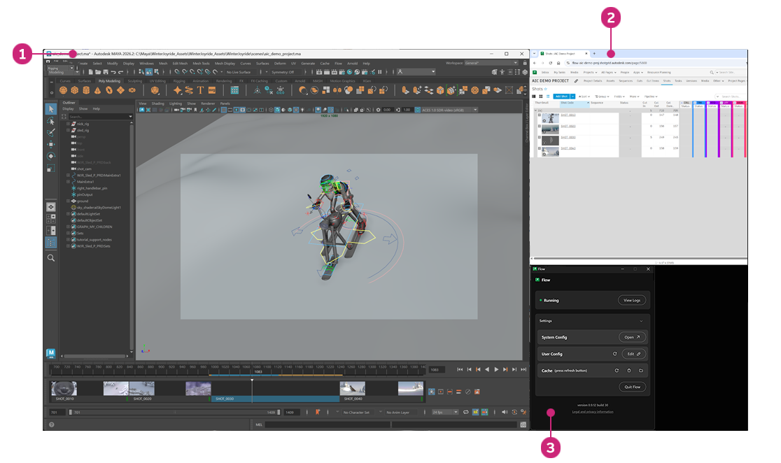

The four components needed to share cuts with Maya for animating in context
Required apps to share cuts with Maya to animate in context: 1. Maya 2026, 2. Flow Production Tracking, 3. Flow desktop service
