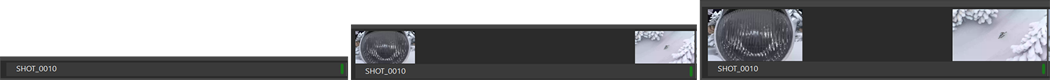

Change how shots are displayed in the Cut Slider Resize the Cut Slider by dragging the top of it up and down to choose between different shot representations (shot names only, small thumbnails, and large thumbnails).
Thre representations of the same shot
