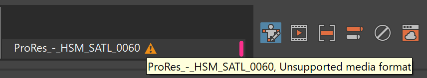

Unsupported media format
Something went wrong while downloading media. Right-click the shot to retry.
Unsupported media error
Some cuts shared from Flow Production Tracking are missing transcoded VP8 video files.
  1. Identify in Maya the Version with missing media, and note its version name.
  2. Open Flow Production Tracking, and open the project that contains the Version.
  3. Go into the Version page.
  4. Set the display to List View, and then click + to display more columns.
  5. Add the Uploaded Movie column.
  6. At the top-right of the Version page, click Search Versions…, enter the Version name, and then type Enter.
  7. With the page showing only the problematic Version, hover over the Uploaded Movie field, and click the drop-box icon at the top right.
  8. Select Replace with Uploaded File.
  9. In the Choose a File to Upload dialog box, click Browse.
  10. Browse to find the movie clip that failed to transcode on the problematic Version, then click Open.
  11. Click Upload. This replaces the media of the Version and should fix the error/.
