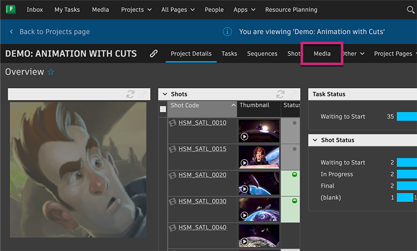

  2. Open the project Media app.
    location of the Media app menu item

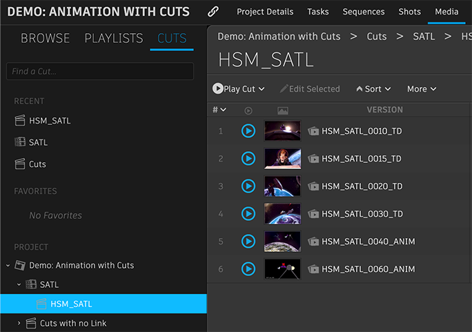

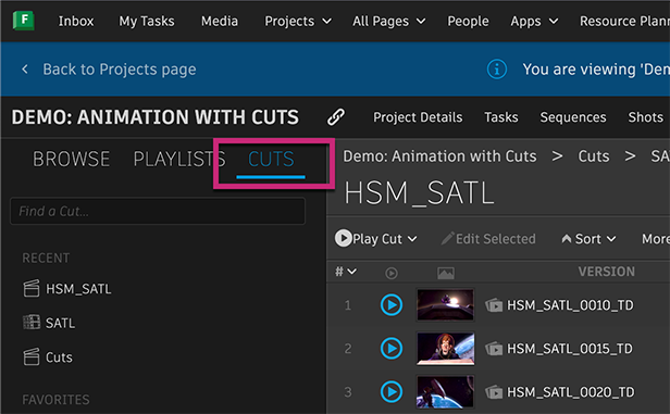

  3. Click CUTS to display the available cuts.
    CUTS tab in the Media app
  4. Select a cut in the project.
    select a cut

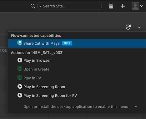

  5. From the Cut Actions menu, select Share cut with Maya (Beta).
    Share cut menu option

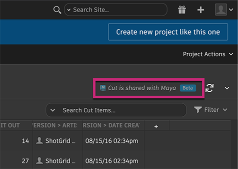

    The cut shows Cut is shared with Maya. Maya users with access to this project can now load the cut in the Flow media browser.
    Cut is being shared in Maya message
