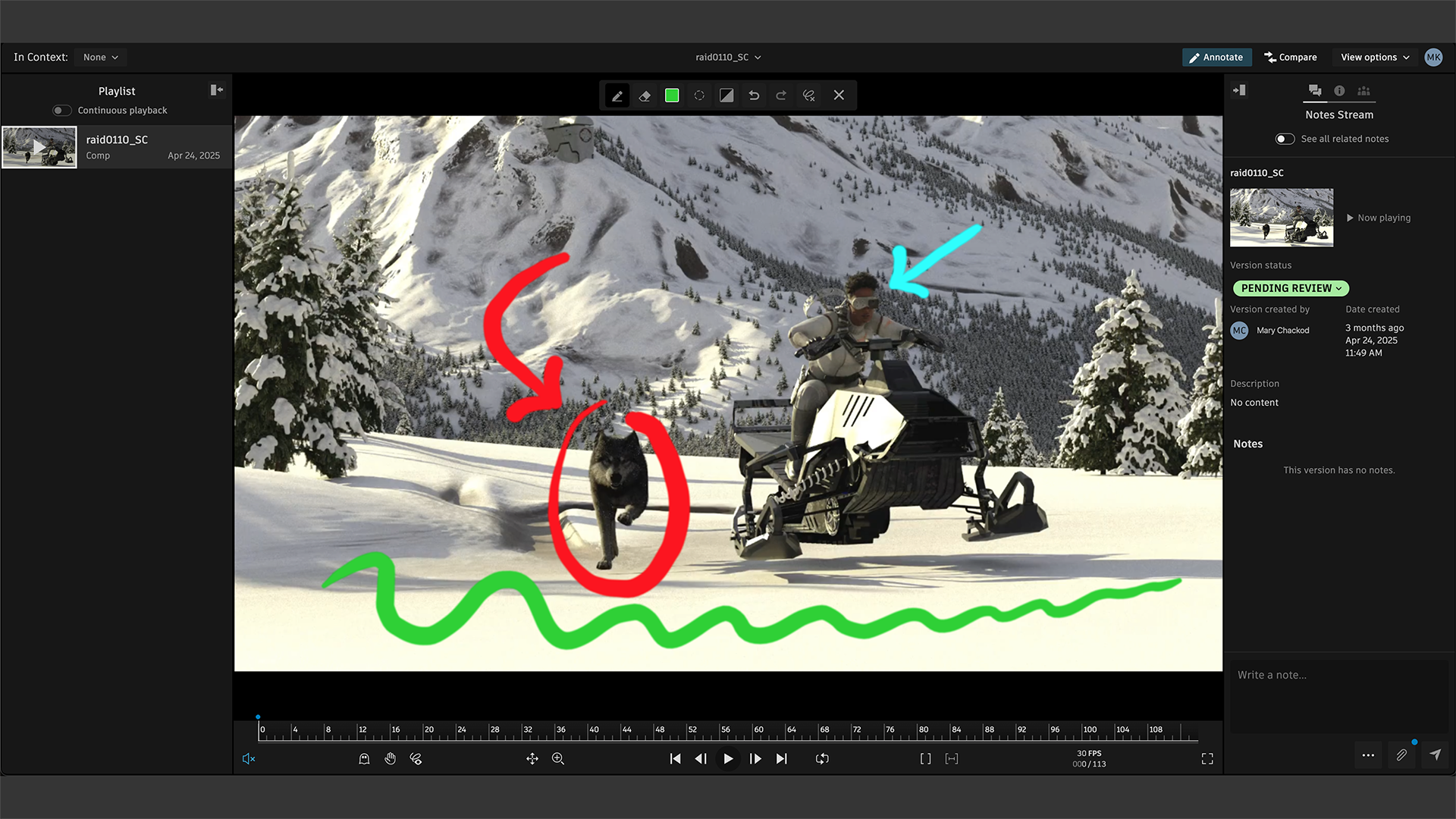

To submit an annotation:
  1. Click Annotate to display the Annotation toolbar.
  2. Select the pen tool from the toolbar.
  3. Draw on the player
  4. In the Notes Stream tab, add a note and click Submit to save and submit your annotations.
    This annotation is now attached to the version in Flow Production Tracking
Until you click Submit, the text, annotations, and attachments reside only in your local browser cache. By clicking Submit, you make your note part of the Notes stream, and permanently attach it to the version in Flow Production Tracking.

Annotate toolbar
Click Annotate to display the Annotation toolbar. Use it to draw freehand; you can set the brush size, color, and opacity.
To send the annotation with a note to the version, click in the Note Stream tab.
Tip:
The blue dots over the timeline show the frames with annotations.
