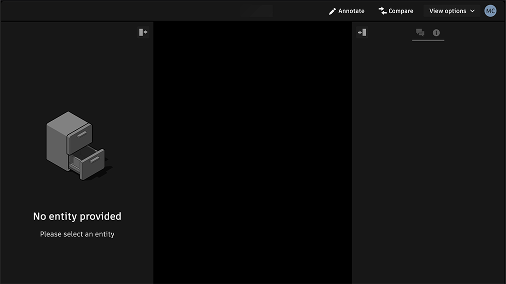

After clicking a Live Review session link, Creative Review opens to a blank screen and doesn't load any media.
Creative Review with a blank screen
This happens because you don't have access to Creative Review or Live Review. To gain access, ask you site administrator to give your Flow Production Tracking Role access to Creative Review and Live Review.
