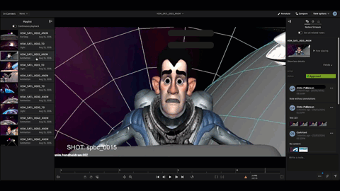

The Version Selector provides you with quick a way to navigate through different versions of a shot.
version selector animation

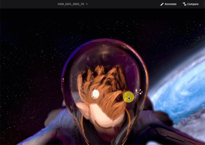

In the Version Selector, you can also search, sort, and filter the versions.
  • Search: Search for anything displayed by the Version Selector: artist name, status, version name, pipeline step.
  • Sort: Sort by artist, date created, pipeline step, status, or version name.
  • Filter: Filter for the selected pipeline steps.
Use the Version menu version menu to:
  • Open the Version in Flow Production Tracking.
  • Compare the Version to the one displayed in the player. This activates the Compare mode, and displays the Compare toolbar.
  • View the selected Version in the player.
