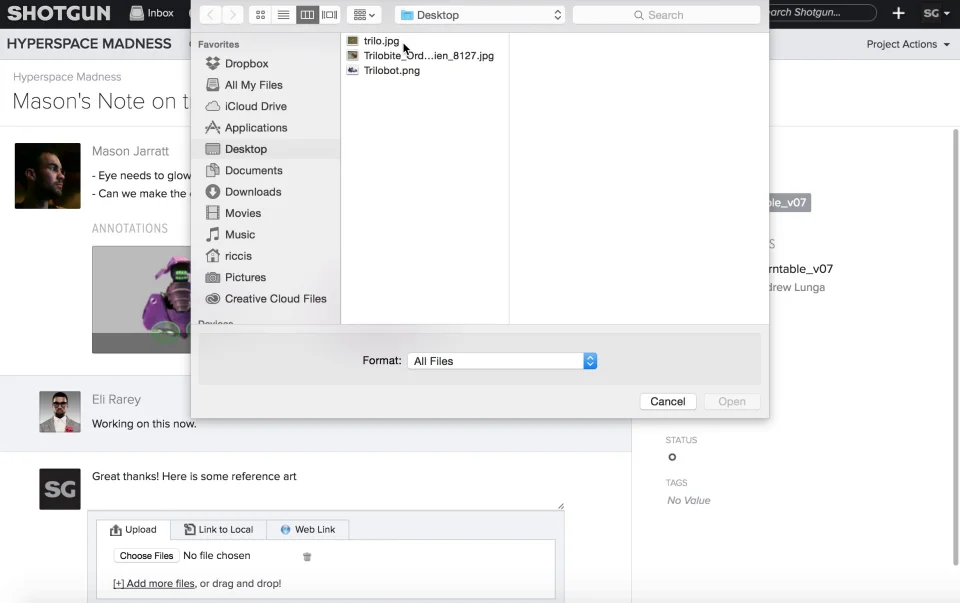

Attaching Files to Notes, Tickets, and Deliveries
Whenever you create or reply to a Note, Ticket, or Delivery, you have the opportunity to upload one or more Files.
From a note detail page
  1. Scroll down to create a reply.
    file note
  2. Now, enter some reply text, click 'Attach', attach the Files, and click 'Create Reply'.
    Wistia video thumbnail
  3. When the reply is created, you can see that the thread includes links to each of the uploaded attachments.

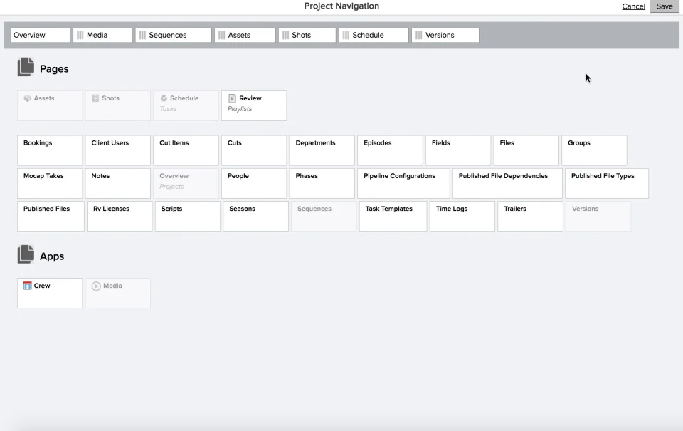

  1. Go to the Projects menu, your Project, "Other", and then choose "Files".
    file page
    Tip:
    If your Admin has added files to the navigation, then all you need to do is go to the Projects menu, your Project, and then choose “Files”.
    file navigation

Tips for Admins
Tip:
Flow Production Tracking doesn't include a Files tab by default on every entity, but your Admin can add one by configuring the navigation or designing the detail page then adding a new Files tab.
