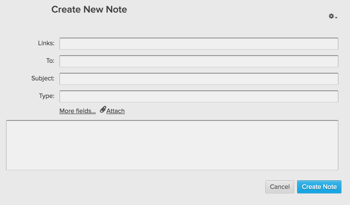

Using custom URLs to load full page forms for creating new entities
You can bookmark or create a URL that opens up a form to create a new Entity (Asset, Shot, Task, etc.). This is handy if you want to bookmark a "New Note" page for quick access.
Developers can also add links to their tools and applications that deep link people into a form that is pre-populated with the correct data. For example, you can build a tool that allows a supervisor who is reviewing Versions to go to a pre-filled Note form. The Note form can have a link to the Version the supervisor was looking at and be addressed to the Artist who created that Version. Or you can embed the new Note form right into your QT application.
How the URL works
The base site URL is appended with "new/" and then the Entity name. The URL for a new Note would look like this:
https://example.shotgunstudio.com/new/Note
The resulting page looks like this:
