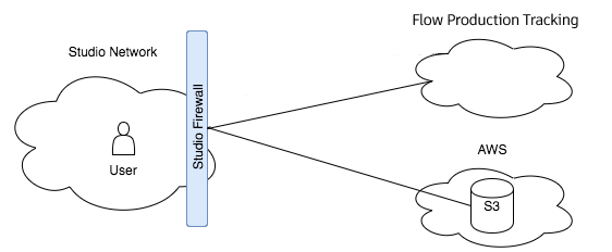

Flow Production Tracking is a cloud platform composed of many services. All of these services need to be accessible to users for Flow Production Tracking to be fully functional.

Many studios restrict their users network access. Because Flow Production Tracking is a service composed of multiple endpoints, restricting network access while allowing Flow Production Tracking to be functional can be a challenge. Different approaches can be used, each with their pros and cons.
Firewall. Your studio may already use a network appliance capable restricting network access. For Flow Production Tracking to work, the FQDNs will have to be granted access by your studio's network administrators. The table above will help them put the required exceptions in place.
Proxy. See Setting up a proxy server for Flow Production Tracking for more details. This may be a good option if your firewall is not capable of performing the necessary Layer 7 filtering.
