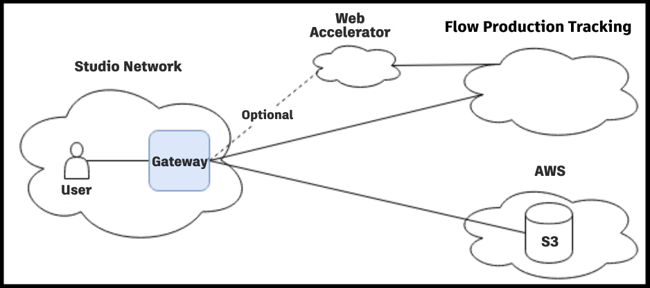

Introduction
A proxy server is a server that acts as an intermediary between clients and an end-server. Proxy servers can be used as an isolation layer between Flow Production Tracking users and Flow Production Tracking services, allowing users to access Flow Production Tracking while restricting access to the rest of the Internet.

Proxy Server and Firewall Configuration
Because the proxy implementation may vary, we won’t get into the specifics. However, a proxy configured to allow traffic to Flow Production Tracking should allow HTTPS traffic on port tcp/443 to the following services:
- Your Flow Production Tracking site FQDN
- Flow Production Tracking service FQDNs
- AWS S3 bucket FQDNs
- Autodesk Identity FQDNs
- Analytics FQDN
- Your IdP FQDNs (optional)
See Flow Production Tracking Ecosystem - FQDNs for a comprehensive list of endpoints
The proxy should be hosted in a network segment allowing it unimpeded access to Flow Production Tracking services.
