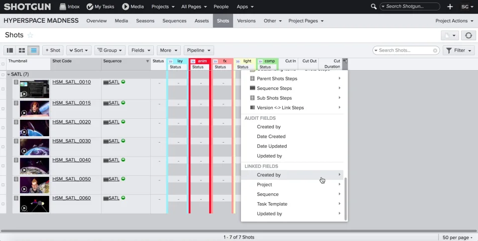

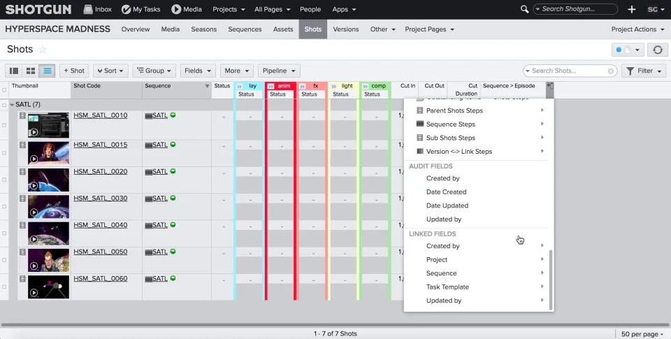

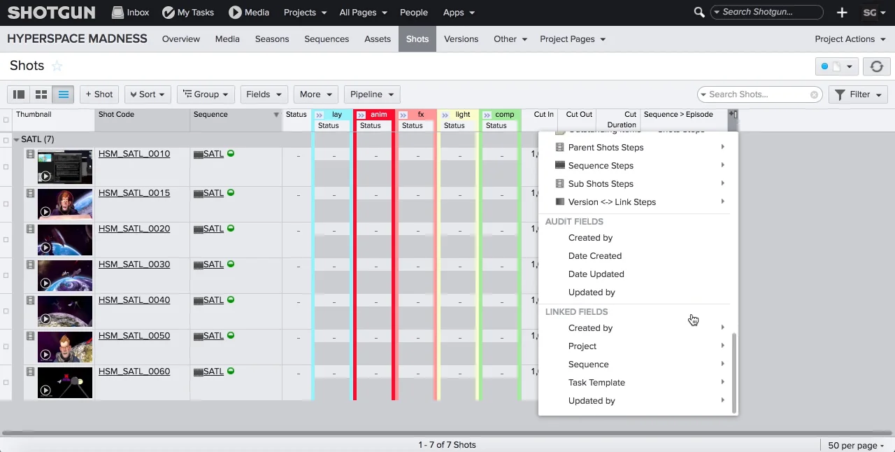

To show the Episode name on Shots, navigate to a page of Shots, and then to Linked Fields: Sequence > Episode.
To show Episode fields on Shots, navigate to a page of Shots, and then to Linked Fields: Sequence > Linked Fields: Episode > {episode fields}.
