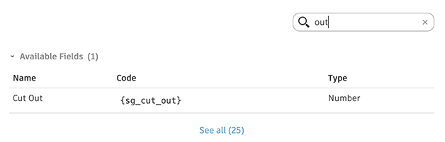

Use Search to shorten the list of Available Fields and Available Linked Fields.
Hover over code and then click
to copy the code to the clipboard.
