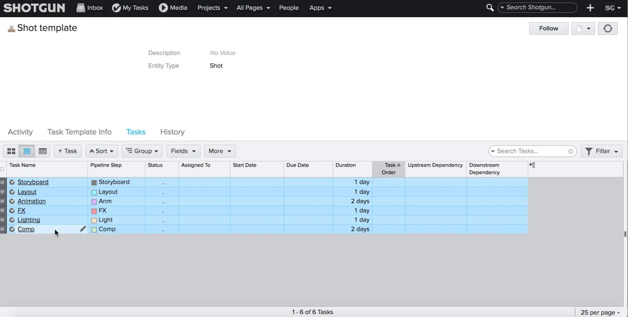

- The new template will appear on the Task Template page. Select your template, and then select the Tasks Tab.
- Create a few Tasks that happen on each Shot (e.g., Layout, Animation, Lighting, etc). For these Template Tasks, you can treat the field values like defaults. For example, you can give each Task a “Task Name”, “Pipeline Step”, and “Duration” because those will be the same across Shots, but you might want to keep the “Start” and “End” fields blank, because those will be different for each Shot. You can always change any of the defaults once you have assigned the Template to an entity.
You can also add dependency links between Tasks in the Template, and those will be maintained when the Template is applied to an actual entity.
Now when you assign a Task Template to your Shots, Flow Production Tracking will automatically create Tasks for each Shot that uses the Template.
