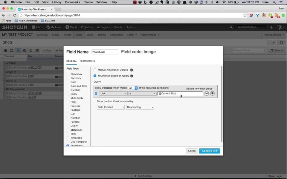

To enable query-based thumbnails on your Flow Production Tracking site, follow these easy steps:
Right-click on the column header of the Thumbnail field you'd like to update and select Configure Field.
Choose between the following two options in the Configure Field dialog:
- Manual Thumbnail Upload: Use this option if you want to upload thumbnails yourself. If there are any Versions linked to the record, you'll see a play button allowing you to play the latest Version.
- Thumbnail Based on Query: Stop worrying about having to keep your thumbnails up-to-date manually. Use this option to automatically display a thumbnail based on a query defined by you. The first Version that matches your query will be displayed.
Select Thumbnail Based on Query.
Adjust the query settings for your needs and click on Update Field.
That's it!
If the query returns a Version with no thumbnail, no thumbnail will be displayed. To get around this, add the Thumbnail is not empty condition to your filter.
