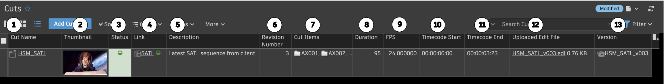

The core of the Cut data model are the Cut and Cut Item entities. At the Cut-level, we track global information about the Cut, like Revision Number, FPS, EDL file, and an optional Base Layer Movie Version.
A Cut can be associated to Sequences and Scenes by default, but can be customized to just about any entity in Flow Production Tracking as a way to support various editorial workflows—such as Episodes, Commercials, Trailers, and more.

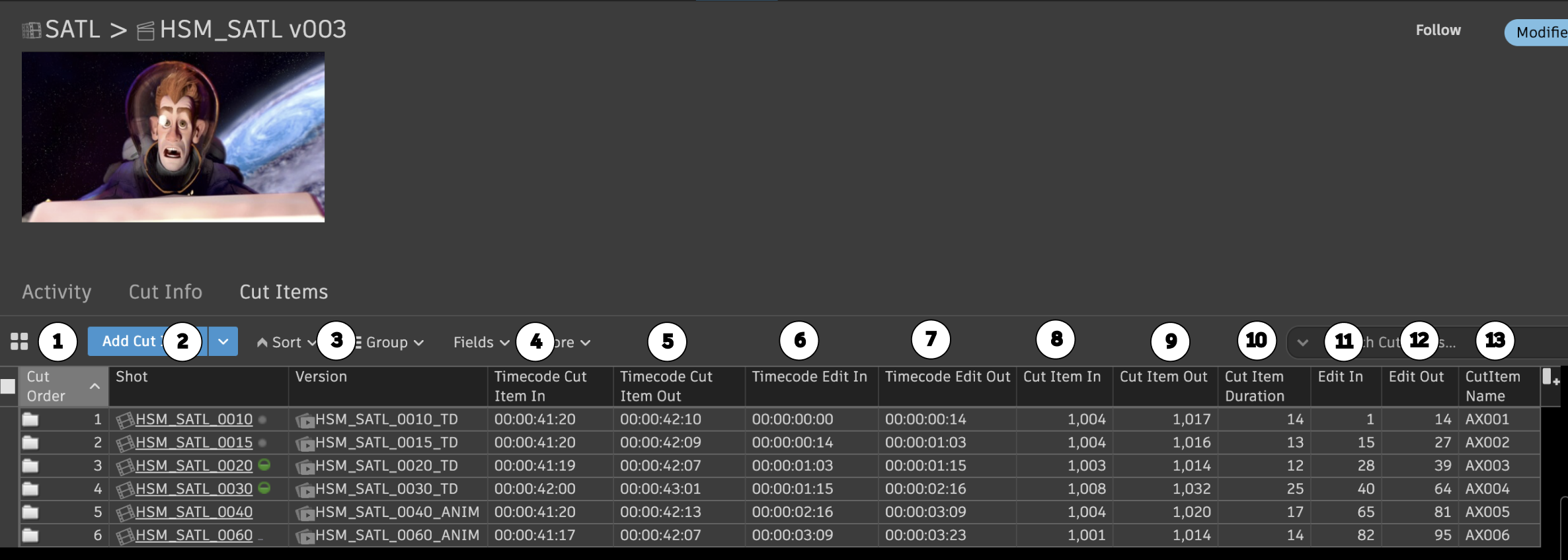

Cut Items are connected to Cuts and make up the actual items of an EDL. Think of it as the Flow Production Tracking-based view of your EDL. At this level, we are tracking things like Cut Order, individual clip In/Out points in Frame and Timecode formats, and optional links to Shots and Versions.
Cut Field Details
Cut Name (
text)Thumbnail (
image)Status (
status_list)Link (
entity)- The Link field is what connects a Cut to other Cuts via their shared parent Entity. For example, two Cuts linked to the Sequence called SATL are considered related.
- This field would link to a Sequence or Scene by default, but it can be configured to other Entities to support your workflows.
- To customize what Entities a Cut can be linked to, right click on the Link column header, select Configure Field, and check the desired entity.
Description (
text)Revision Number (
number)Cut Items (
multi_entity)Duration (
number)FPS (
float)Timecode Start (
text)- Timecode data is stored as a string, as it serves as a snapshot of the EDL upon import.
Timecode End (
Uploaded Edit File (
multi_entity)- This is the EDL file that reflects the Cut record in Shotgun. It’s helpful to have the EDL file in Shotgun for future reference or to be pulled down by other tools for use in other areas of the pipeline.
Version (
entity)- A Version linked to a Cut is used as the Base Layer Movie when playing back a Cut in the browser or RV. Having a Base Layer Movie Version makes it possible to view your Cut regardless of whether work has started on a Shot or if it’s a non-VFX Shot in the Cut.
Cut Item Field Details
Cut Order (
number)Shot (
entity)- A Cut Item can be linked to a Shot, but doesn’t have to.
- When linking a Cut Item to a Shot, you enable the ability to filter for Versions linked to a Shot appearing in a Cut.
- If you don’t link a Cut Item to a Shot, it’s generally assumed that the Cut Item either represents a portion of the Cut where work has yet to begin or a non-VFX Shot.
Version (
entity)- When linking a Cut Item to a Version, that specific Version will play in the browser or RV.
- If you don’t link a Cut Item to a Version, it’s assumed that there is no available media for that portion of the Cut yet. In this case, the browser and RV players will look to the Cut-level Base Layer Version to fill in the gap. If no Cut-level Version is available, the players will report no media is available.
Timecode Cut Item In (
text)- This represents the Timecode In point of the individual piece of media in a Cut.
Timecode Cut Item Out (
text)- This represents the Timecode Out point of the individual piece of media in a Cut.
Timecode Edit In (
text)- This represents the Timecode In point of the overall Cut. This value is sequential over the Cut.
Timecode Edit Out (
text)- This represents the Timecode Out point of the overall Cut. This value is sequential over the Cut.
Cut Item In (
number)- This represents the Frame In point of the individual piece of media in a Cut.
- When importing a Cut with the RV Import Cut Tool, this value is automatically calculated and populated.
Cut Item Out (
number)- This represents the Frame Out point of the individual piece of media in a Cut.
Cut Item Duration (
number)- This is the Frame duration of the individual piece of media in a Cut.
Edit In (
number)- This represents the Frame In point of the overall Cut. This value is sequential over the Cut.
Edit Out (
number)- This represents the Frame Out point of the overall Cut. This value is sequential over the Cut.
CutItem Name (
text)- This value is pulled directly from the EDL edit item.
