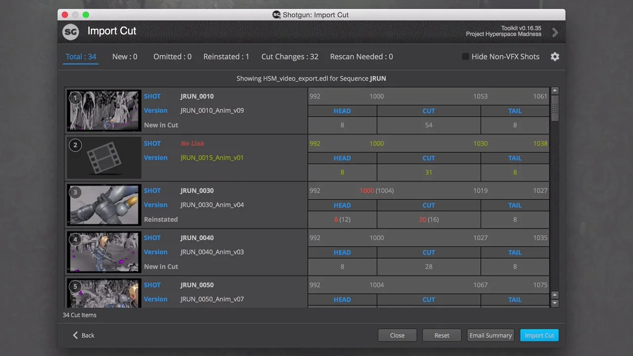

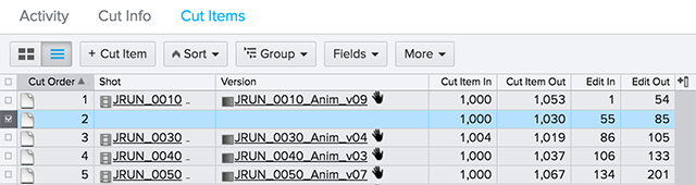

Last but not least, you don’t have to associate every event in the EDL with a Shot. A blank value is ok! When an EDL event doesn’t match a Shot, Flow Production Tracking still tracks it as a CutItem, stores the in and out points, and uses the base layer for playback during that section.

When creating Shots, the Import Cut Tool will set the status to the default status for Shots in Flow Production Tracking, as specified in the field configuration. It will also link the Shot to the the same entity that the Cut being imported is linked to, meaning if the Cut is being linked to the ‘JRUN’ Sequence, the app will set that in the Sequence field of the Shot JRUN_0015 when it creates it.
