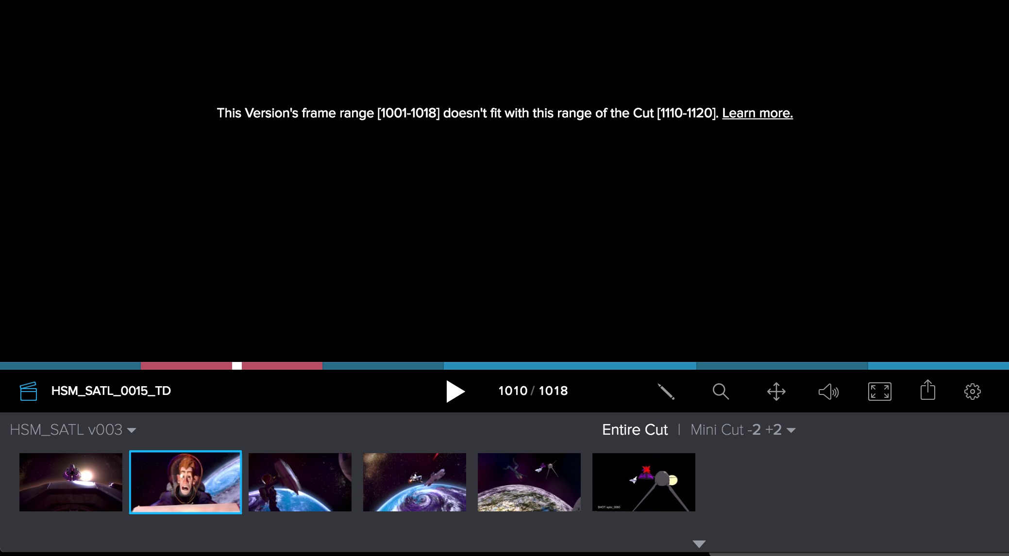

If—along the way—there's a mismatch of data, things can get hairy and you may see a message like this in the Overlay Player:

This Version's frame range [1001-1018] doesn't fit with this range of the Cut [1110-1120].
In this example, the player is flagging an issue where the Shot Version's available frame range [1001-1018] does not fit in the Cut's frame range [1110-1120].
Resolving this issue likely requires a conversation with Editorial or whoever owns the Cut, as the Shot Version falls completely outside the Cut range.
