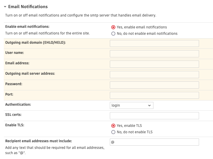

Next, configure Flow Production Tracking so it can communicate with your SMTP server. To do so:
- In the Flow Production Tracking Web App, go to Site Preferences -> Email Notification
- Fill in the information
Important:If you are using Microsoft O365 email services, be sure to put the same value for the fields "User name" and "Email address".
