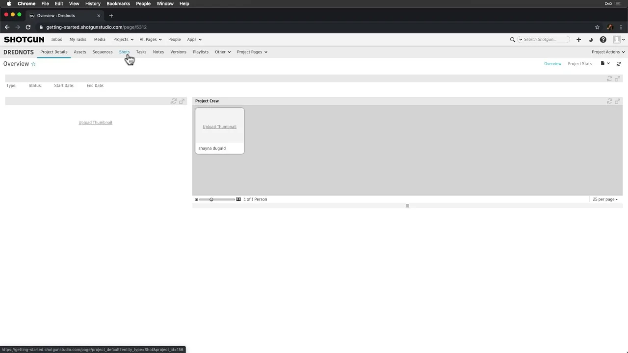

Let’s base our Dreadnots project on the Film VFX Template since it has sequence-based work. Once we create our project, we’ll land on Project details. All the important things we are tracking are visible in the Project Nav. Let’s add a project thumbnail and fill in a few key details.

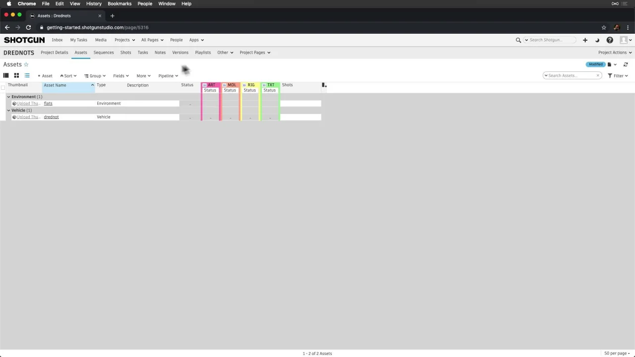

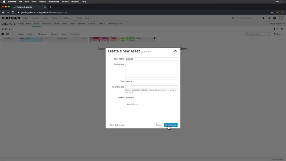

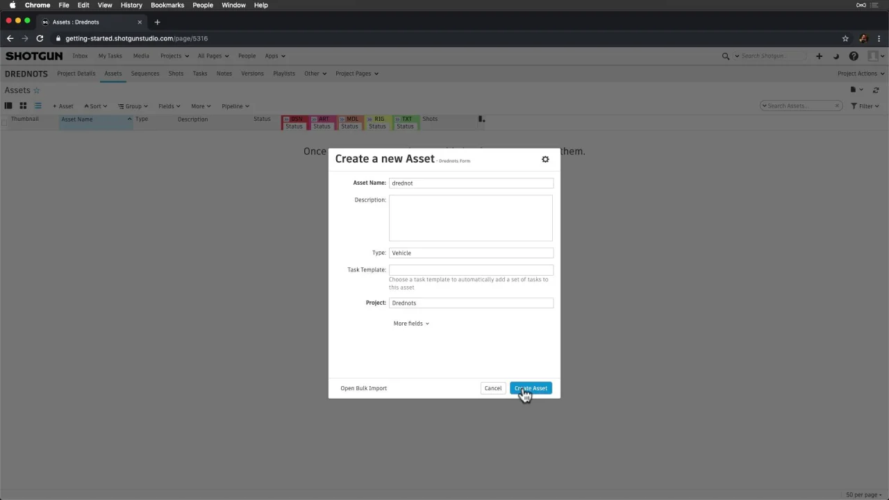

We create Assets from the Assets page. Let’s make the “drednot” vehicle and the “flats” environment. Notice how there is an option for a Task template. Let’s clear for now as we’ll explore Task templates next. We can hold the option/alt key to create an asset and keep the form values to speed up the process.

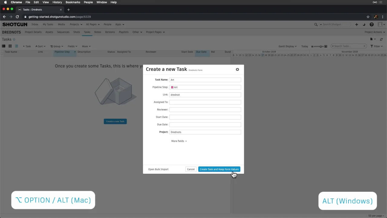

Now that we have these two Assets, let’s create tasks on the Tasks page. We can create one-off Tasks, link them up to an Asset, and again hold the option/alt key to keep the form values.

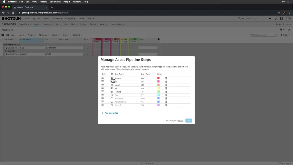

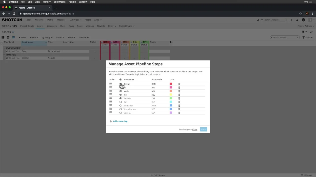

Let’s think about our pipeline, and how things move through different stages of their lifecycle. For Assets, we have four different departments responsible for completing Tasks: Art, Model, Rig, Texture.
Let’s update our workflow in our Project. This also reflects the order Tasks flow through the pipeline, and we have the ability to reorder these.

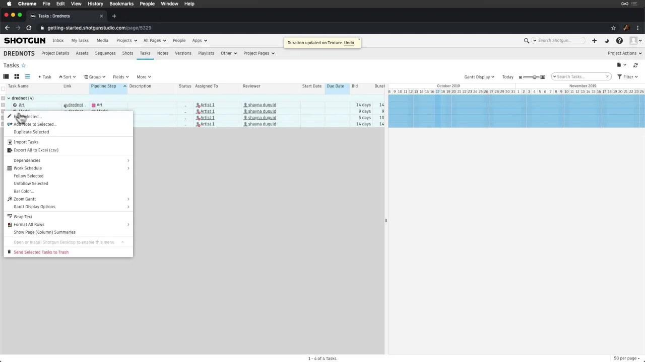

From our Task page, we can assign Tasks to Artists and Reviewers, and input bid and duration information. Since these tasks need to be completed in this order, let’s create a Task Dependency chain. Let’s cover our options for dependencies:
- Finish-to-start is set by default, and indicates that the second task in the chain can’t begin until the first task finishes. When we set a start date on the first Task in the chain, others will cascade after. And, if one Task shifts in the schedule, others downstream will follow.
- Start-to-start means that linked tasks will start at the same time, but the due date may vary depending on the duration. So we may have these two tasks start at the same time using start-to-start, but then the next couple of tasks in the chain need to start after the second task is completed, so let's use finish-to-start on those remaining tasks. We can simply add a couple of dependency links to this.
- Finish-to-finish will make it so all tasks linked will finish at the same time, but the start date may vary depending on the duration.
- Start-to-finish is the opposite of finish-to-start, so when the second task in the chain finishes, the first task starts.
For these tasks, let’s make sure they’re in the right order and then select finish-to-start. Now, when we adjust a start date on the first task in the chain, others downstream will follow.

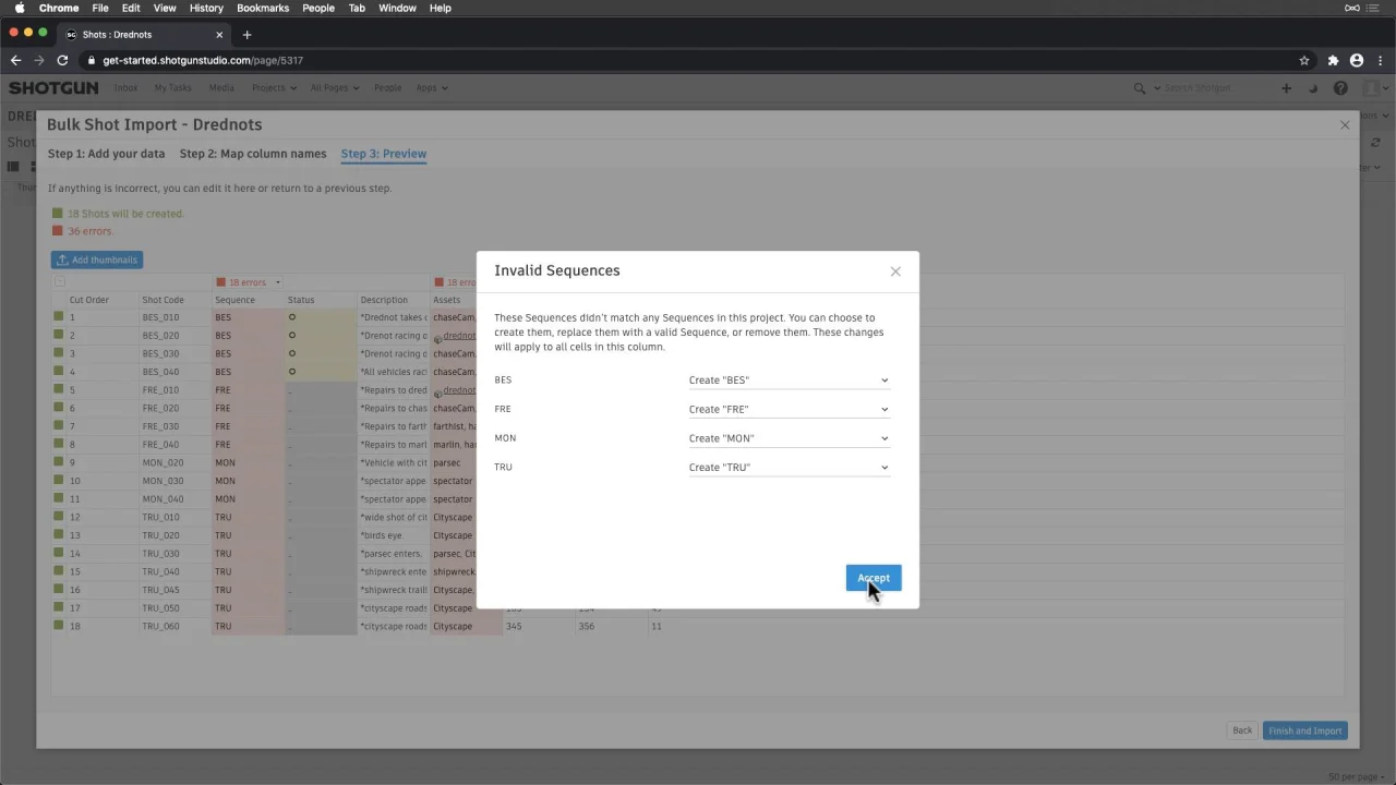

- Select the Add Shot dropdown, then Import Shots. We can drag and drop our excel breakdown directly into the window, or copy and paste from the sheet.
- Let’s match the columns, continue, and then address the errors. Notice the 18 errors under Sequence—since Sequences don’t yet exist yet, we have the option to create them first from here, so we select “Fix invalid sequences in this column” then accept since these all look valid. Let’s do the same with Assets and accept.

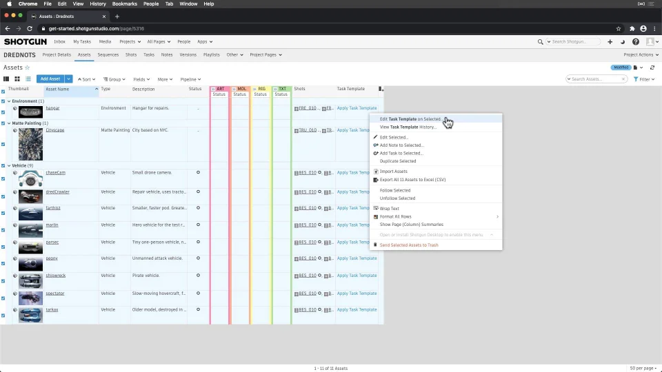

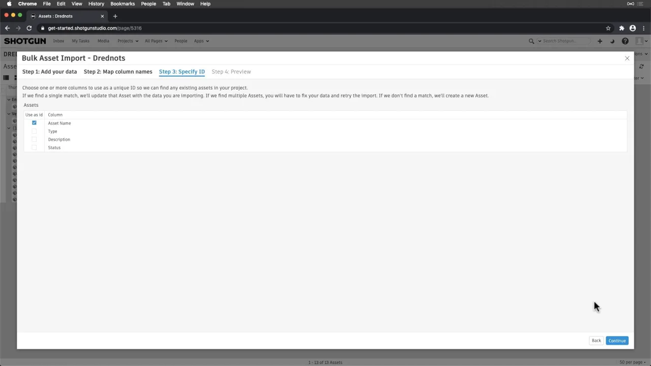

Now that our Shots, Sequences, and Assets are imported, let’s take a moment to update our Assets with their Asset Type, Descriptions and Statuses in the breakdown. We do this from the Assets page via the importer:
- Import the Assets breakdown sheet
- Map the columns
- Use the Asset Name as the identifier for existing assets so those get updated with this additional information
- Add Asset thumbnails to make them more visually appealing
Importing may take a little while depending on thumbnail image sizes.

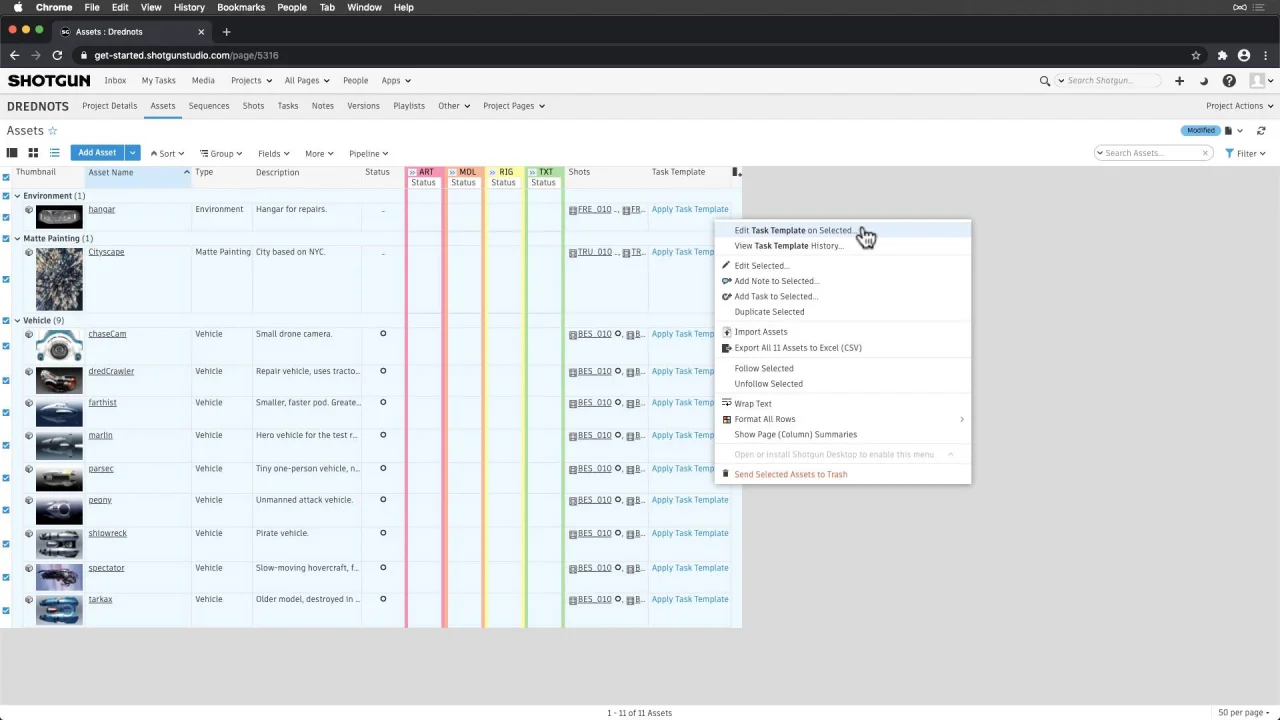

Now that our Assets are looking good, let’s take a moment to apply the standard task template that we created earlier, where the task template is blank.

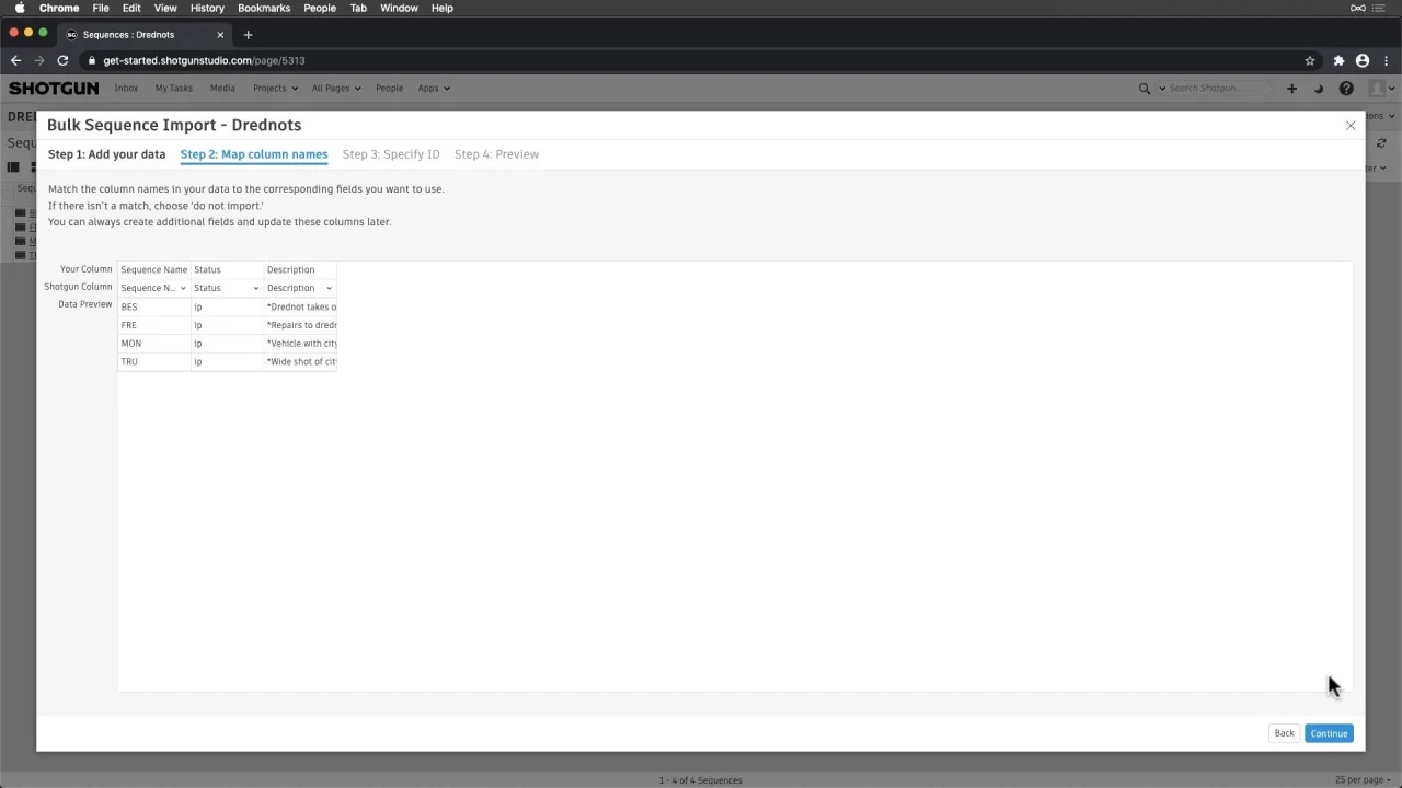

Let’s do a similar import update, but this time for Sequences from our breakdown, updating the Descriptions and Statuses:
- Import the Sequence breakdown sheet
- Use the Sequence Name as the identifier for existing assets so those get updated with this additional information
