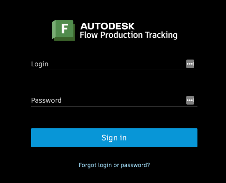

Legacy Flow Production Tracking Login Credentials
Before migrating to Autodesk Accounts, you used your legacy Flow Production Tracking site authentication which included your Flow Production Tracking login and password.
legacy-login
Dual Login Mode
While in the process of migrating, your Flow Production Tracking Administrator may have activated Dual Login Mode. In this transition phase, you will be promted to either use your Flow Production Tracking site login credentials, or your Autodesk Identity to log in.

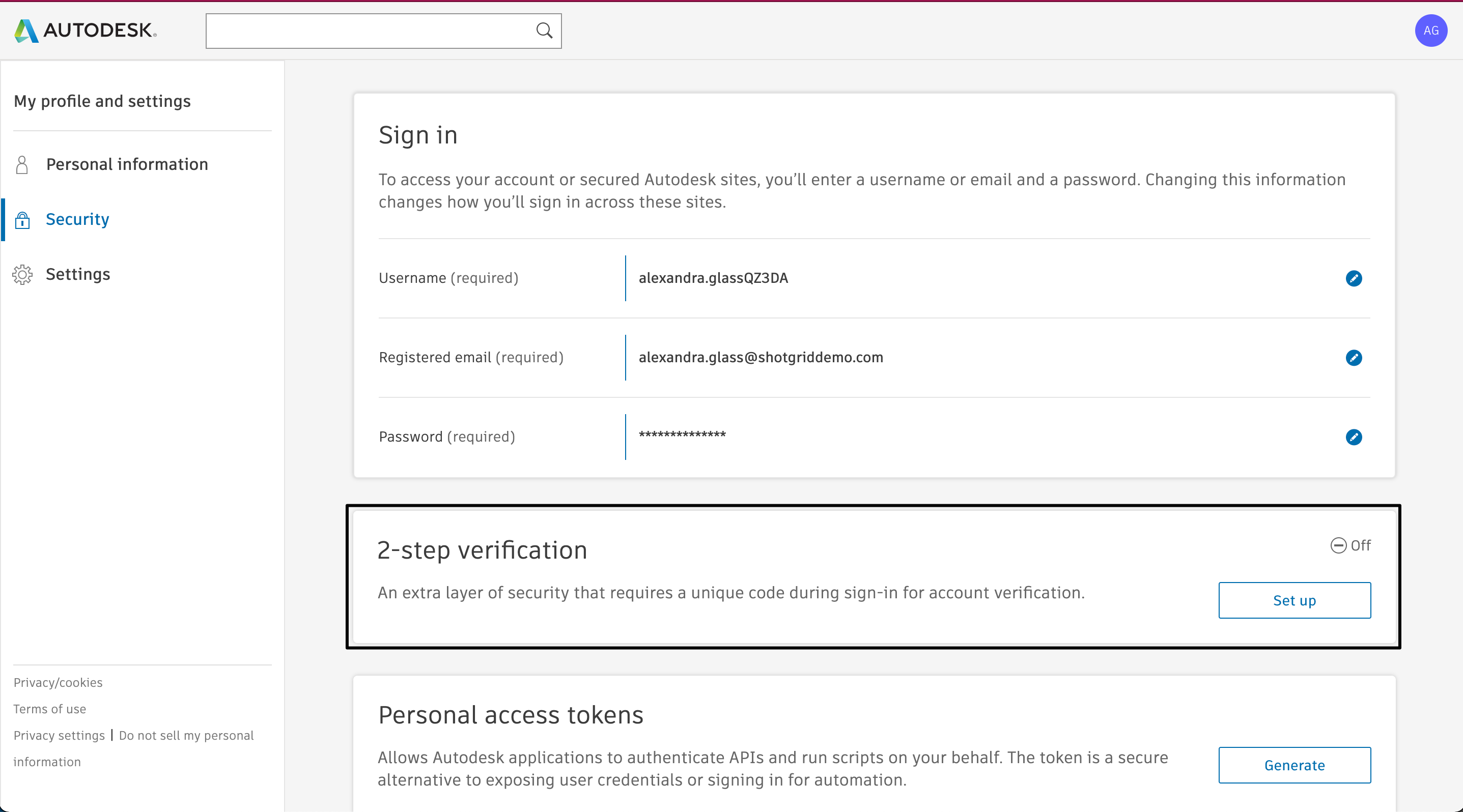

Configure 2FA
Configuring a 2FA for your account is a good security practice. Also, your Flow Production Tracking admin can require you to have 2FA enabled to access your Flow Production Tracking site. You can configure your 2FA settings from https://profile.autodesk.com/.
2FA-settings-1
2FA-settings-1
To learn more, see Set up two-step verification.

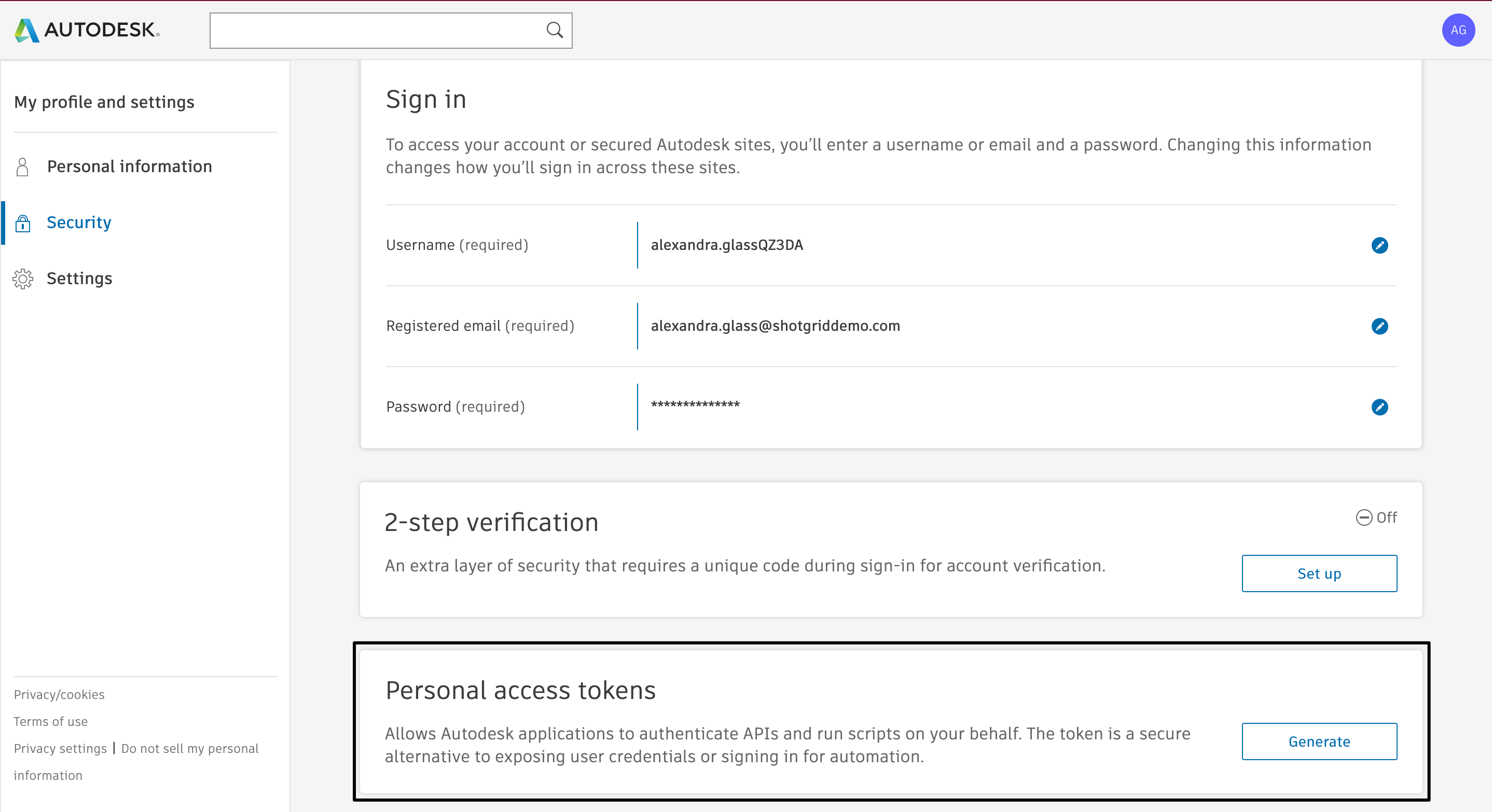

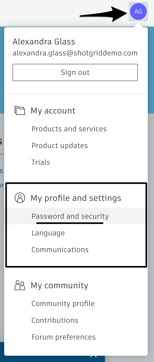

  1. Go to your Autodesk Profile under the Security tab.
  2. In the Personal access tokens section, select Generate.
PAT-setup

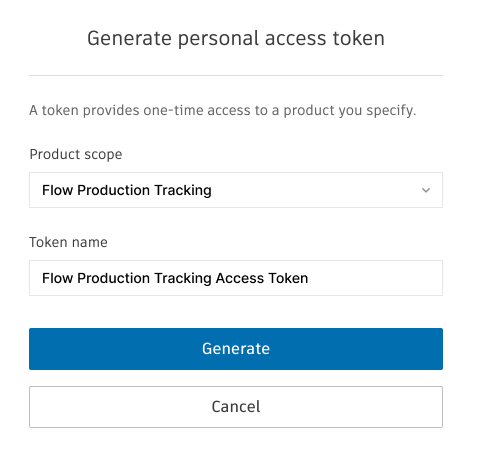

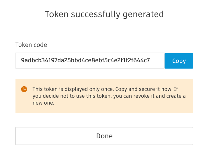

  1. From the Application scope list, select Flow Production Tracking .
  2. Give a name to your token in the Token name field. Then select Generate.
PAT-generate
This generates your Token code. This token is displayed only once. Make sure to keep a copy of it in a safe place. It is this token that you will copy over into your Flow Production Tracking site profile.
PAT-token-code

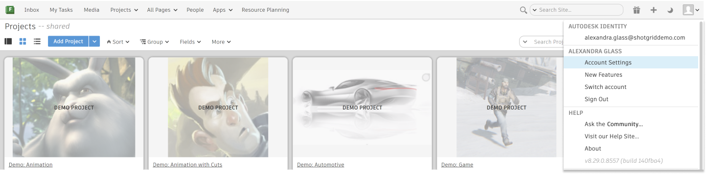

  1. On your Flow Production Tracking site, select your profile through the user settings menu, and then select Account Settings.
PAT-user-settings

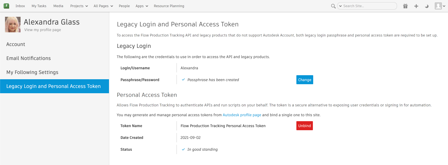

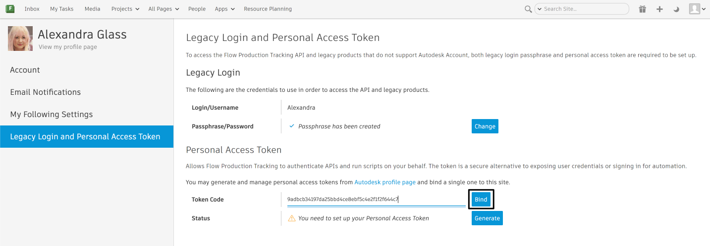

  1. On your profile page, select Legacy login and Personal Access Token.
PAT-save-sg
Note:
You will need to be logged in with Autodesk Identity to access the Personal Access Token section.
  1. Paste your token code in the Personal access token text field (see above image).
  2. Select Bind.
PAT-bind
PAT-bound
You are now ready to use your external applications.
