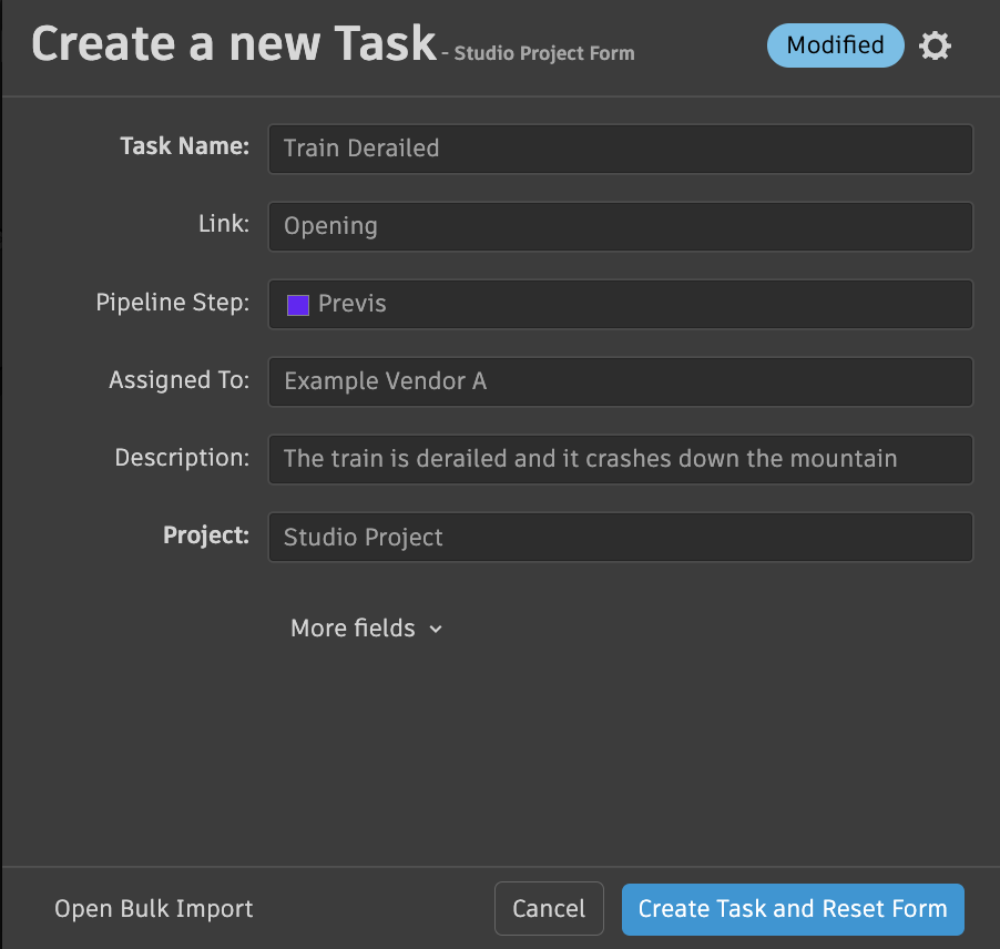

Track previs work by adding Tasks to each Sequence as required, giving them an appropriate name, description and adding vendors to the “Assigned To” field. Be sure to create a “Previs” pipeline step for this purpose.

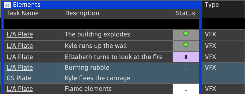

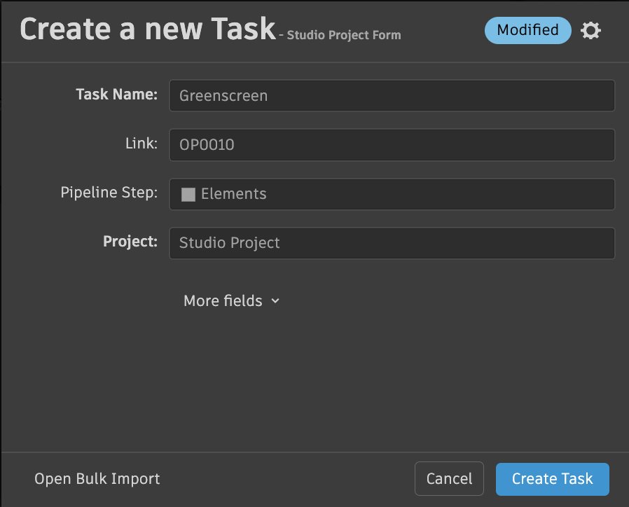

To track live action plates and elements for Shots, simply add Tasks to the Shots, giving them an appropriate name and description. Be sure to create an “Element” pipeline step for these tasks.
Use the “Principal Photography” tab of the Shots page to quickly add Element Tasks by right-clicking on the Shot within the Element section, and choosing “Add Task to Selected”.
At the end of the shoot day, verify that all the plates and elements were captured and update details, such as the status of the element.

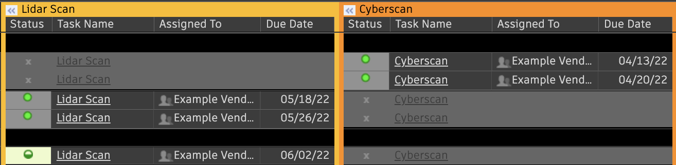

Track LIDAR and cyber scans

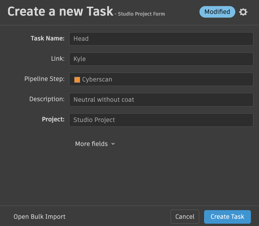

To track LIDAR and cyber scans for Assets, simply add Tasks to the Assets, giving them an appropriate name and description. Be sure to create and use “Lidar Scan” or “Cyberscan” pipeline steps as required.
At the end of the shoot day, verify that all the scans were completed and update details such as the status of the scan.

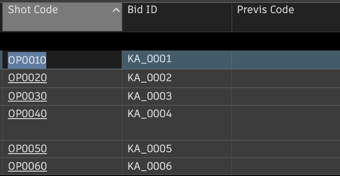

If you’ve been tracking Shots in Flow Production Tracking since pre-production, you may need to update the “Shot Code” to be based on the editorial shot names. Create and use additional “Bid ID” and “Previs Code” fields for example, to keep a record of previous shot names as required. Other important fields to update for each Shot might include “Description”, “VFX Work”, “Sequence”, “Turnovers”, and “Reel”. In particular we recommend you create a new custom entity called “Turnover” and associate the Shots to be included with them.

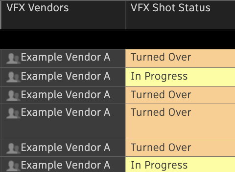

Next you can assign vendors to work on the Shots by creating a “VFX Vendors” field (an entity or multi-entity field based on Groups), and also “VFX Shot Status” field (a list or status list type field) as appropriate.

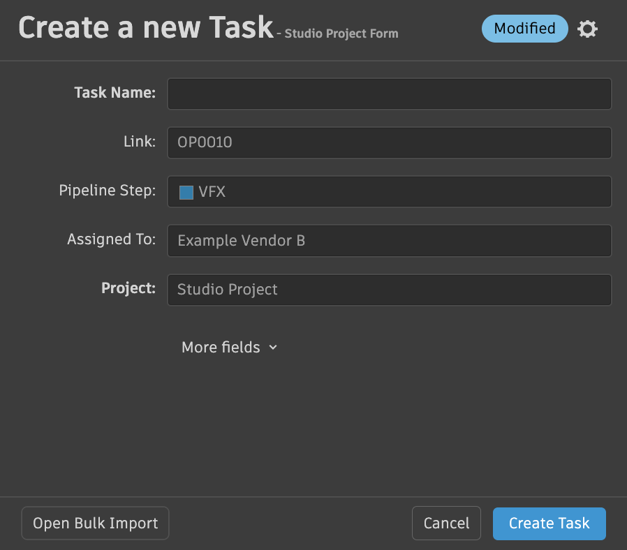

If you will need to track multiple vendors per shot (typically when working with “split shots”), you should assign vendors to work on the Shots by adding Tasks. To do this, create a new Task on the Shot, adding the vendor to the “Assigned To” field and making sure to create a pipeline step for tracking, along with a “VFX Shot Status” field to allow tracking per vendor.
In general, you should add one Task per vendor. This will allow you to get the correct Shot count that accounts for split shots.
