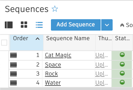

In Site Preferences, Flow Production Tracking Admins can configure entities to sort by a specified field when displaying groupings on that entity Page. For instance, Grouping Shots by Sequence order. In cases like this, you can create a custom Order field on the Sequence entity that we can use to order our Sequences, and as a result, order Shots by Sequence order on your Shots Page when Shots are grouped by Sequence. Let's use this common example for applying a custom sort field for entity groups in Site Preferences, but this can be applied to other entities in Flow Production Tracking as well.

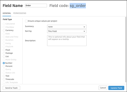

  1. Make note of the field code you'd like to sort by, along with the Entity name that field is on. You can look up the field code by right-clicking on the field header, then selecting "Configure field...". You can copy and paste the field code from here. Or, you can always reference field codes via the fields page, if you have admin controls. From this example, that's Sequence:sg_order.

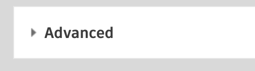

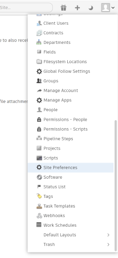

  1. Then, you'll want to navigate to Site Preferences then to Advanced Preferences, and then to Custom sort field for entity groups: (referenced here). This is where you'll enter the Sequence:sg_order value you noted previously, and then save.

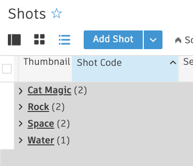

    Before:

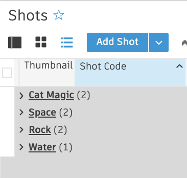

    After (with a simple page refresh):
