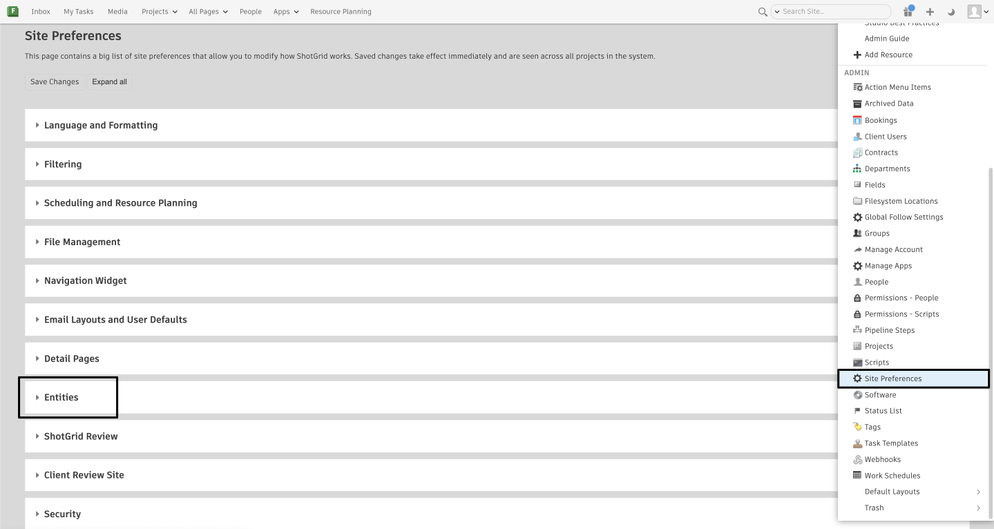

Step 1: Enable Delivery
Admins can enable the Delivery entity under Site Preferences.
Click the image above to enlarge.
Choose Delivery under Entities. Select "Yes, enable entity."

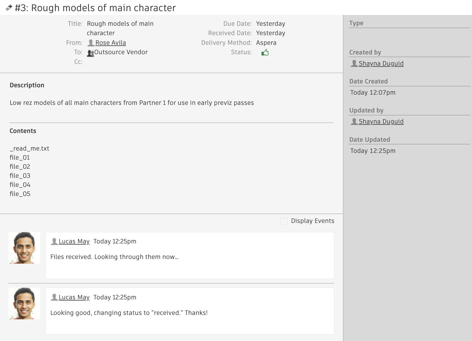

Below is a sample Delivery list page and detail page. The list page is where you'll see lots of Deliveries, and the detail page is where you'll see a view of one specific Delivery.
Below are common fields on a Delivery list page:
- Delivery # or Title: Click to see details of the delivery and the conversation thread.
- From, To, and Cc fields: Address the Delivery to People or Groups. Comments on that Delivery are emailed out to those people.
- Status: Default statuses are Delivered, In Progress, Open, and Received.
- Due Date and Received Date: Track expected and actual delivery dates.
- Delivery Method: Track Delivery Method, Type, and other details about each Delivery.
Clicking on a Delivery's # or Title field takes you to its detail page.
Detail pages can be customized.
- Contents: Text field with a list of files that were delivered. Easy to search.
- Replies: Thread of replies facilitating conversation about the Delivery and resolving any problems. Each reply sends out an email to everyone addressed to the Delivery (To, Cc., From).
- Sidebar: Shows related information (this can be customized by an Admin).

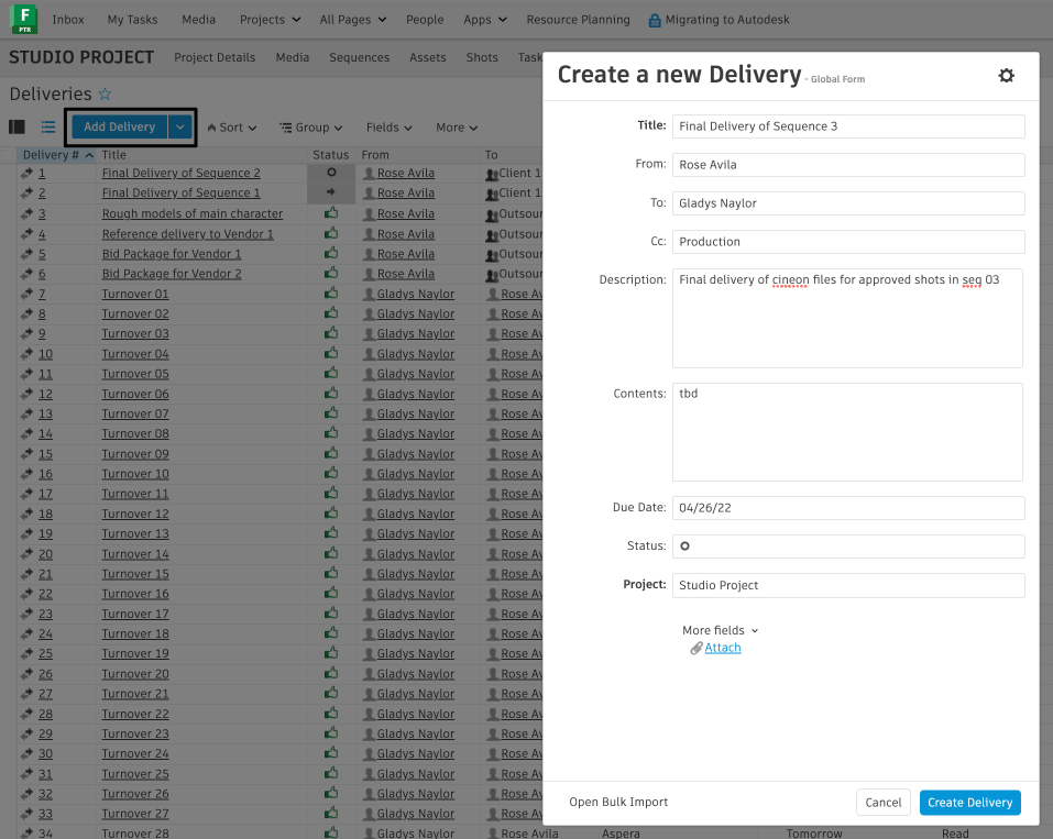

Creating a new Delivery
To create a new Delivery, click the + button on any Delivery page. The form, which appears in an overlay on top of the page, will look something like this (though this can be configured by an Admin):

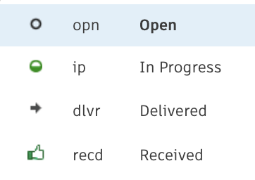

Statuses
You can use the Status field to help manage the Delivery workflow. The defaults are:
“Delivered” can be used when the data has left one location, and then "Received" can be used once the receiving location confirms the data was received and checked for errors.
This field can be edited just like any other status field, so Admins can configure it if necessary.

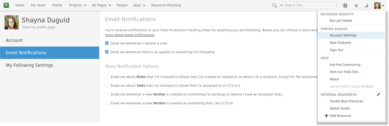

Email notifications are sent out when the Delivery is created or when anyone adds a reply. The people who receive the emails are those in the From, To, and Cc fields, or anyone that created a reply on any Delivery. Note that each person can turn these emails on or off by navigating to the Email Notifications page via the Account Settings link in the top right corner of all Flow Production Tracking pages:
In your Account Settings, you can set your email notifications, upload a profile picture, and change your password.
There are a few caveats on email notifications:

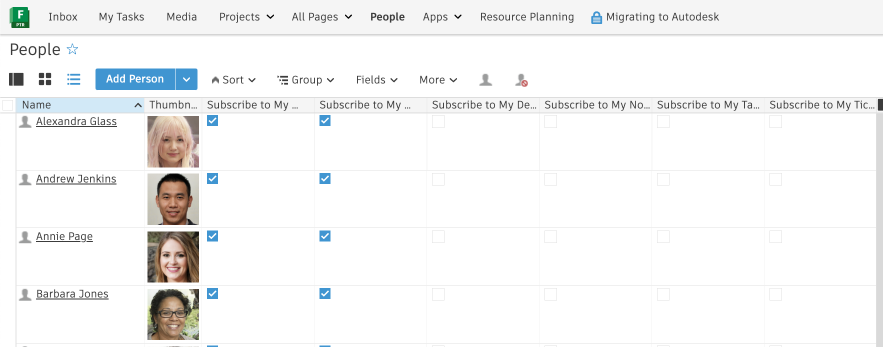

- By default, Managers and Admins can view any Delivery for any Project, and therefore can receive emails on all Deliveries (if they choose to subscribe to all Delivery emails)
- In order for Artists to receive email notifications on a Delivery, they must be linked to that Delivery's project
- Inactive and deleted user accounts will never receive email notifications on anything (including Deliveries)
Admins have the ability to modify these settings for any user by directly editing the field values on a People page. Note that these email notification checkbox fields will only show up if the corresponding entity is turned on.

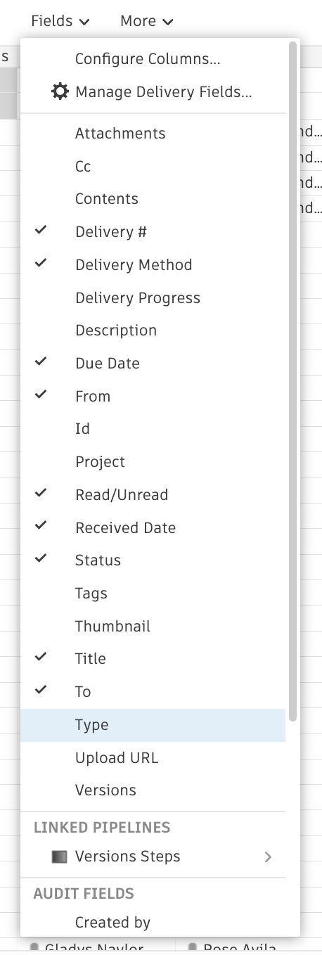

Default Delivery fields
Below is a list of the most commonly used default fields on Delivery:
- Project: The Project the Delivery is associated with.
- Delivery #: Created automatically by the system.
- Title: Similar to an email subject line; this a short description of the purpose of the Delivery.
- Contents: Text field that displays the contents of the delivery.
- Delivery Method: Drop-down list, including FTP, Fedex, Aspera, Sneaker Net, etc.
- Description: A longer description about the Delivery, its contents, purpose, etc. Like the body of an email.
- From: A single Person or Group that the Delivery is from. This must be someone with an account in Flow Production Tracking, though the account can be deactivated.
- To: One or more People or Groups.
- Cc: One or more People or Groups.
- Due Date: Date field, indicating when the Delivery is expected.
- Received Date: Date field, indicating when the Delivery was received.
- Read and Unread: Indicates if the current person looking at the Delivery hasseen the detail page since the Delivery was created or since a new reply was added.
- Status: Open, In Progress, Delivered, Received, etc.
- Attachments: Files attached to a reply.
- Tags: One or more keywords.
- Thumbnail: An image that represents the Delivery, which must be uploaded manually or through the API.
The Type field can be used to track many types of deliveries, such as turnovers and vendor deliveries.
