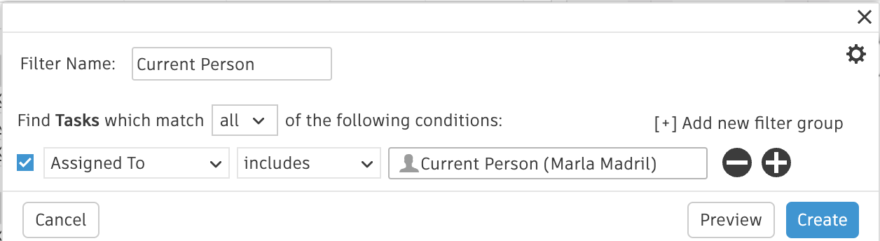

Next, you can create the “current user” filter to curate pages and show Tasks only assigned to the logged in user. This works well when combined with the advanced Hide Saved filters permission.
current person filter

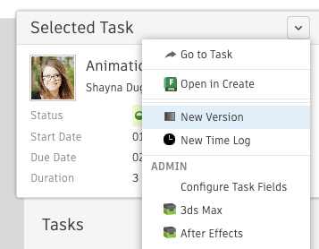

Submit
Artists submit Versions for review (videos or still images) via the menu on their My Tasks page.
new version
