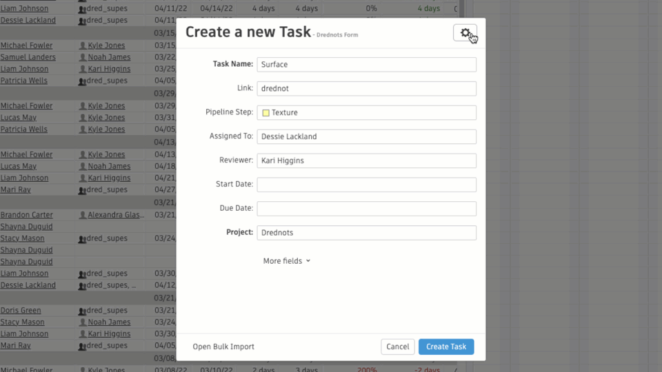

Creation dialogs: Keep that form open!
We’ve all been there. We need to quickly create a few Assets or Shots. They’re pretty similar, but it’ll take more time to create a CSV to import than to simply fill out the creation form directly within Flow Production Tracking.
“But when I click the ‘Create Shot’ button, the dialog disappears, why can’t it just stay up with all the form values?”
It can! Here are a couple different ways to quickly create things using the new entity dialog forms.

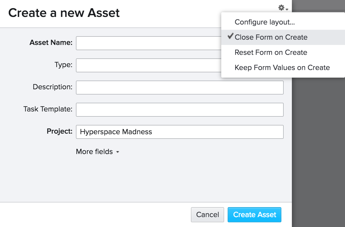

Alt key modifier
In all creation forms (Assets, Shots, Versions, etc.) if you hold the Alt key, the “Create <Entity>” button will temporarily turn into a “Create <Entity> and Keep Form Values” button for as long as the key is depressed. This allows you to create an entity like an Asset, modify a couple of the form values, and create another one without having to relaunch the creation dialog for every Asset you need to create.
Another option is to change the default state of the creation button. First, click the more actions gear in the upper right corner of the dialog window. Then choose from three options:
- Close Form on Create: This is the standard behavior that closes the form after you click the create button.
- Reset Form on Create: This will create the Entity, clear the values in the form, and leave the creation dialog open.
- Keep Form Values on Create: This will create the Entity, keep the form values, and leave the creation dialog open.
Using these steps you’ll be even more nimble when creating new entities within Flow Production Tracking.
Create link to pre-filled form
You can also share links with your team to pre-filled forms via the gear menu on each entity creation form. From the menu, select Create link to pre-filled form, then Copy to Clipboard.

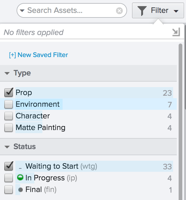

Filter Panel: Multiple selections, one query
The Filter Panel is an amazingly powerful tool that allows you to zero in on information you need to find within a page with lots of results. It can take a while to to find what you need if you wait for new results to appear after every filter option is clicked. Luckily, there is a better way!
By holding the Command key (OSX) or Ctrl key (Windows/Linux) and clicking different filter options on and off, the query will not run (and therefore not refresh the page) until the key is released. This allows you to build a more complex set of filters in one set of mouse-clicks, and Flow Production Tracking will return one set of results.

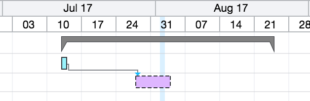

Gantt Alt drag
Tasks, Task Dependencies, and the Gantt are great tools for visualizing and organizing a schedule within Flow Production Tracking. Sometimes it's useful to set up offsets between dependencies, as maybe the dependent Task doesn’t need to start exactly the day after the upstream Task is finished. Just clicking and dragging a dependent Task in the Gantt will cause it to become pinned. Using our Alt key, we can move Tasks further down the timeline and still have dependencies automatically adjust all other tasks in the chain, without pinning the Task in place on the Gantt.

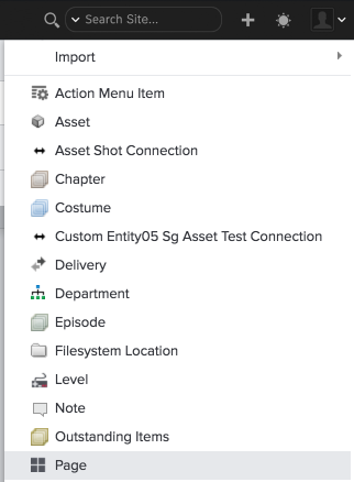

Jumping to menu items
You can jump to the menu item you want just by typing it. For example, use the keyboard shortcut “n” to activate the new menu. Then begin typing “page.” You’ll notice that your selection will jump down and highlight Page. Hit Enter to select it.
This works all throughout Flow Production Tracking, from the Apps menu to the toolbar buttons such as Sort, Group, Fields, More, and Pipeline. If there’s a nested menu, you can use your arrow keys to open that menu and your focus will be in the new menu. Then type what you need and press enter.
