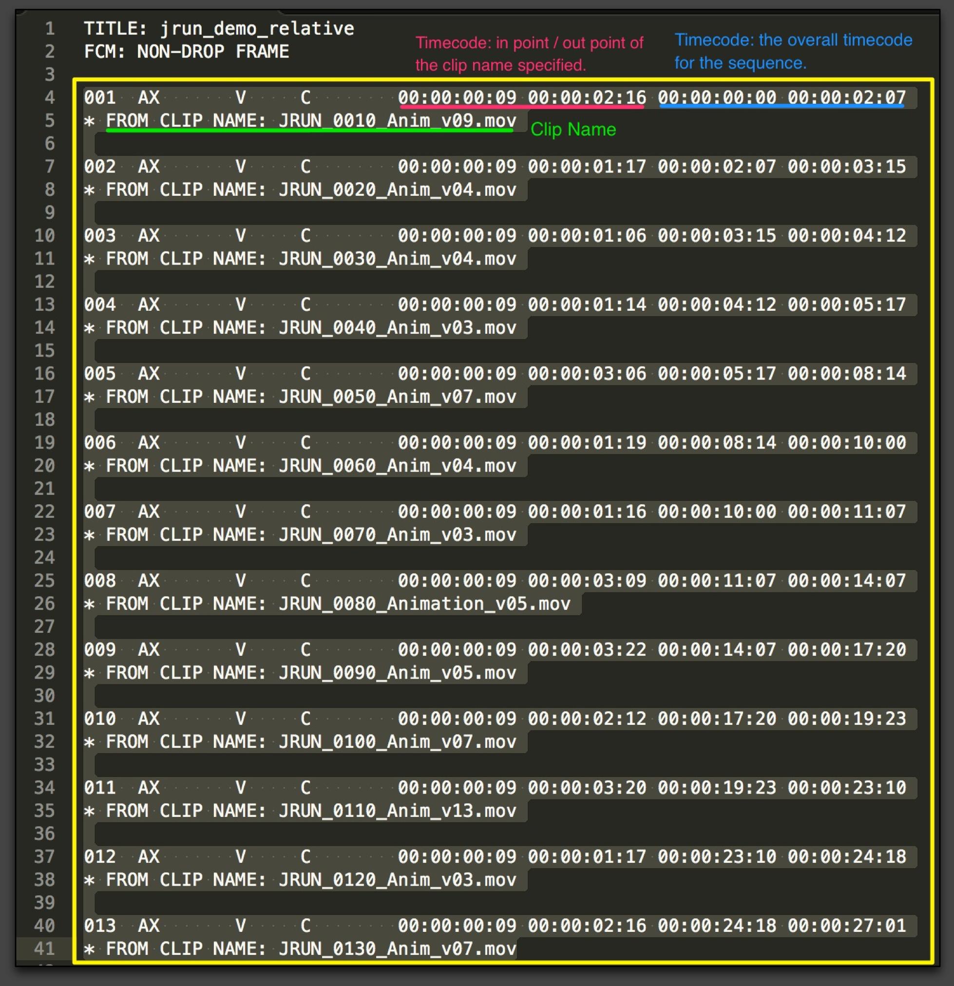

An Edit Decision List (EDL) is a file that contains editorial information and is anything that is editorial aware. Software like Avid Media Composer, Adobe Premiere, Apple Final Cut Pro, Flame, and FilmLight Baselight produce EDLs. In our project Hyperspace Madness, we use the Media Composer to produce our EDLs, and will walk through how we import a new Cut and update a Cut in Flow Production Tracking in this tutorial.

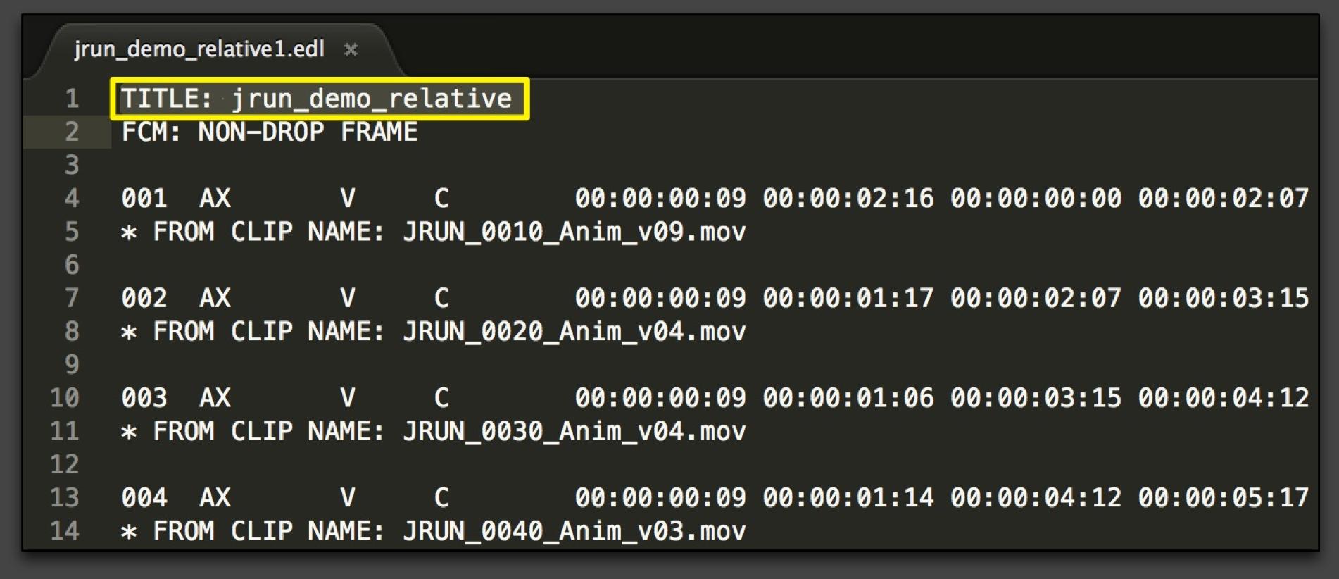

An EDL contains:
  • A Name (TITLE): This title will carry through as the name of the Cut once imported into Flow Production Tracking.
    EDL title

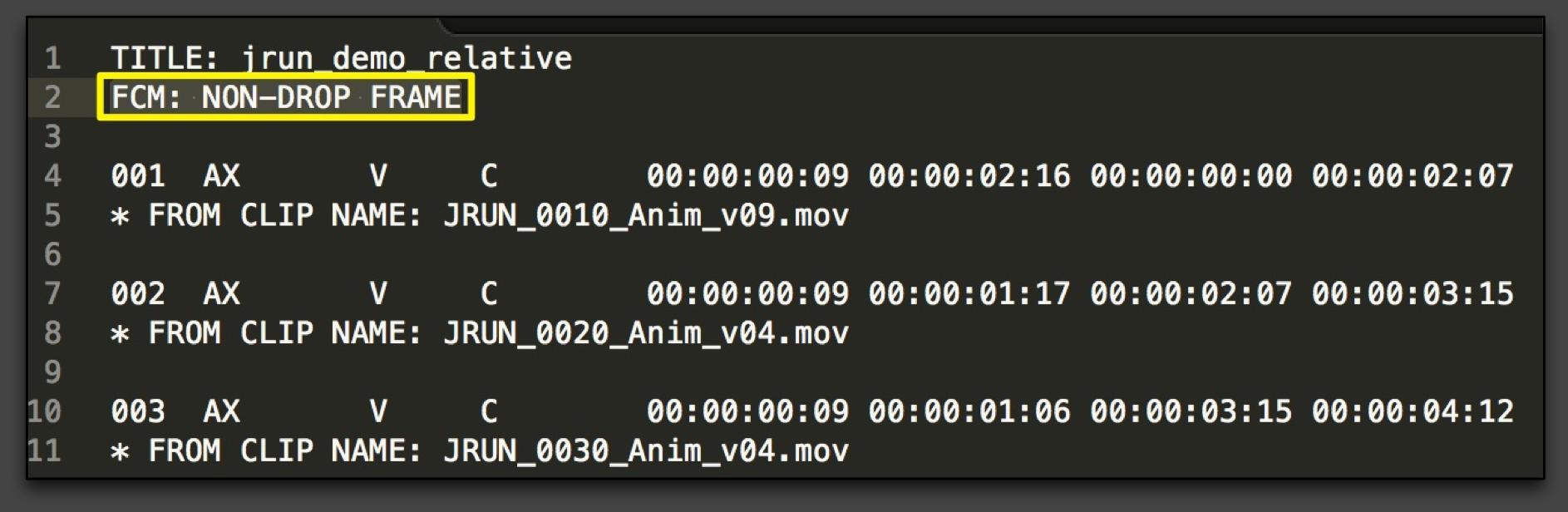

  • Frame Code Mode (FCM): NON-DROP FRAME
    Note:
    Flow Production Tracking only supports NON-DROP FRAME (exact frame rates). A DROP-FRAME (broadcast frame rate) specification will produce an error message upon importing.
    FCM
  • Cut Items: Each line below the TITLE and FCM become a Cut item in Flow Production Tracking once imported.
    • There are four numbers specified on each Cut item:
    • The first two numbers are the timecode in point and out point of the clip name.
    • The last two numbers are the timecode for the sequence as a whole.
    • Clip Name: FROM CLIP NAME: The Clip name corresponds with the Version name in Flow Production Tracking. For more information on how this works, see Associating EDL Events with Shots.

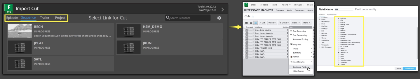

Step 4: Then, we prepare our Sequence in Hyperspace Madness (or something that you can link your Cut to).
  • The top bar shows what you can link your Cuts to. This is based on your field configuration on Cuts ( Cuts > Link field ).

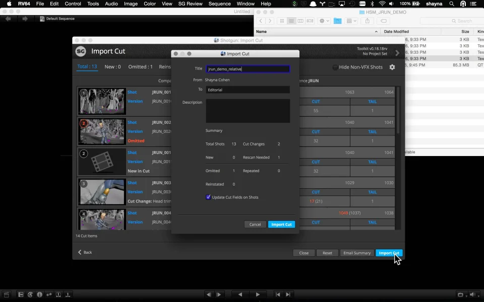

Step 5: We select Import Cut and we are brought to the Import Cut submission dialog displays. This is where we make updates to the following fields that will appear in Flow Production Tracking on our Cut.
  • Title: derived from the TITLE in the EDL (as mentioned in EDL basics).
  • From (non-editable): the user who is importing the Cut will be specified here.
  • To: choose to send these details to a Group in Flow Production Tracking (only groups are supported). Upon importing, a note will be created in Flow Production Tracking and addressed to this Group.
    Group
  • Summary (non-editable):
    • Total Shots
    • New
    • Omitted
    • Reinstated
    • Cut Changes
    • Rescan Needed
    • Repeated. When Shots appear in the Cut more than once, the Import Cut Tool detects each appearance and sets the Cut fields on the Shot accordingly. The app sets Cut In to the earliest frame value from any of the Shot’s appearances in the input EDL and sets Cut Out to the latest frame value from any of the Shot’s appearances. This results in a frame range that ensures coverage for all appearances of the Shot in the Cut.
Note:
You can select Update Cut fields on Shot. This takes all of the information you're importing in the Cut and also applies it to your Shots. This is great if you're importing all Shots in a Sequence. However, if you are importing a Trailer Cut, make sure this box is unchecked since you want to avoid affecting your Shot Cut information (Cut In, Cut Out, Head In, Tail Out) when importing this trailer Cut.
Step 6: Here, we select Import Cut, and see a progress bar and that’s it! We will see a Cut Imported screen when our Cut has been imported successfully. We select View in Flow Production Tracking so that we are taken to the Cut in the Media App.

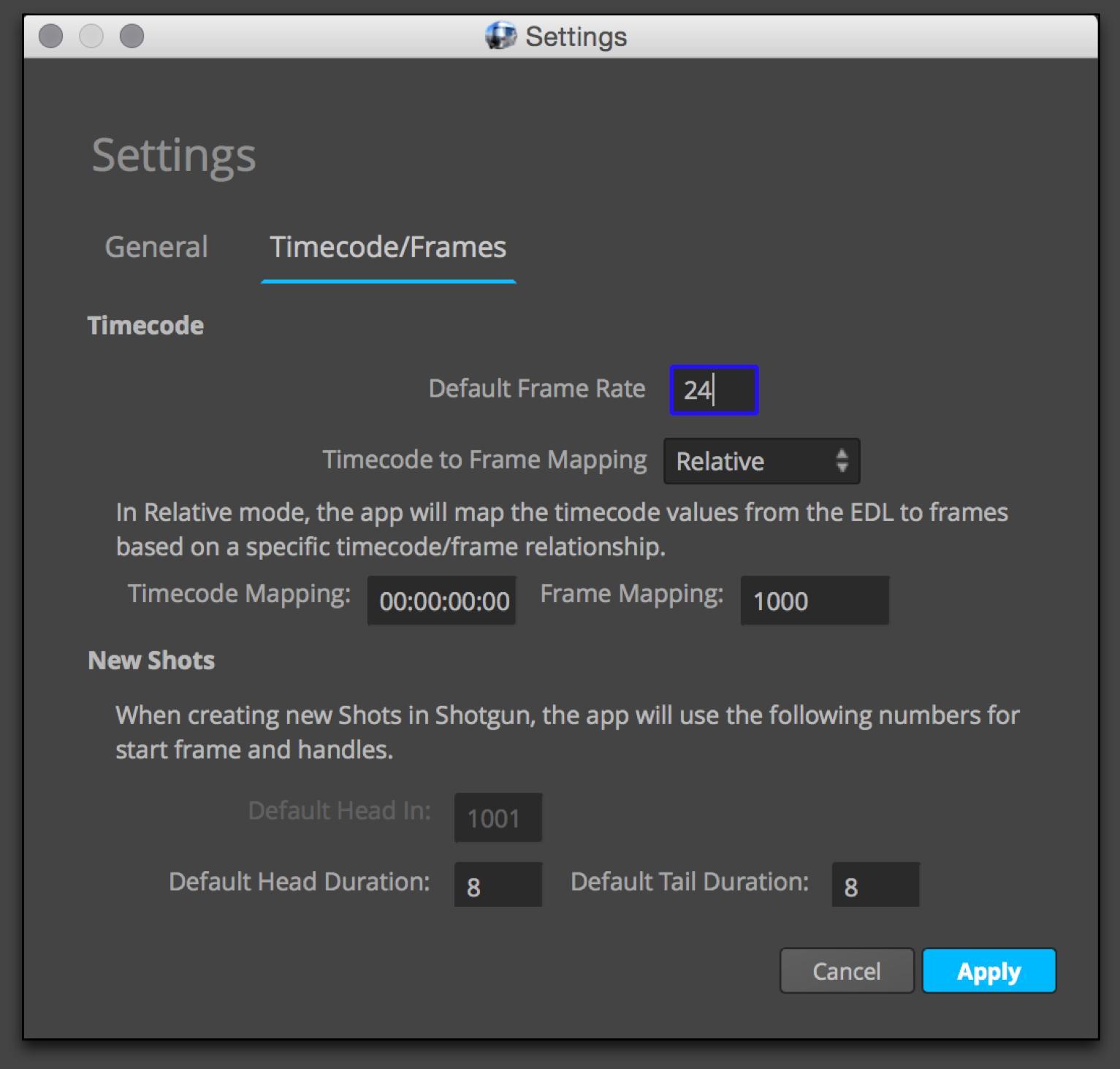

You can reach the Import Cut Tool Settings via the gear menu to the upper right of the App. There are two categories: General and Timecode/Frames.
Timecode frame settings
General settings
To adjust General Settings in the Import Cut Tool, check out Import Cut Tool In-Depth - Updating Shot Information.
Timecode/Frames settings
Default frame rate
Timecode
  • Default Frame Rate: you can set your default frame rate for which the material you are importing will be set at.
    Timecode to frame mapping
  • Timecode to Frame Mapping:

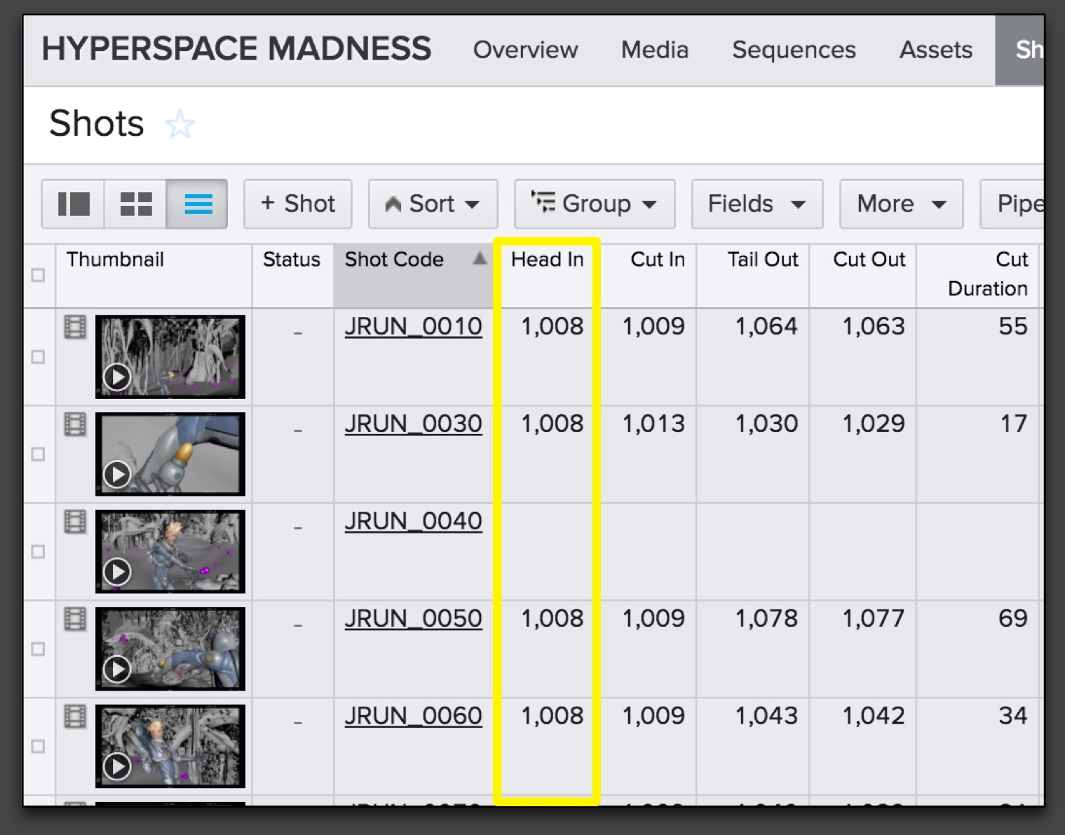

    Head in
    • Absolute Mode: the App will map the timecode values from the EDL directly as frames based on the frame rate. For example, at 24fps 00:00:01:00 = frame 24.
    • Automatic Mode: the App will map the timecode values from the EDL to the Head In value from the Shot in Flow Production Tracking. If that field is empty, the default Head In value set here for New Shots will be used. In other words, it will offset dynamically from the Head In specification for the Shot in Flow Production Tracking.
      Relative mode
    • Relative mode: the App will map the timecode values from the EDL to frames based on a specific timecode/frame relationship.
      • Timecode Mapping: specify a timecode that will map to the frame mapping.
      • Frame Mapping: this can be specified if you are offsetting your start frames. For example, a common offset is 1000—starting frames at 1000 in case there is preroll, head extensions, lining up simulations, etc.
New Shots
  • When creating new Shots in Flow Production Tracking, the app will use these numbers for start frames and handles:
    • Default Head Duration
    • Default Tail Duration
      Start frames handles

Linking to a cut
Cuts can be linked to one thing—such as a Sequence, Scene, Episode, etc. While using the Import Cut Tool, the top bar shows what you can link your Cuts to. This is based on your field configuration on Cuts (Cuts > Link field). Note that while linking to a Sequence, a Shot can only be linked to one Sequence at a time.
