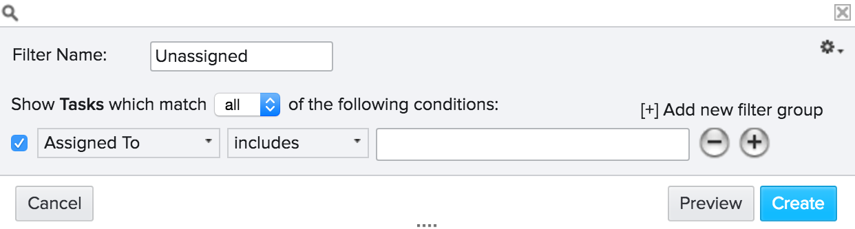

One of the most commonly used scheduling tricks is to create an “Unassigned” saved filter. This filter allows you to easily see what Tasks you’ve yet to assign out with a single click. To create an unassigned saved filter, head on over to a Tasks View/Page, click on [+ New Saved Filter], and set the conditions as below:

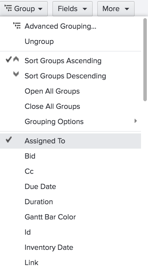

Once you’ve assigned all your Tasks, you might want to view whether you’ve balanced your assignments equally across your artists. The easiest way to do this is from—you guessed it!—the Tasks view. Simply Group your Tasks by Assigned To to display how many Tasks you assigned to each artist and from there you can decide whether they can complete this amount of work in time.

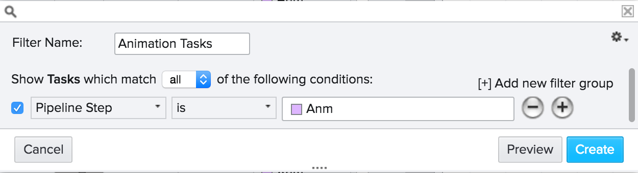

Another handy feature of the Tasks View is the ability to narrow down by department using the Filter Panel and the Pipeline Steps filters. If you’re working at a large studio, Pipeline Steps are usually closely related to departments and you may want to create a saved filter with just the department relevant to your teams. That way you can toggle between all Tasks and how they influence each other, and Tasks just relevant to you.

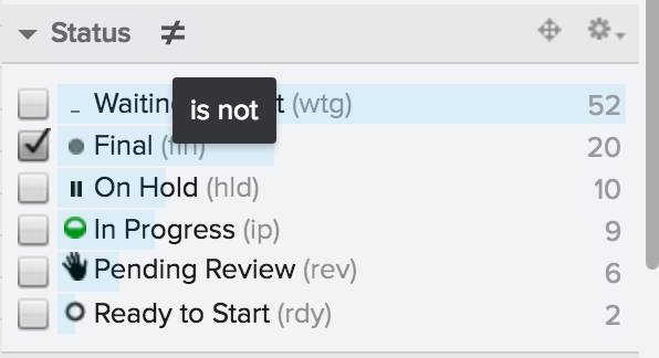

As production ramps up, it will be important to narrow down to specific Tasks to see how your teams are tracking. This is when the Filter Panel comes into play. Here you can filter to display Tasks that are a specific status, or click next to the Field condition name to toggle on the is not filter. The is not filter will allow you to display Tasks that are not a specific status, such as final/complete, without having to manually check on all the other filter conditions.
When using the Filter Panel, hold down the Command/Windows key to multi-select filter conditions, without the page updating, until you release the Command/Windows key.

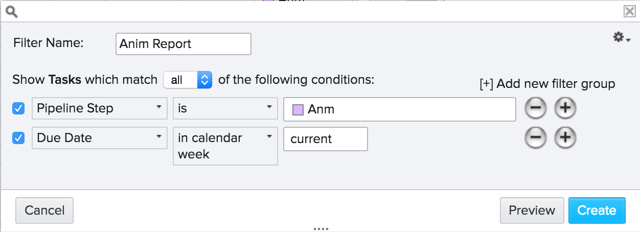

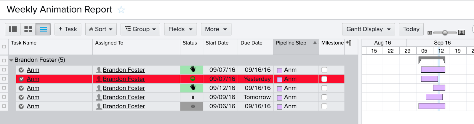

A Project’s production is rarely a solo effort, and as a coordinator or manager, you’ll often be asked to present a report on how your teams are tracking. A report in Flow Production Tracking is a page with applied filters, color formatting, and field layouts. Let’s say you want to create an Anim Department report for any Tasks due this week. You would create the saved filter as below:
Because you used the dynamic filter token of “current week”, you won’t need to manually recreate this report each week as it will dynamically update as the data changes—another benefit to using Flow Production Tracking and its live data!

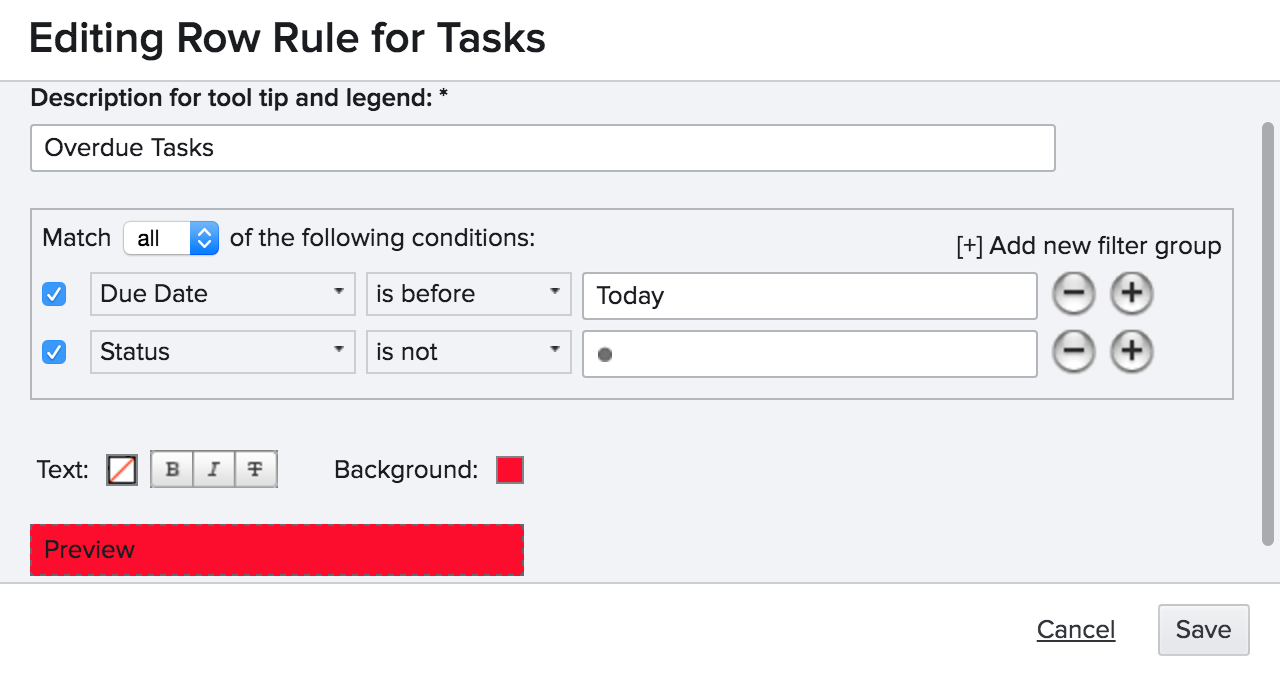

Color formatting
You might also want to highlight Tasks that are overdue in a report. To do this, you can create a new formatting rule for Tasks that were due before the current date (again using the dynamic token so you don’t need to manually update this report) where the status is not complete/final.

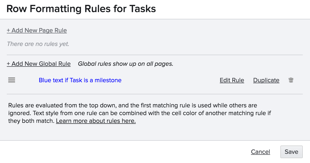

Step 1
Step 2
Select either a New Page rule or Global Rule.
Step 3
Once you’re happy with the report, you can click on the Page Icon > Save Page As and name the new Page “Weekly Anim Department report”. You can then access this page whenever you need to, without having to recreate the page or reset filters due to the dynamic tokens.
