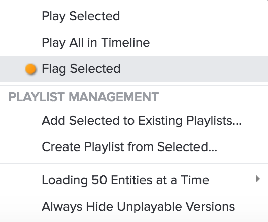

In dailies your VFX supervisor regularly wants to compare the current FX work to the original plate. No problem! You've gone in ahead of time and flagged the original Version plate for each Shot. This can be accomplished in either Flow Production Tracking by exposing the flagged field on a Version page or within Screening Room by right clicking the Version in the Canvas Timeline and clicking "Flag Selected."
![]() Flagging via the field within Flow Production Tracking |
![]() Flagging via right-click menu within the Canvas Timeline in Screening Room |
Now that all the Versions are flagged, you're ready to begin your review in Screening Room for RV. No matter where you navigate to within your project hierarchy, you can easily access a flagged Version linked to the same Shot (or Asset) which you are currently viewing. The shortcut keys are Option+Shift+Up/Down arrow keys for Mac, and Alt+Shift+Up/Down arrow keys for Windows. This will load the next/previous flagged Version (in the event you have more than one) and the original source Version. Watch the video below to see this in action.
