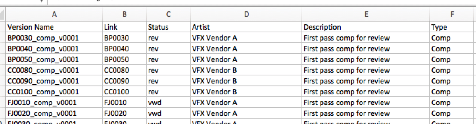

  • Vendors should prepare a submission sheet for each submission batch, with column headings corresponding to column headings in your system for Versions.

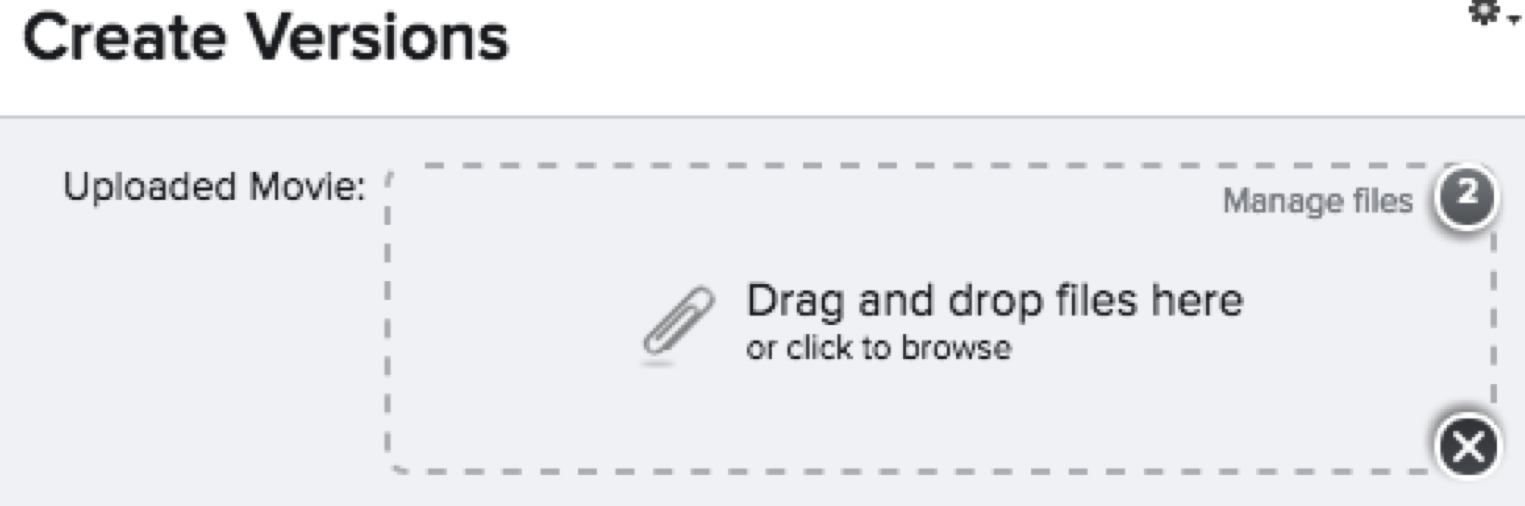

Once the Playlist has been created, from the Playlist’s detail page, the vendor should switch to the Versions tab, click +Version, drag media for the submission onto the Uploaded Movie drop area, and then click Create Version (the other fields can be ignored for now).

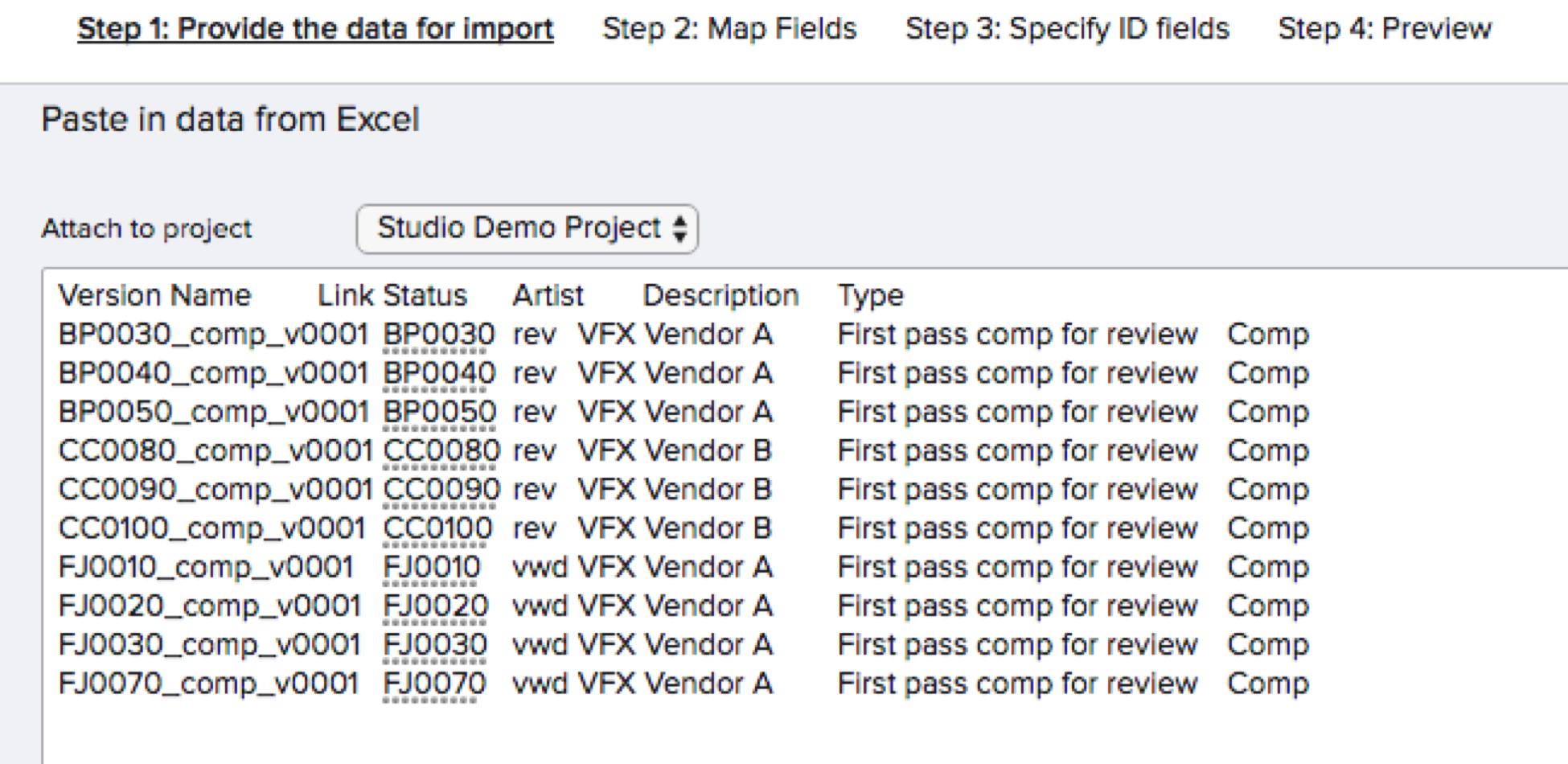

After the upload completes, the metadata can be imported from a submission sheet by choosing More > Import Versions and then pasting the contents of the submission sheet.
Follow the steps to import the information (see Using the Importer for more information). The Playlist is now ready to review.
