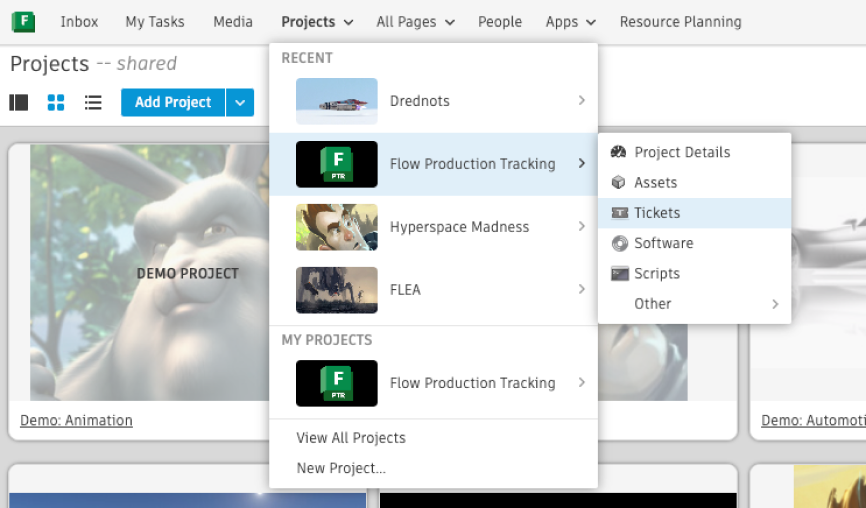

Create a Tickets page in your project
Now let’s create a Ticket page and put it inside our Flow Production Tracking project. If you decide to organize your work into multiple projects, create a Tickets page per project.
Tickets menu

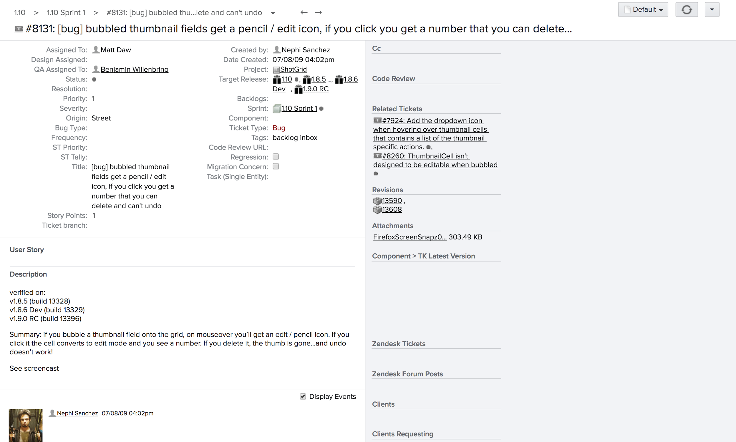

Click on a Ticket and look at its detail page to see all these fields in context of a bug ticket:
Ticket detail page
The Ticket detail page has a configurable header and side panel, and a threaded reply section where you can turn events on or off. Above we see the first event, where Nephi Sanchez created the ticket.
One feature of Tickets is that if you type prefix a Ticket reference with a “#” anywhere in the description or a reply, Flow Production Tracking will automatically create an entry for that ticket in the “Related Tickets” field. The text will convert itself into a link to the ticket it references, show its current status, and reciprocally create a link in the referenced Ticket’s “Related Tickets” field to the current ticket:
Related tickets

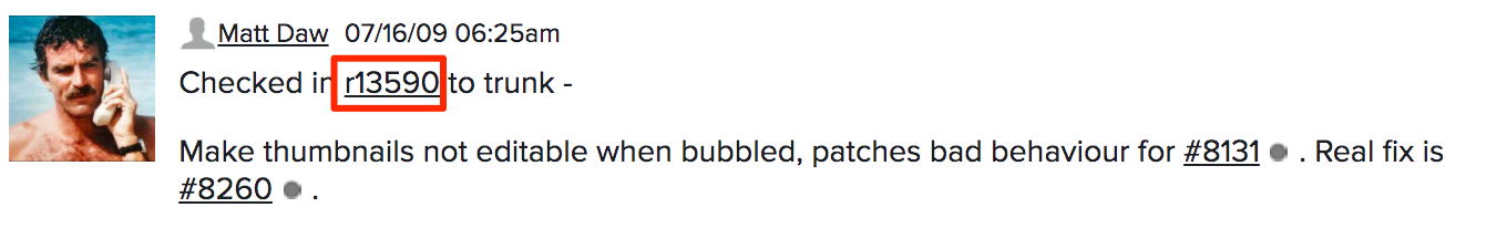

Auto-linking Revisions to Tickets
Similar to auto-linking related Tickets, adding a lowercase “r” in front of a Revision will automatically convert that text to a link, and create an entry in the “Revisions” field:
Revisions

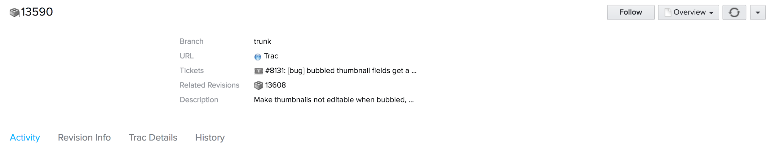

In Ticket #8131 we see two code revisions that were checked in by the developers. Let’s click on one of them to take a closer look:
Revision detail

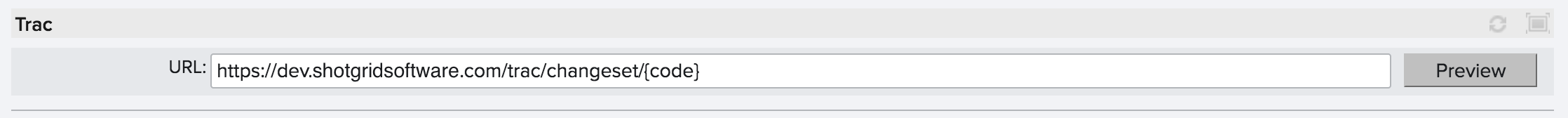

Our Revision detail page shows some metadata in a configurable header. We also have a tab that has been integrated with Trac, our web-interface that we use with Subversion. To accomplish this integration, we wrote a simple script using Flow Production Tracking’s API to make the check-in process trigger the creation of a Revision in Flow Production Tracking and update all relevant metadata.
The tab called “Trac Details” receives the Revision number (“code”) as an argument so that we can access Trac from within our Revision detail page. Here’s what the tab’s configuration looks like:
Tab configuration
