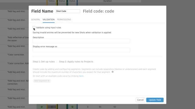

To enable an input validation rule on a field:

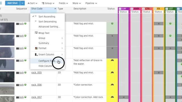

  • Right-click on the field header
  • Configure field
  • Select the VALIDATION tab
Note:
When creating a field for the first time, you will need to complete the GENERAL tab prior to selecting the VALIDATION tab.

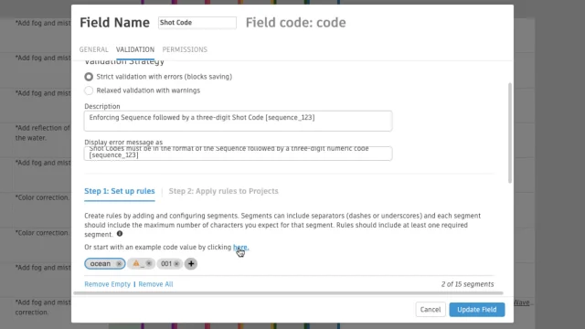

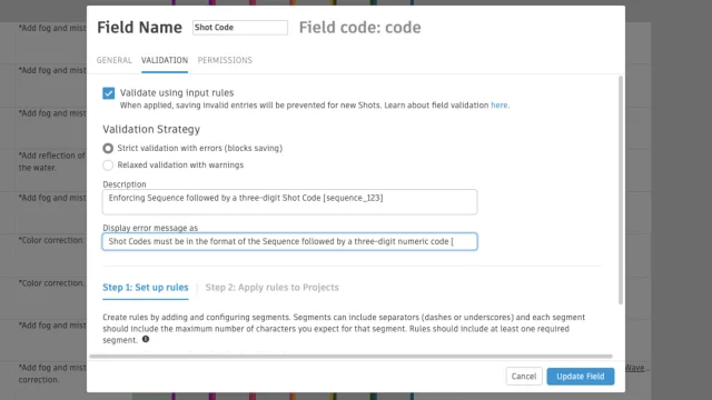

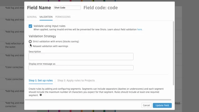

Then, enable Validate using input rules. When enabled, saving invalid entries will be prevented for new Shots when a strict validation rule is applied.
Validation Strategy
Strict Validation
Strict validation will prevent the input of data and will present users with an error message upon creating a violation.
Strict Error
Relaxed Validation
Relaxed validation will present a warning upon inputting data with violations to the rule, but users can continue to input data.
Relaxed Error
Adding a Description
Adding a Description to the validation offers a way to convey important information in a digestible way to Administrators maintaining the validation rule. Adding a description is required to create the rule.

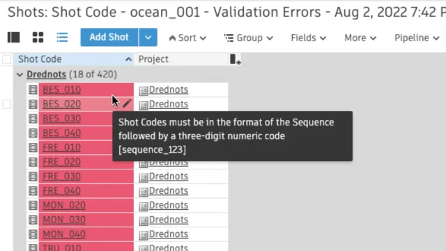

Displaying error message as
The Display error message as value will be the message users see upon hovering over a record when there is a validation rule violation with strict rules or warning with relaxed rules.

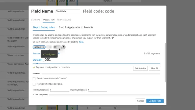

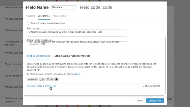

Step 1: Set up rules

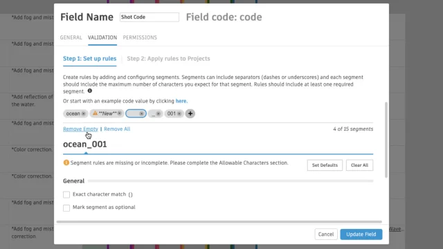

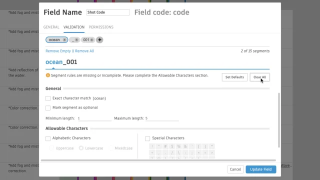

Segments
You can create input validation rules by adding and configuring segments. Segments can include separators (dashes or underscores) and each segment should include the maximum number of characters you expect for that segment.
You can also choose to start with an example segment code value which is inherited from your data.
As you add additional segments, you can preview your changes below them.
Validation Rule Segments
Additional functionality with validation rule segments includes support for:
  • Clicking and dragging the segments to a preferred position
  • Remove Empty: removes any empty segments
  • Remove All: removes all segments
  • Set Defaults: will reset your General and Allow Character settings defaults
  • Clear All: will clear all General and Allow Character setting configurations and you can start fresh

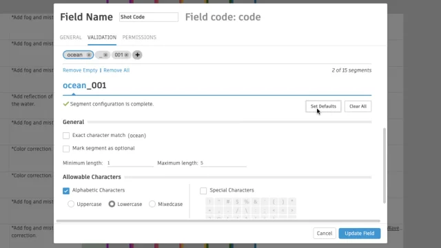

General Settings

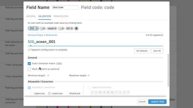

  • Exact character match:
    • When a segment is selected, you can indicate if it should be an exact character match requirement
    • When enabled, the characters must be an exact match when creating a record, and be limited to the option chosen in the allow section (in the example below, that's SIG for the first segment)
    • When turned off, the characters can vary
    Example: this can be helpful in cases where you would like a fixed value in a naming convention, like starting with a Project name for a segment.
  • Mark segment as optional:
    • When optional, creating records without the segment will be possible and will not cause an error.
      Segment Optional
  • Setting Minimum and Maximum Lengths
    • You can set the minimum and maximum length accepted for each segment.

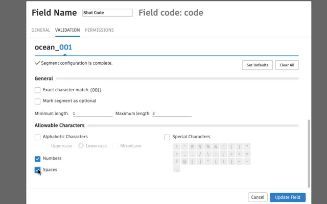

Allow Character Settings
  • When Exact character match is inactive, you can choose to allow:
  • Specified Alphabetic Characters, Numbers, and Spaces
  • Special character segments to include specified special characters (eg. !"#$%&'()*+,-./:;<=>?@[\]^‘{|}~)
Notes about Spaces:
  • When Spaces are enabled, they will contribute to the character length specified for the segment
  • Leading and trailing spaces will be removed in the input before validation rules are applied

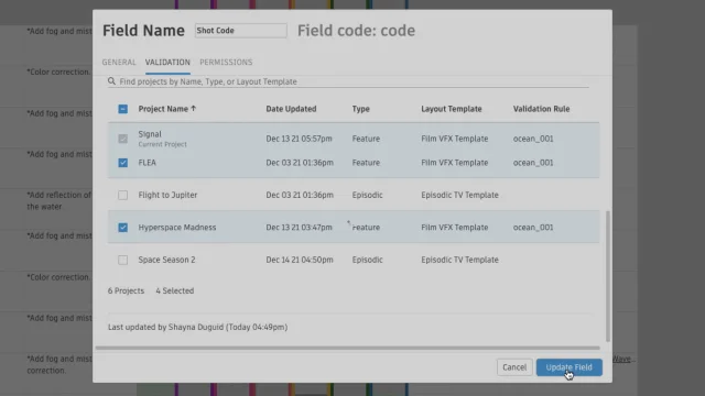

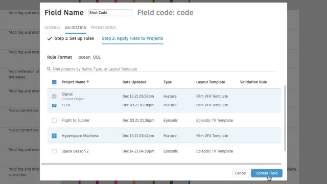

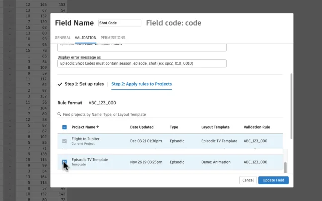

Step 2: Apply rules to Projects
Once you are ready to apply your rule to the field on Projects, select Step 2: Apply rules to Projects. By default, the current Project is automatically selected, but if you would like to select additional projects, then proceed to Step 2.
Here, you can select which Projects you'd like to apply the rule to—and you can always revisit and update these Projects later.
To apply the validation rule, select Update Field.
Then, you'll be prompted with the following message:
Update Field

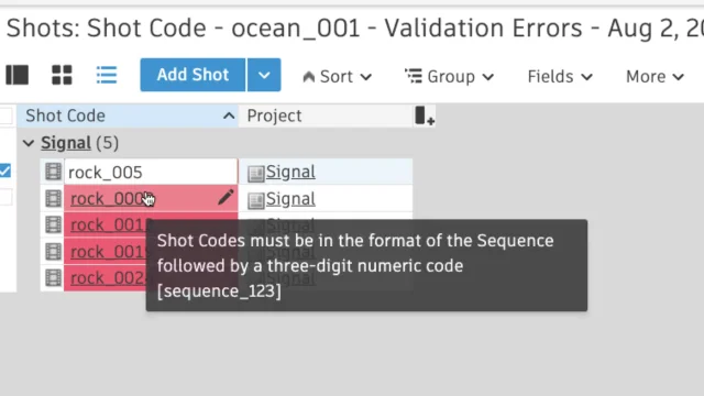

Creating a Page with Errors
After applying the rule, you will be given the option to create a page with errors that will open in a new browser tab.
You can resolve any errors by editing the records on this Page.
Once the Page is created, it will be available in your Pages dropdown in case you need to revisit it later:
Pages Dropdown

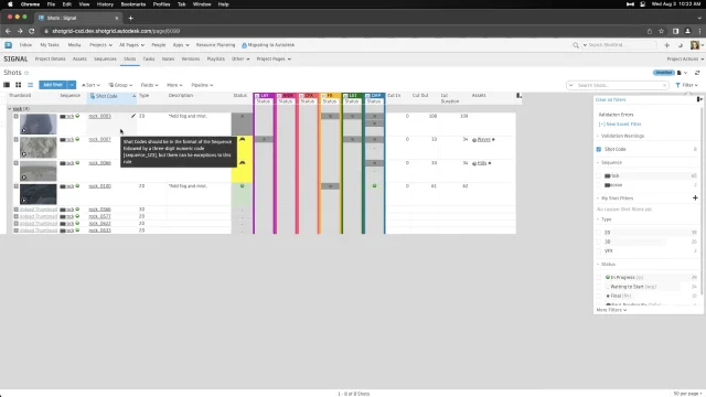

You can also filter errors (with strict rules) and warnings (with relaxed rules) on an entity page.

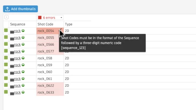

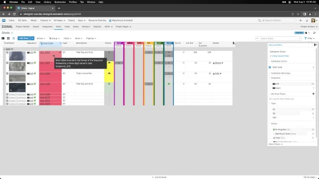

Creating records with Validation Rule errors
After a strict validation rule is applied to a field, you will be prevented from creating a record that violates the rule. When a relaxed validation rule is applied to a field, users will be presented with a warning and can continue to create the record.
Creation Violation

Filtering for errors and warnings
Using the filter panel
Filter Widget
Strict Rules
You can use filter widgets to filter records that have validation errors. From the filter panel, add a filter widget for Validation Errors. Then, select the field in the filter widget to show the records with the errors.
Relaxed Rules
Likewise, you can use filter widgets to filter records that have validation warnings. From the filter panel, add a filter widget for Validation Warnings. Then, select the field in the filter widget to show the records with the warnings.

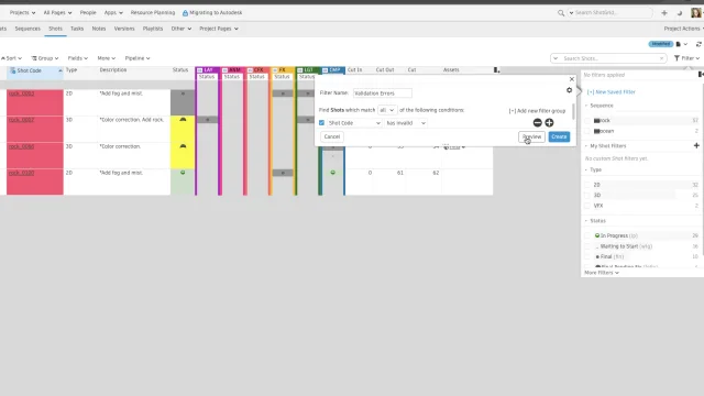

Applying Page filters
You can filter for strict validation rule errors and relaxed validation rule warnings using Page filters with the following criteria:
  • Field Name has invalid entries, or
  • Field Name does not have invalid entries
Note:
Relaxed validation rules are filterable using the same filter, but the records containing warnings are not highlighted red. You can simply hover over the record to see the warning. Relaxed Warnings
