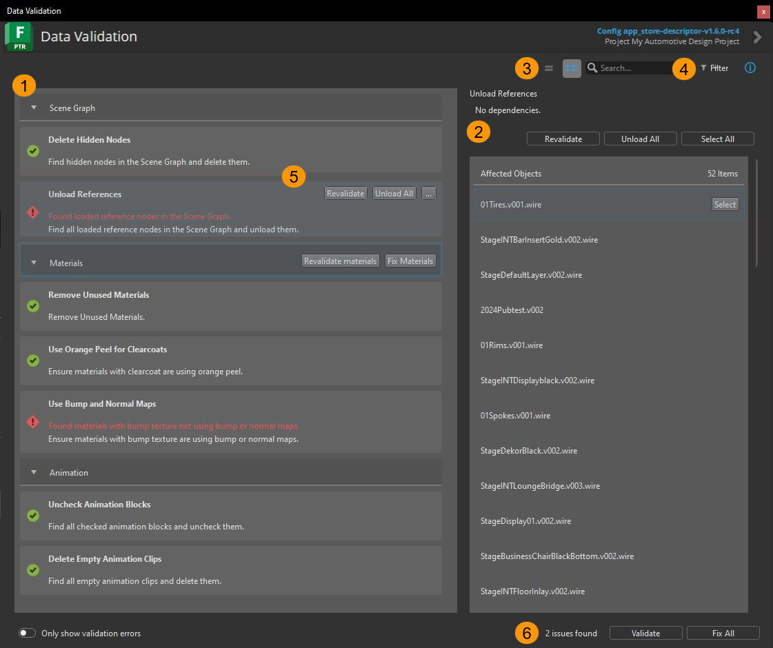

By default, the Data Validation tool opens in Group View mode, displaying the validation check descriptions in the left panel, and Details Panel open on the right.
1 Displays validation check descriptions and results.
2 Details Panel - Displays information about the validation checks. Toggle the Details Panel display on and off by clicking Details Panel Information icon.
3 View modes - Choose between the following View modes:
  • Group View icon Group View - Displays the validation check descriptions and results grouped by data type: Layers, Shaders, and Modeling.
  • Compact List View icon Compact List View - Displays the name of the validate checks in a list. Roll over each item to display validation check descriptions and results.
4 Filter - Provides options for filtering check description and results by data type.
5 Validate By Single Check - Runs a validation check on the selected criteria. Fix invalid data for the criteria by selecting the appropriate option: Delete All, Turn Off All, Reset All, or Expand All. These options also appear in the Details Panel when a validation check item is selected.
6 Validate and Fix All - Runs a validation check for all criteria. Fix All resolves all invalid data.
7 Displays configuration details for the tool.

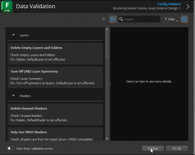

  1. Access the Data Validation tool by selecting Flow Production Tracking > Data Validation. The Data Validation tool opens.
  2. To run a validation checks on all items, click Validate. The tool returns the results of the validation checks:
    • Items displaying green checkmarks indicate valid data.
    • Items displaying red caution icons indicate invalid data.

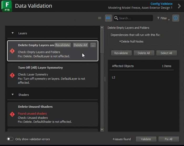

  3. Investigate the validation check results by doing the following:
    • Enable Only show validation errors to display only the items with invalid data.
    • Select each item to display information about the validation check in the Details Panel.
    • To resolve all data validation issues, click Fix All.
      Resolving issues workflow
    Note:
    You can also choose to resolve or investigate issues individually by selecting them (see step 4).
  4. To investigate issues individually, you can do the following:
    • Click More icon and choose Select All to pick the affected objects in VRED.
    • For additional information, click Affected Objects in the Details pane.
      Affected Objects indicator
    • Click the item's fix option, such as Turn Off All, to resolve the issue.
